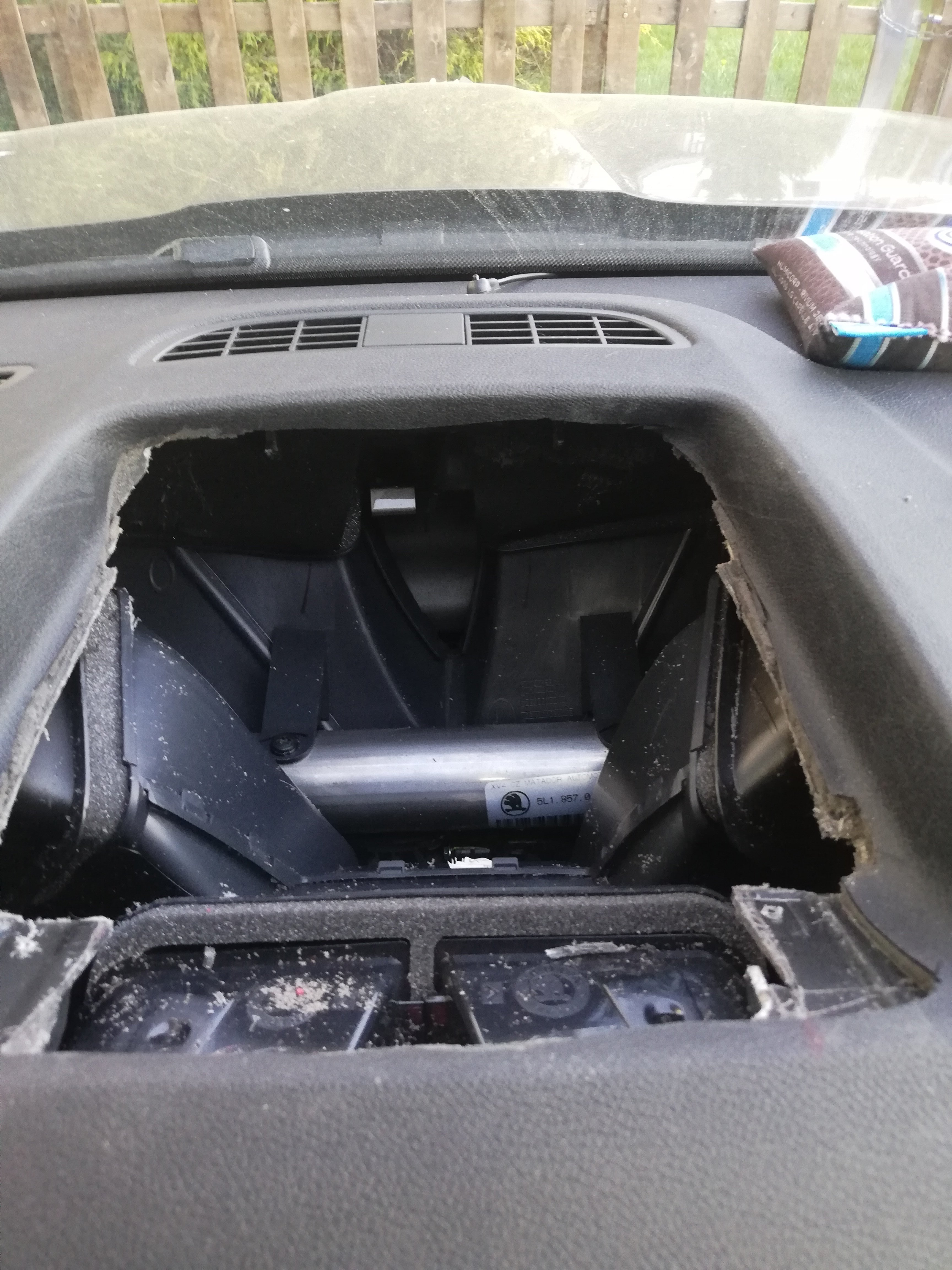

It's a while ago since I did it but it's my recollection that I used a Stanley knife - making very shallow cuts each time. The cutting was all through the same material, there being no metal sheet underneath. I had been concerned about the possible presence of wires in close proximity but this turned out not to be a problem. I recollect having a bit of difficulty making it sit down properly in the hole. Initially I thought it was a problem in the hinge area but it turned out to be a protrusion along the sides. Best of luck with it.
I removed a dash without the storage box & which just had the shallow depression that you have and replaced it with one that had a box fitted (had to change it because of airbag deployment) I took the time to compare the two and all that is needed is to carefully cut a hole through using the bottom of the depression as a guide, its all plastic and unless you go at it with a power jigsaw there is nothing underneath to obstruct your cut or to get damaged.

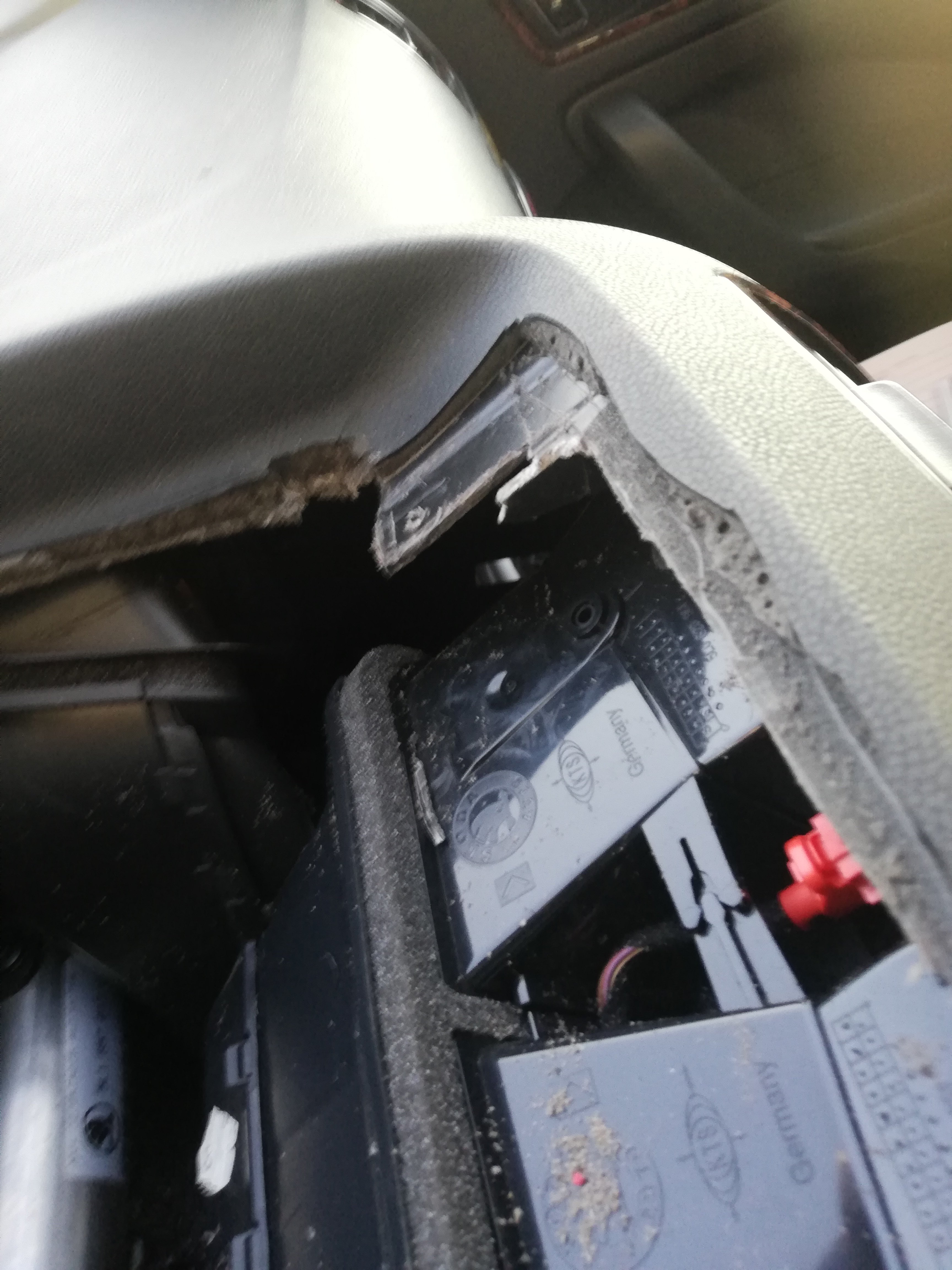

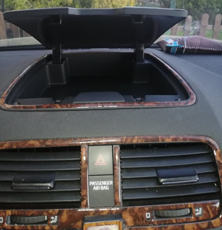

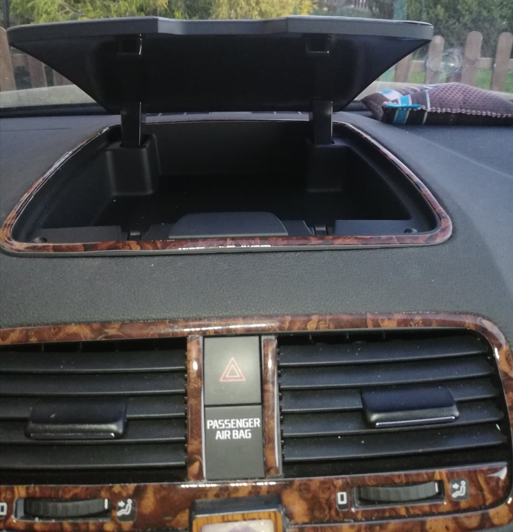

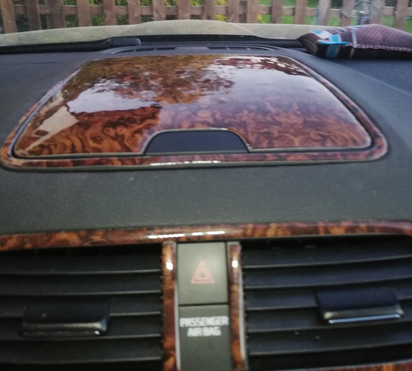

Thanks for your advice I have no completed the task I will try and put some photoes on here just incase someone else is going to try the same thing as us, I to used a Stanley knife. I have also changed the dash aperance and upgraded the original Radio, and fitted columbus RNS-510 and a Reversing camra.
Finished product
