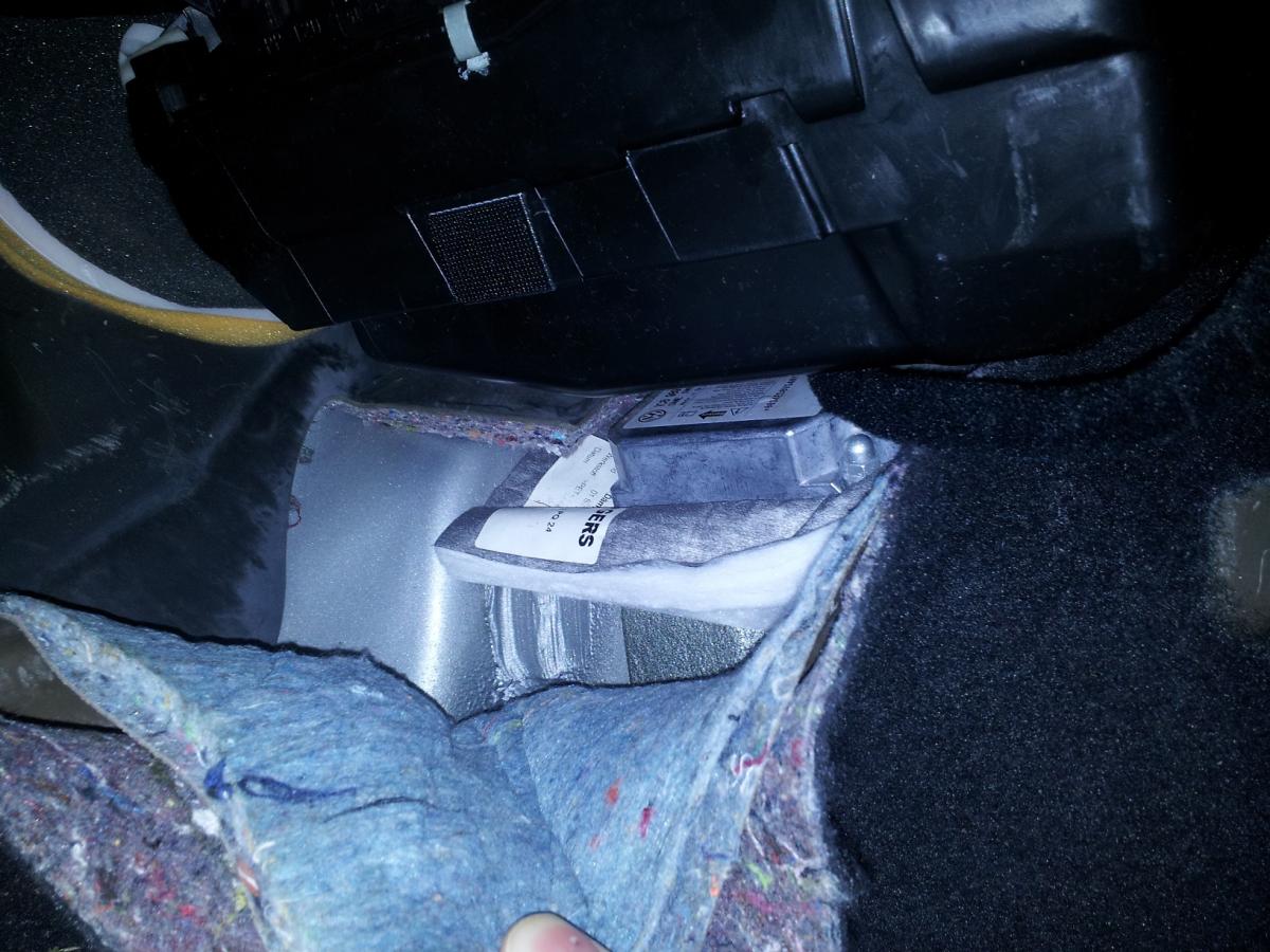

I'm gonna attempt to remove the airbag control box this weekend. He's a picture with the carpet peeled back. That enclosure has to drop at least 35mm so it can be removed.I fear that the curved bulkhead may be the next restriction. Fingers crossed.
Looks like there's enough room to remove the bolts.
Fingers crossed!
