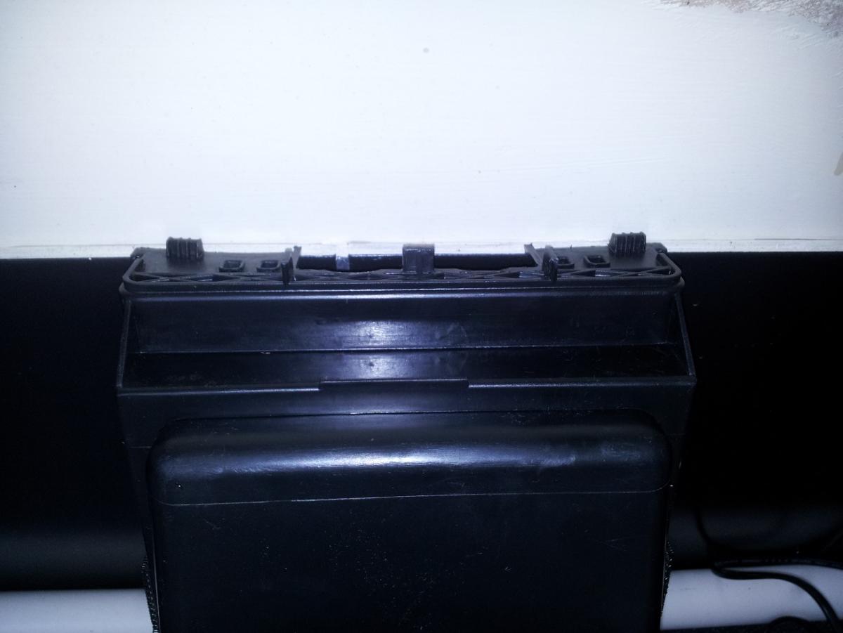

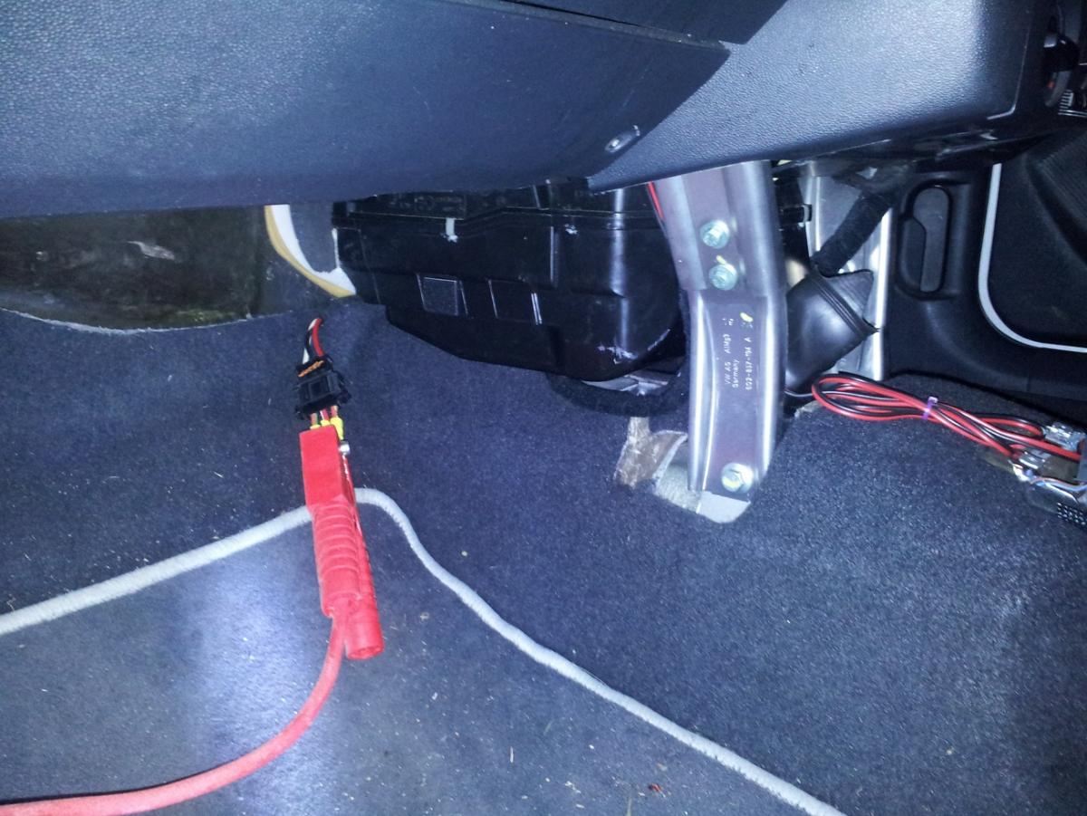

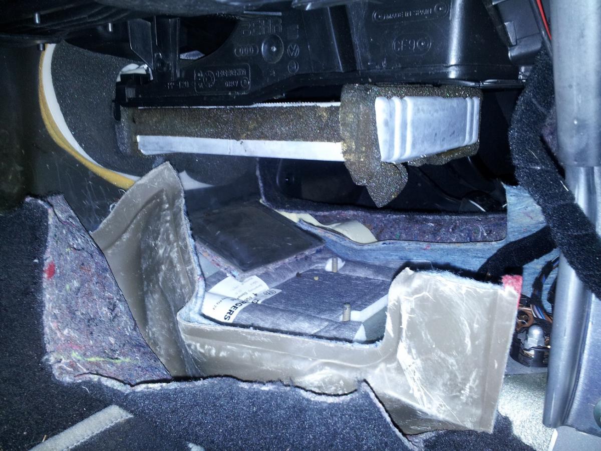

Success!! I managed to fit the PTC heater into the hot air assembly over the weekend. After unbolting the airbag ECU the lower cover just about slid out and removed. This was possible without having to disconnect the heater matrix plumbing :-) thanks DieselV6. I then had to modify the enclosure by cutting a slot using a Stanley knife. Don't do as I did and split the plastic by being careless - I had to repair it with fibreglass which was annoying to say the least! Upon fitting I connected the GND cable to E3 grounding point just in front of the gearstick. From this point I was able to power the heater using a jump lead direct from the battery and I got instant hot air! Really pleased. Now for the electrics.
A slot needs to be cut in the top to allow the PTC heater to slide in. I managed to break the enclosure when doing this and had to repair it using glass fibre.
Powering the heater using a jump lead direct from the battery. Instant hot air!

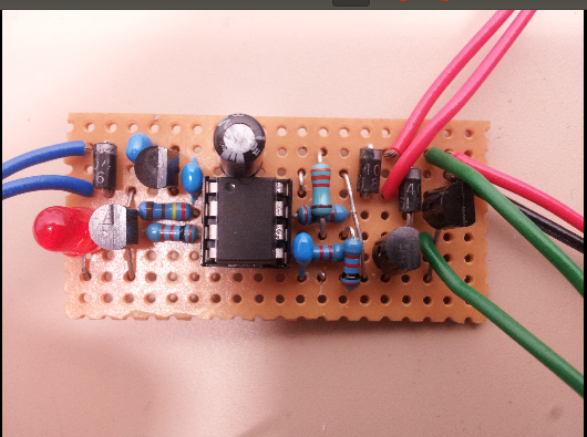

The micro code for the control board is nearly complete. We just need agreement on the switching sequence and times. This should be based on Wino's measurements.

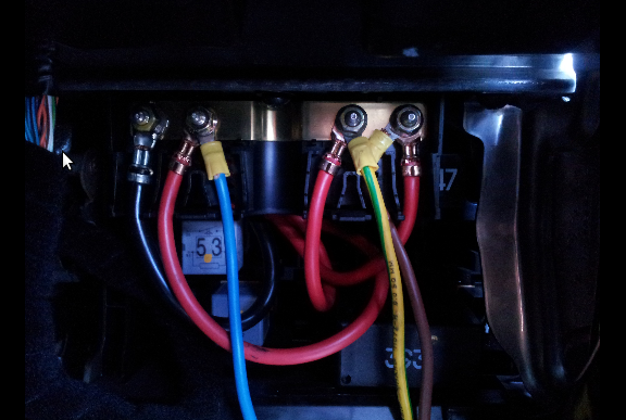

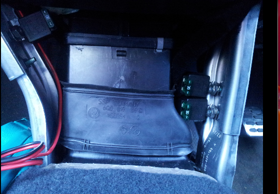

An update on this project. Wino and myself have been working in the background to make this happen. We've now successfully designed and implemented the control electronics and we are pleased to announce we now have a working auxilary heater system in a Fabia vRS! The result is instant hot air at the touch of a button on a cold and frosty morning :-)
The three elements in the auxilary heater assembly are switched using three 30A rated fused relays like the ones in the post above. These relays are controlled by the electronics which monitors the system voltage and switches the elements on and off in response. The whole shebang is controlled from the heated rear window switch for that OEM feel :-)
In the new year we will post a definitive pdf guide showing briskodians how to implement the system for themselves. For now I have some pics. The relays bolt to the chassis on the central console upright. The supply cables connect to the Terminal30 junction next to the interior fuse box - so no need to run cables into the engine bay :-)

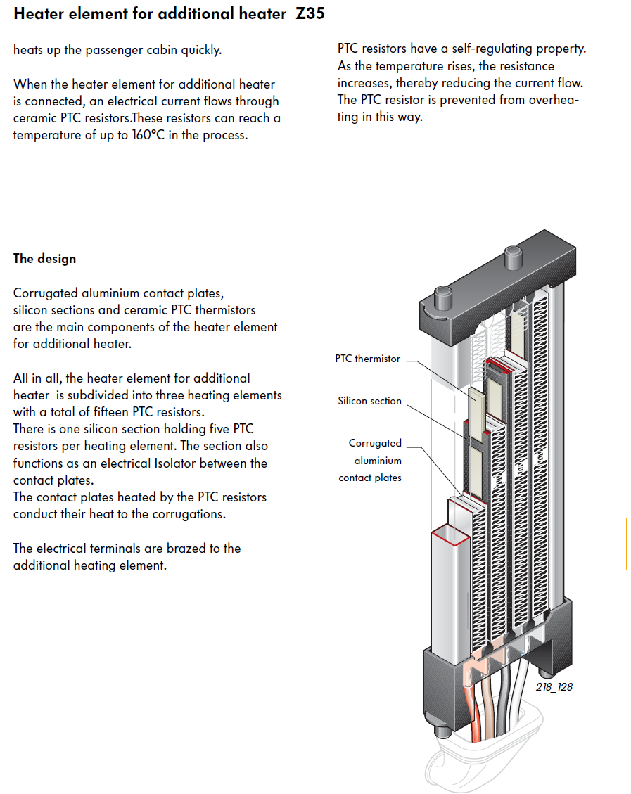

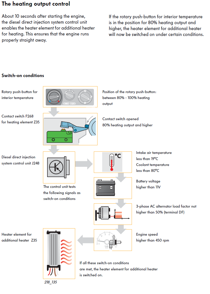

Rather late in the proceedings, I came across some useful information yesterday, after the turkey.
It's from a self-study programme (SSP218) about the Lupo 3L, but the system sounds the same as what's in a Fabia when it's factory installed.  Some technical details that I didn't know before, and may be useful.  I've made one correction, on the last page, where a sentence makes much more sense ending with the word "on" instead of "off".  Here are some snapshots of the relevant pages:
PTC1.thumb.png.dc675c42cb4f90a0624f3eaeed682d9a.pngPTC2.thumb.png.d11cadfe2ef13afd21b8126ec7b8f91b.pngPTC3.png.fbabbd430b90f6a0ece73e9aa6091a45.png
I found myself wondering last night if the ECU wiring (1 input and 2 outputs) specific to this heater might be present by default in all (diesel) engine bay looms, which may provide an easier alternative to our own dedicated controller, possibly just requiring activation of the function in VCDS (plus wiring the heater  into the system via some relays and fuses).  Unfortunately, in the cold light of day when I look at partscats.info for part numbers of engine ECU looms, I see at least two different versions, one of which is referred to as being for "vehicle use in cold climates" -  the suffix AT one here. I can't help thinking that'll be the one with the necessary wires we would need already in place, and likely not the one fitted in UK Fabias unless specced at build time.  Confirmation from any diesel Fabia owner of whether they have any wires going to pins 15, 21 & 22 of connector T81a on the engine ECU would be useful in relation to this. ( I found those pin numbers relating to a 1999> SDI Fab, engine code ASY; really not sure whether they generalise to any other Fabia diesels)
Also, in connection with the references on the third page above to the alternator load factor (info the ECU gets from the DFM output of the alternator); does anyone know what form this signal takes? One reference I found to it (not specific to a Fabia) suggested it might be a simple square wave, with mark/space ratio related to alternator output level. That might be something we could work with in piggoy's circuit, to make it even more like the factory install, at the price of one more wire and a bit more thought and programming.

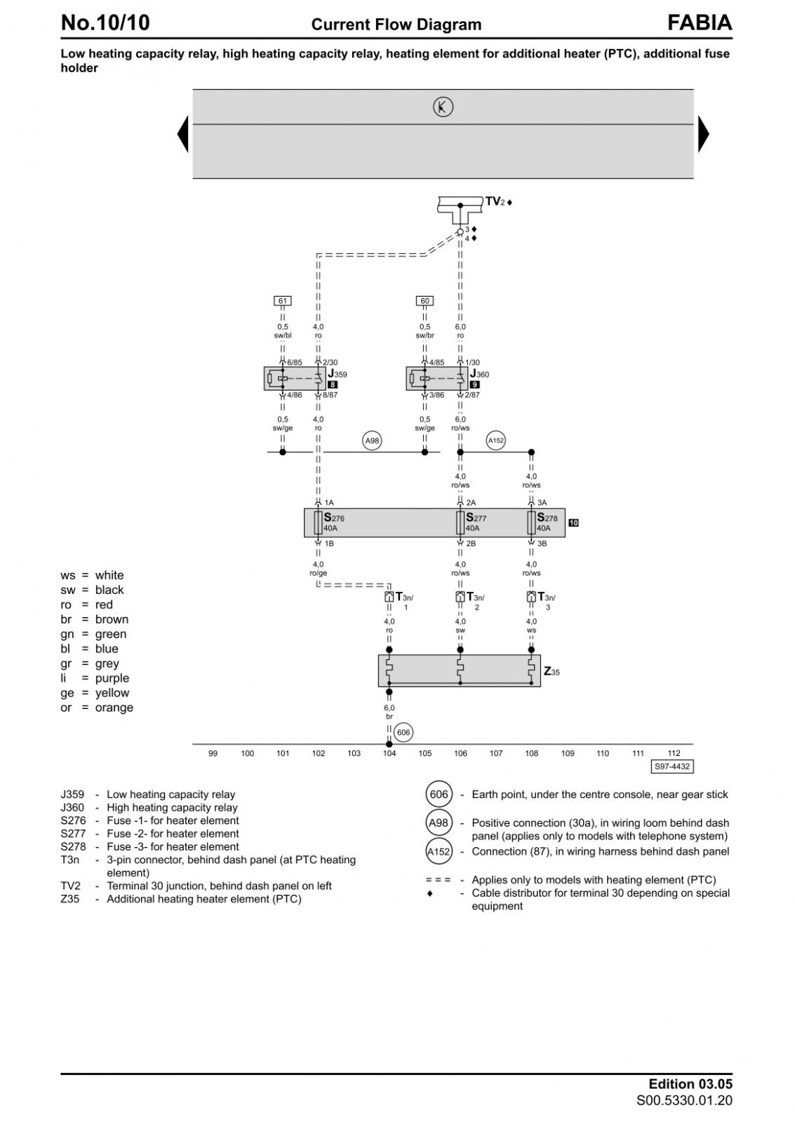

Hi Guys,

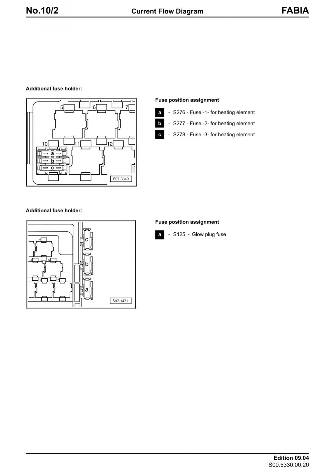

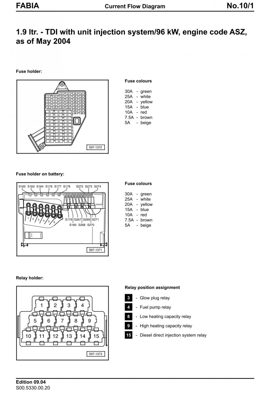

Might be a little bit late to the party with this, but have recently been thinking about this and found the current flow diagrams showing the oem setup, more for reference than anything else of course...as to be honest I prefer the idea of being able to control it using the rear window defrost button haha!
It shows relays 8 & 9 are the low and high (or preheat / staging relays) used to supply the ptc heaters.
Additionally it shows that in relay slot 10, 3 fuses (40A each) are used to protect each heater and associated cabling.
Ive not had a chance to check (and with the weather just now - unlikely to get a chance to check until the temp improves) but if relays 8 and 9, as well as the 3 fuse carrier in relay slot 10 are already installed, it might be possible to just get away with buying the ptc heater...
Has anyone had any luck and seen if relays 8 and 9 are there? And if 3 slots for 3 fuses are in relay slot 10?
Also, link to the place where I found the current flow diagrams and lots more - http://www.mediafire.com/?32vct1hmvx1rz
Taken from this thread - http://www.briskoda.net/forums/topic/117337-excellent-free-service-manuals/
