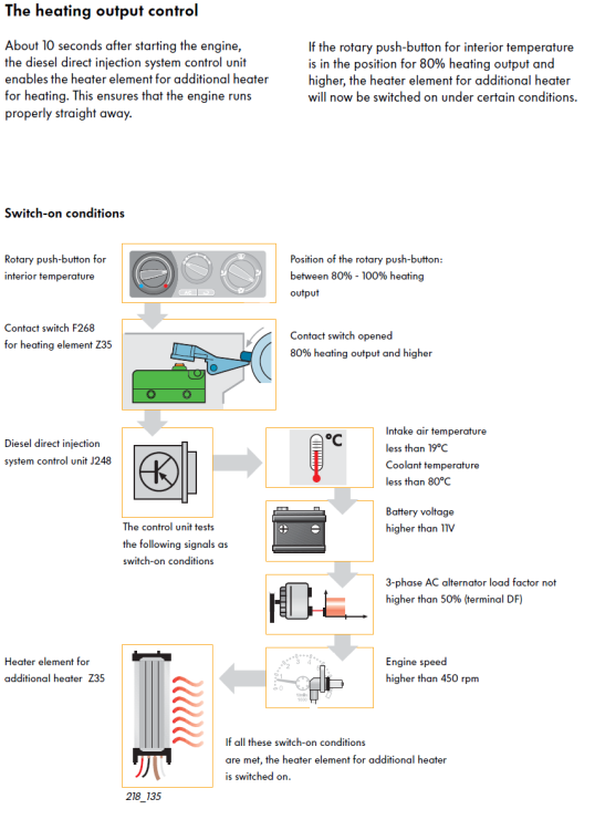

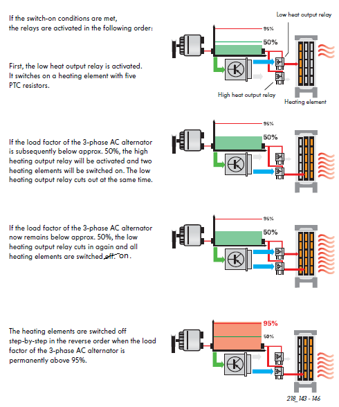

It shows relays 8 & 9 are the low and high (or preheat / staging relays) used to supply the ptc heaters.

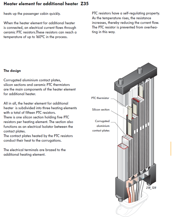

Additionally it shows that in relay slot 10, 3 fuses (40A each) are used to protect each heater and associated cabling.

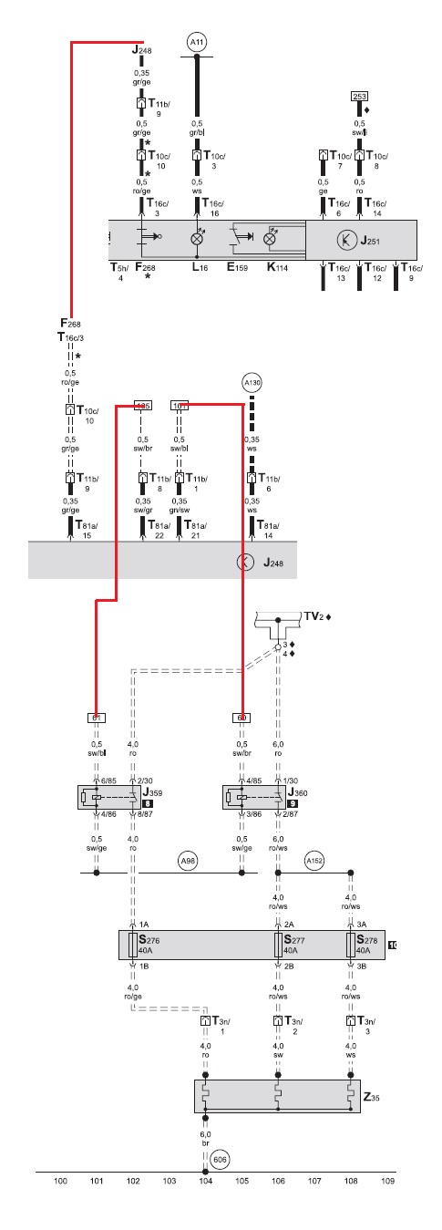

From the current flow diagrams, it shows that the relays connect to points 60 and 61...
...had a quick look through earlier and couldn't find it...but if those points could be found then a full on OEM style solution could be done...
...subject to the coding being present on the ECU to allow it right enough...but again as before...im not sure how likely that would be :(

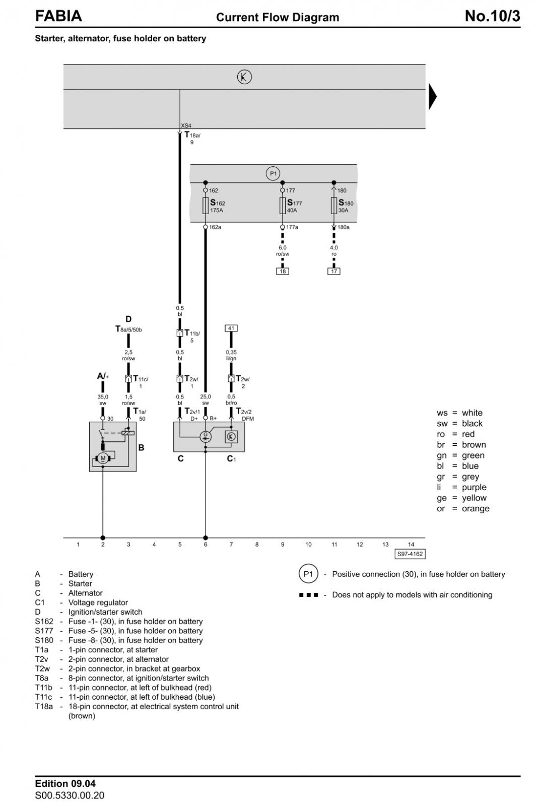

In reference to the above, have attached another diagram showing the current flow diagram for the alternator.
As Wino said, It would appear that 'D' is just a start permissive signal, with 'DFM' being the voltage regulator output signal.

@jacissmiling: Are those wiring diagrams from the very last link in that mediafire page, the .rar file? I daren't try to download that at work. The 'diagram flux curent' document further up the list stops in late 2002 as far as I remember, limiting its usefulness.
In your last picture, there are two wires that finish in rectangular boxes labelled 60 and 61. This means those connections continue at current tracks 60 & 61, which are the numbers along the bottom of each diagram. Can you have a look at which (ASZ) ECU pins those wires go to, on the page that has current tracks 60 & 61 on it, please?
It  would be nice to have someone eyeball their ECU wiring to see if the wires for this heater are even in that loom, as per my comments in post 99 above.

Oh, forgot to mention: DFM is a 5V 150Hz square wave, with on-time inversely proportional to alternator load, I found the other day on my Polo that is wired the same. Could be useful. I'm also pretty sure that this tells the ECU what's happening, rather than it being a signal from ECU to alternator, telling it what to do.
The voltage regulator (alone) is what governs the alternator's current output.

The above seems to fit nicely with what you found Wino with your Polo.  ECU then just looks at this signal and can infer the load factor of the alternator.
Thought 150Hz was a bit low for a switching frequency...but that said the required output of the alternator is DC...so I don't suppose AC generated power quality actually matters so long as the alternator holds its output at a reasonably clean 14.5V(DC) (or whatever the nominal voltage of the car is).

Yep, I found a much clearer picture of DFM versus load level somewhere, and I think I have it saved on a computer at home somewhere. It's basically the case that the field winding is powered by a FET(?) that switches on when its input is low, and off when its input is high; leading to that inverse relationship I observed. DFM is just the ECU looking at this control signal within the voltage regulator.
I think the battery acts like a huge capacitor to smooth the alternator output.

Back on topic though, did some more digging through the current flow diagrams, not sure how I kept missing it this afternoon but found the full current path now :)
Have attached a rough sketch (via paint) from the current flow diagrams.  Matches the links you provided in post #99, with the F268 switch essentially being the start of the chain.
Once that switch is closed and the other conditions (monitored by J248 - engine speed, alternator load, coolant temp and external temp) are all met, then the far side of the relays see 0V and they close allowing power to the ptc heaters.
The wiring between each 'shouldnt' be too taxing...BUT...im not sure if the ECU will allow such without some coding mods...
'shouldnt' as anyone who has ever looked im sure will agree that trying to start wiring up a car with mods / attachments to the original loom can at best be time consuming...and at worst mega ballache!!!
Pages (for further reference) from the current flow diagrams are: 53/22, 10/7 and 10/10.

Hello my car is that the PTC resistor.
The ECU adjusts the operation .
Water temperature must be within a certain area
Alternator load should not exceed a certain level.
And of course, the heater must be turned on and the fan also  .
If I have yet to understand correctly then the resistance would be the 2 -level , ie 700w and 1000w max power , depending on the need for the ECU determines .
I do not remember whether this all the terms which the ECU needs to know before  put that resistance to heat
