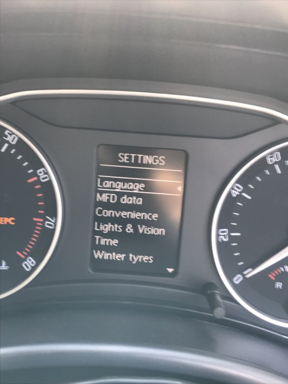

Hmm right hand buttons control the display does that mean it’s maxidot? I thought there were two types. How can I check?
Post a picture?
That's a maxidot ;-)
The more basic cluster doesn't have any menus.

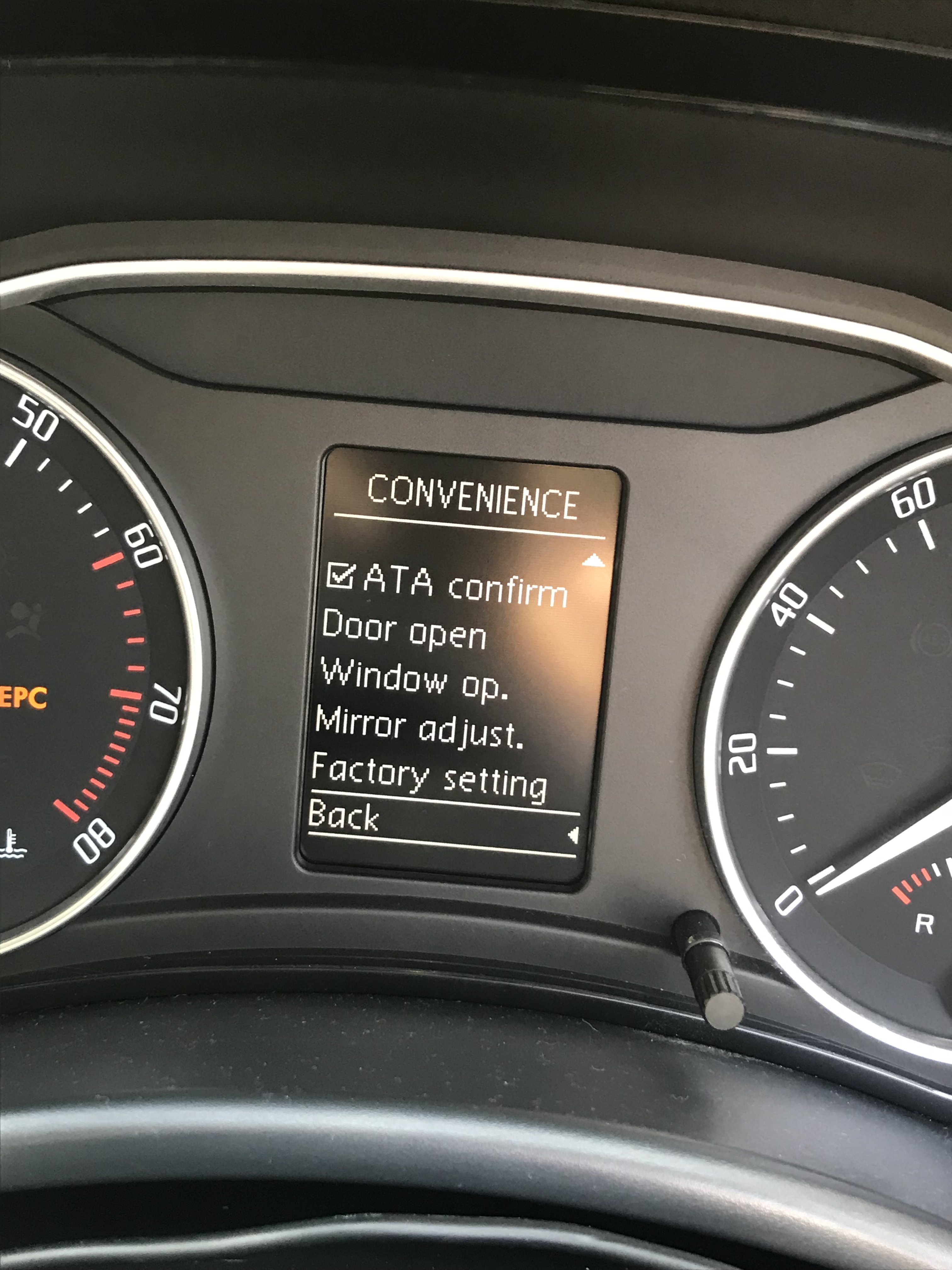

Fab thought I’d have more options will
i be able to enable them with carista or will I need vcds
That looks to be normal. What options do you think you're missing?
There is a full list in the owners manual if that helps!
Was looking to enable daytime running lights
That should show up in the 'Lights & vision' section.
Do the DRL work at all? If not, they may need activating with VCDS or similar first to show up on the maxidot.
