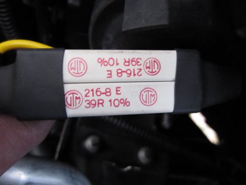

Actually there's room for the resistor inside the light cavity!

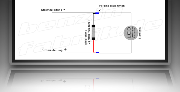

Resistor is fitted as a 'bridge' across both LED bulb wires - see attached.
Helps if you have child size hands :)

Wiring makes sense as the job of the resistor is to 'resist' to compensate for the lower resistance of the LED bulb (compared to the OE bulb).

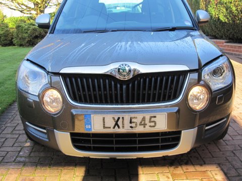

Here we go folks - all done and dusted!
Total cost for 2 sets (one has just been dispatched Special Delivery to another lucky Briskodian) was £95 all in.
Fitting took <1 hour and I used 'bullet' connectors to link in the resistors rather than 'Scotchlocks'.
It helps if you've got small hands!

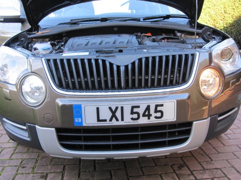

Might need to investigate an upgrade for the fog lamp bulbs, which now look decidedly 'yellow'!

If you follow the photo instructions I posted yesterday and wire according to the diagram above (you can't go wrong - there are only 2 wires!)
