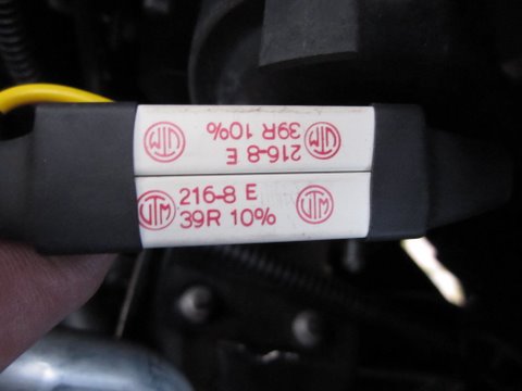

The Benzinfabrik sets that some of us have bought do work and don't produce an error warning; the downside is that they have separate resistors, which have to be wired in. The attraction of the Car Mod ones was that they were claimed to have resistors built in, but clearly not effectively enough to avoid the 'bulb out' warning
The resistors supplied with the Benzinfabrik kit are not small as the attached pic shows.
I'm very happy with the outcome - and the cost is less than replacement standard glow worms :)
