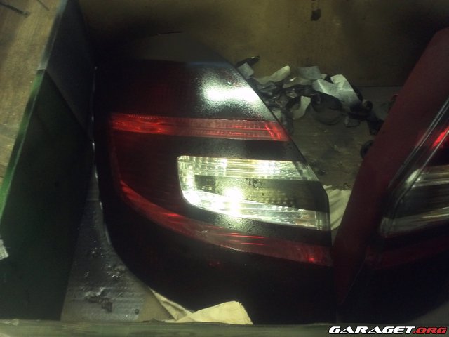

Love the rear lights- they look smart.

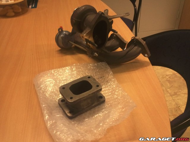

This weekend, I will have a go at the exhaust-manifold.
Going over sharp edges and smoothen them out abit, then wrap it up with heat-bandage.
Will attach the turbo to the exhaust-manifold to test that everything fits as it should!

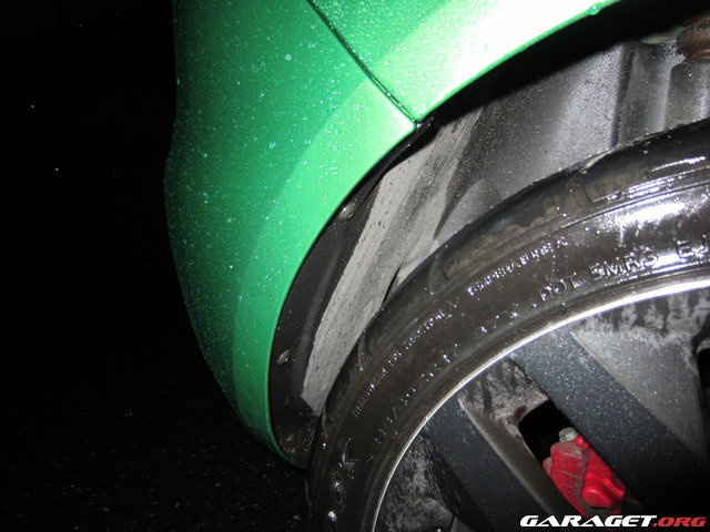

A dumbass didn't see my car when he was leaving his parking-space, turned the wheel to early and damaged both doors.
