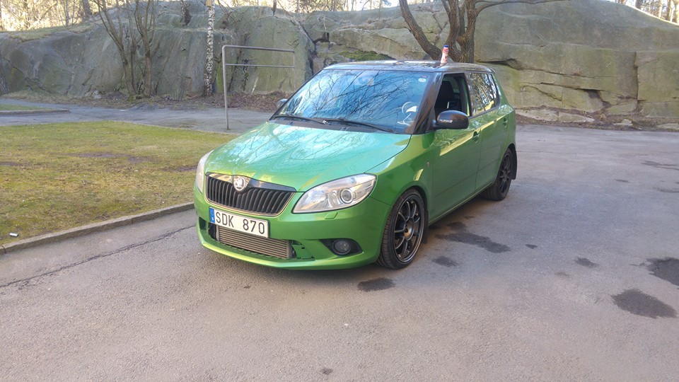

I start by sum everything up with a picture :
Yes, it's back as black and green!

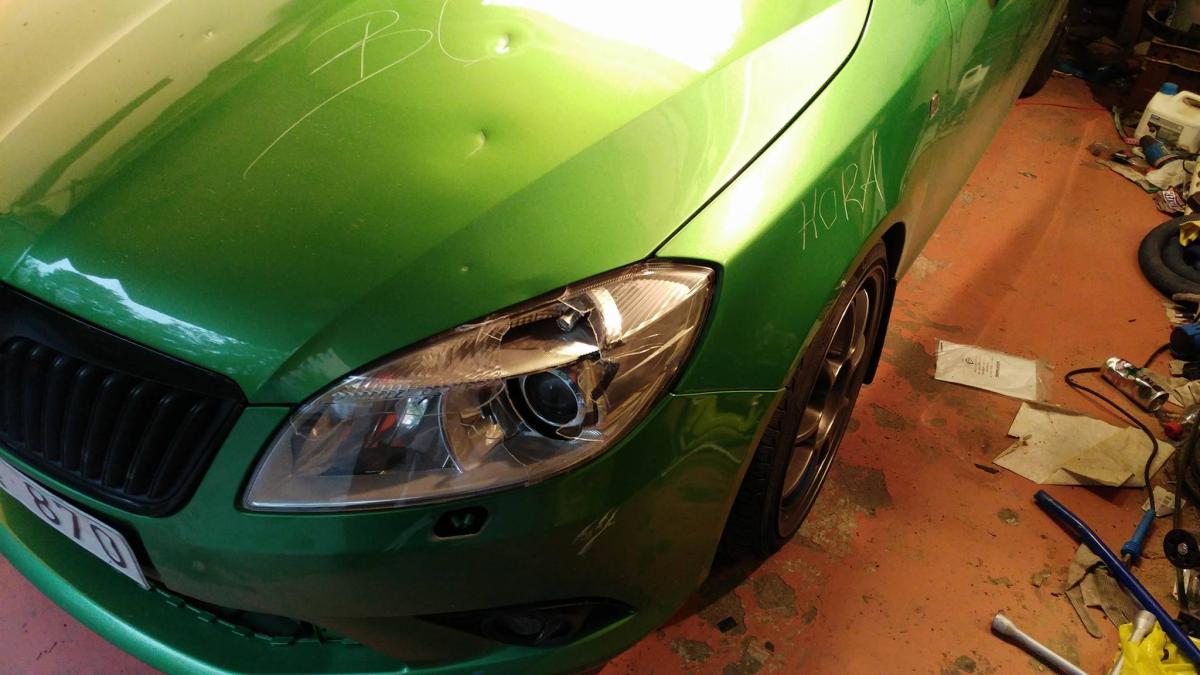

Unfortunatly, someone didn't like the extra power in the car and got jealous.
So jealous in fact that...
Well, I let the picture speak for itself.

Woah!!!!!!! That's horrible I bet your fuming, I know I would be
That's terrible.
Are those alleggeritas?
Edited by larsberg
What a to$$er!! I hope you find out who did it and payback with some karma.
Yeah, I was abit "annoyed".
It has been fixed now atleast :).
That's terrible.
Alleggeritas up front, superleggera in the rear :)!
Let's just say that he will not be doing that anymore.
