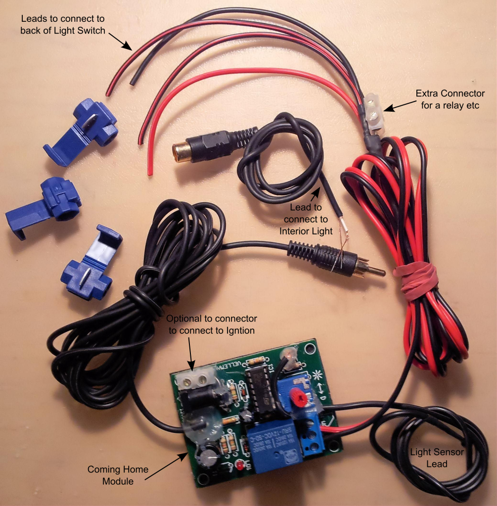

Because some members do not have soldering skills or the tools to assemble the kit I decided to make a complete kit available for £26 for members to buy. This includes everything you need to do the job. Some members have asked if it is possible to control other lights eg Fogs. To do this I can provide a heavy duty relay all wired up and ready to fit for an extra £6
The Basic Module which controls the side lights looks like this
This is what you get for the £26.
As you can see every thing is included including scotch loc connectors to crimp the wires on.

There are two extra chocolate block connectors, one on the module which can be connected to the ignition if you want the module to turn your lights on at night (untested by me but should work) and also an extra one on the lead that goes to the rear of the light switch, which can be used to power a relay if you want to add one yourself rather than purchase one off me.
Also before I send any kits out they are powered on over night just to give them a 'burn in test ' to make sure they are OK.

Quite like the idea of wiring in the fogs as they never get used anyway. Do you know which pin is for the fog lights? Would the fogs switch on without sidelights on? :S
No probs JLneonhug,
Pin number 8 White/Yellow and if connected by itself should only light up the front Fogs, but you would need a relay to handle the power.
Karl
O yeah got my kit on, with headlights!!! A big thank you to Karl for his hard work in the kit and info
Regards Ant
Great talking to you today Ant, glad we got it sorted out, just goes to show never trust a Haynes manual completely always check for yourself.
Karl :thumbup:
