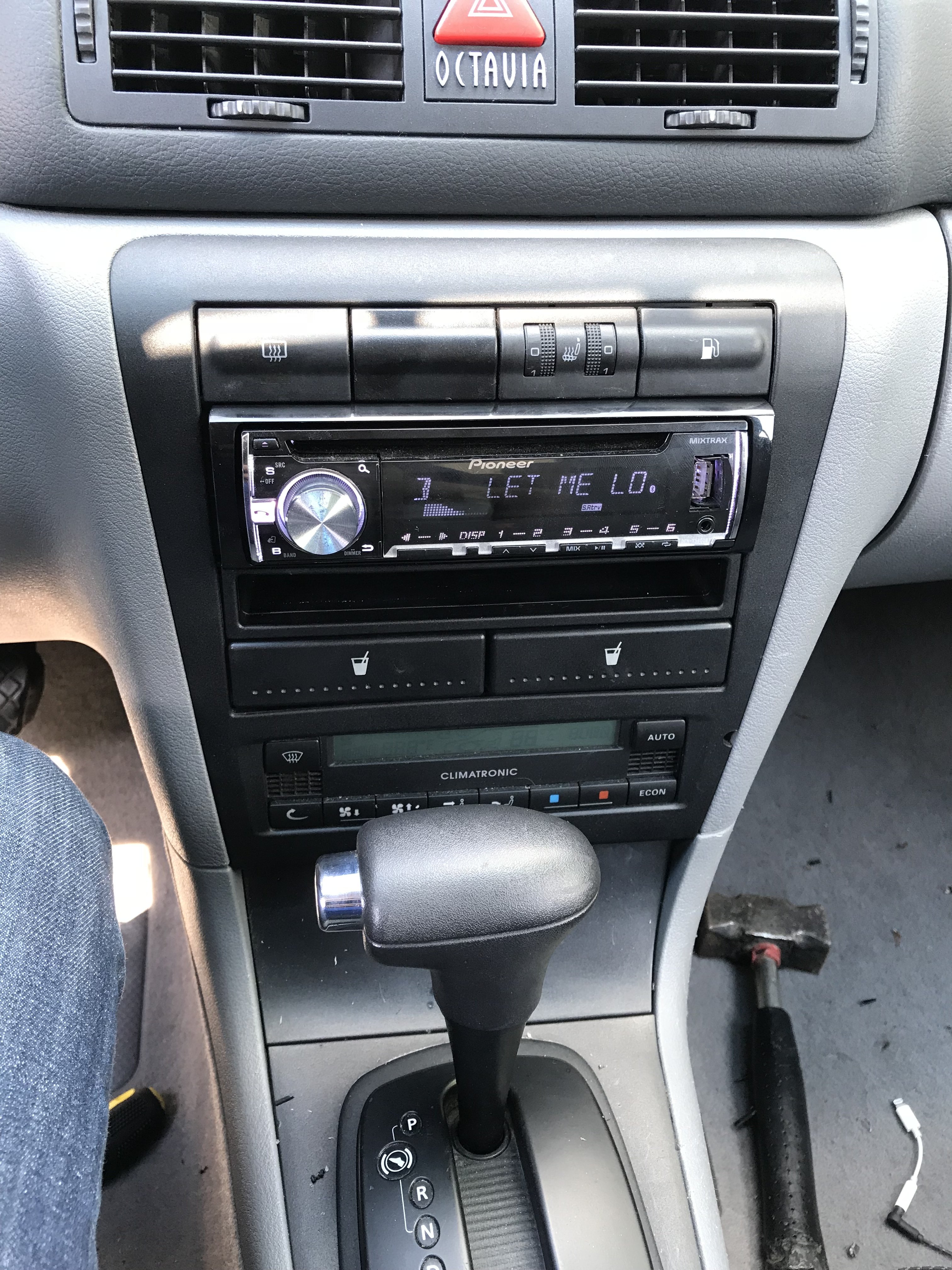

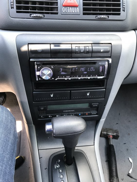

So i read this post and also decided to get the cup holders from the lupo. However I did manage to install them below the radio. Only problem is that it won’t fully open when in park because the shifter is in the way( I’ve got an automatic octy). Mine did also need trimming of course but it did fit. Very pleased with it.
You could swap the head unit and cup holder/cubby around,
Both will fit in either slot..
Save you hopping the shifter off your coffee ;)
Shouldn’t be too much of a problem since it only taps it slightly and it’s only in park when I’m actually parked. On the forums here they said the radio had to be moved down. However i really wanted the cup holders below the radio so I can still operate the radio with the cup holders out. Just wanted to mention it on here since I found the retrofit on here.
