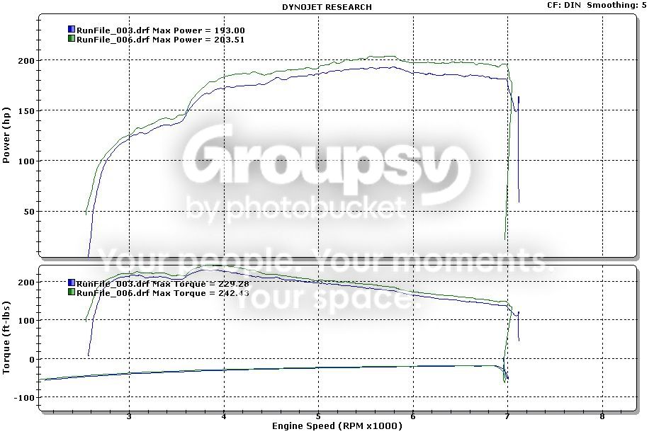

The below is from Scirocco Central website, the ITG kit test was on a REVO Stage 1 1.4 TSi (kit using the front slam panel).
dyno graphs from different runs comparing stock intake and the ITG intake for the 1.4tsi running Revo Stage 1, figures are are whp figures
graph below show consistent improvement accross the rev range
not as linear but larger peak gains
un 3 is stock intake
run 5 & 6 are with ITG
those are WHEEL figures quoted on the dyno plots.
from seeing dynojet graphs previously, transmission loss likely to be around 30bhp as a guess, so non ITG it'd be around ~220bhp @ Flywheel, and ~ 230bhp @ flywheel with ITG in place. both on Revo S1 map.
Taking this post into consideration it's quite possible to see up to a 10bhp gain from the filter.

That really does look promising. Glad I went with it in the end. emoticon-0100-smile.gif
With the ITG maxogen on the Polo GTI (bigger filter as no front battery) I went from 220bhp to 236bhp, just with the intake swap. If you can afford to relocate the battery to the rear or fit a smaller race battery, then I reckon the gains are worth it if you are after the best bhp. B)
