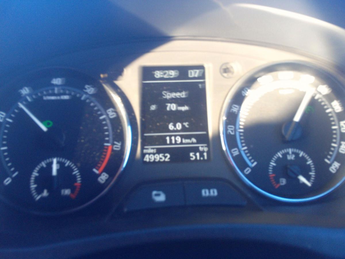

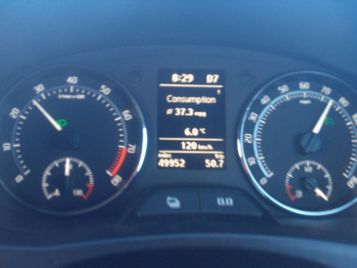

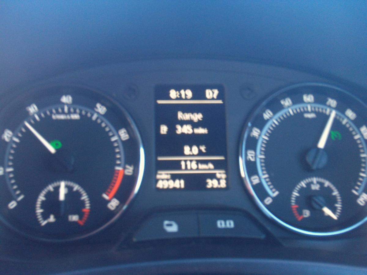

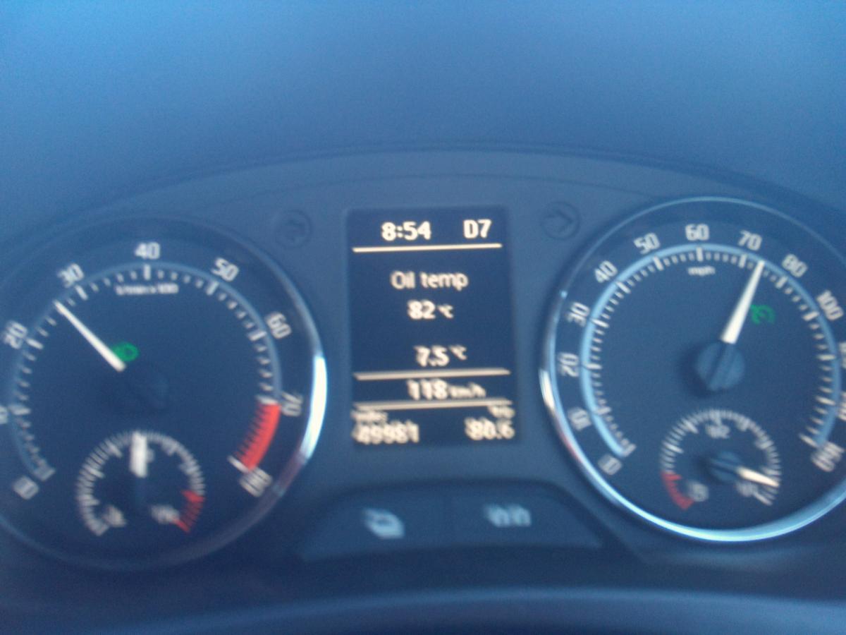

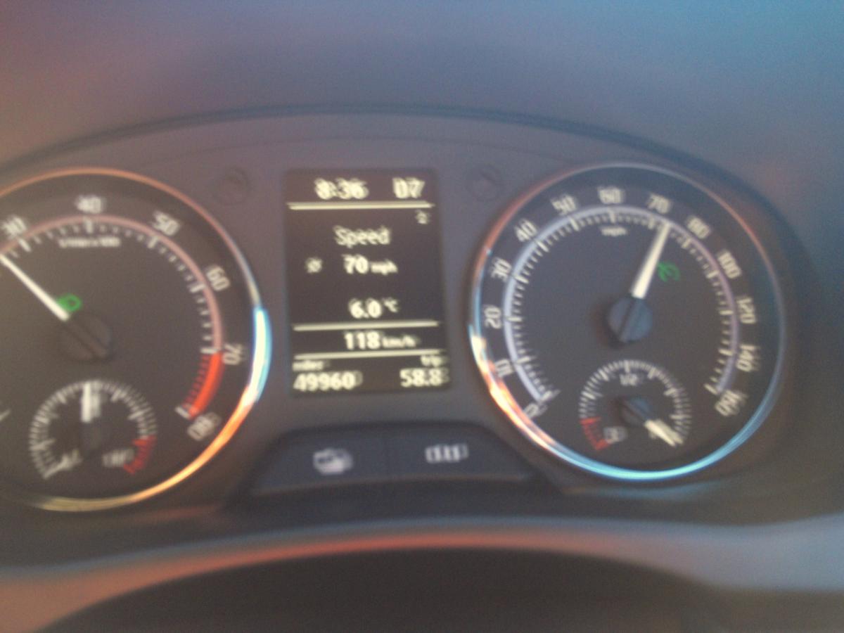

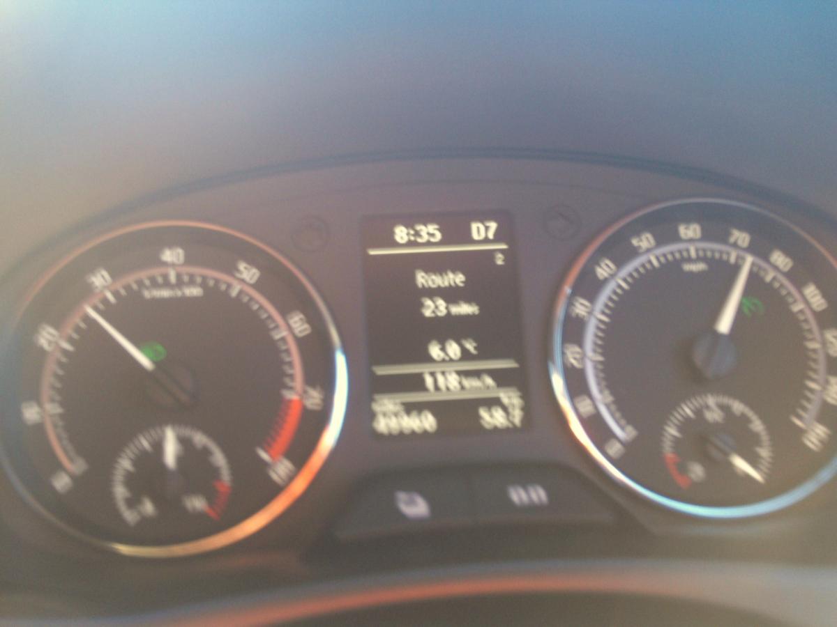

I have just completed a 65 mile journey at an average speed of 50 MPH with an ambient outside temperature of 13.5 Degrees C.
On the Motorway, the temperature ranged from 92 to 95 Degrees C.
On 'B' roads it ranged from 89 and 90 Degrees C.
The figures above were taken off the MFD so may be a bit suspect.
Over some 18,000 miles I have never had the oil temperature above 100 Degrees C and on a reasonable journey around town or on fast roads I would expect to see a temperature at or above about 90 Degrees C so the temperatures above are fairly typical.
Calculated MPG over this time has been 40.1 MPG.
