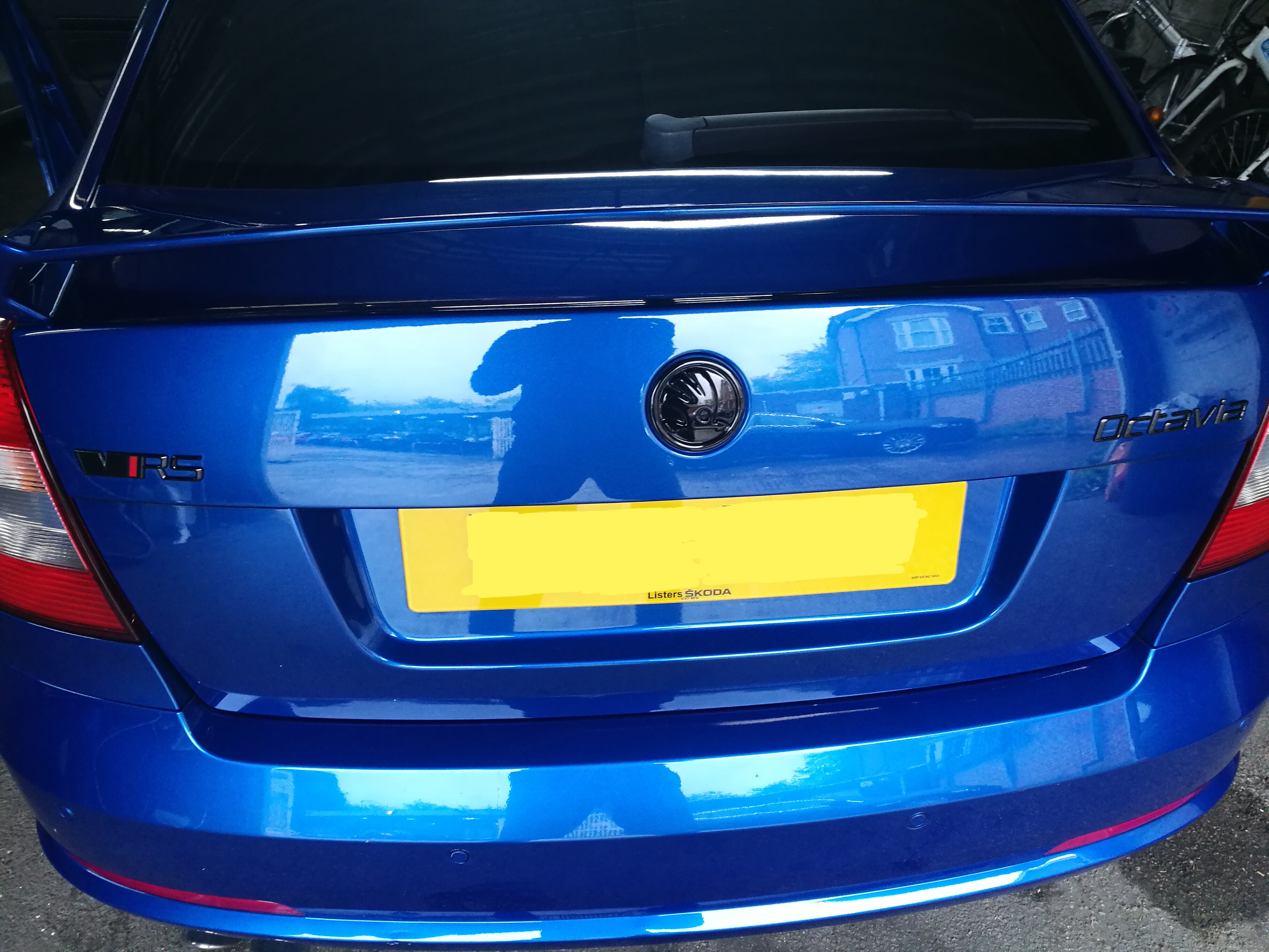

I have ordered the front and rear badges with the same part number as these, from my local skoda dealership, yet the rear badge is 90mm when the size should be 80mm... also ordered a badge that was mentioned at the start of this thread for the rear and it was also the wrong size. So now have 2 non returnable badges and still no badge on the rear :blink:
5J0 853 621 A AUL is the rear I used and is the correct size to inside the recess.
If instead you bought 5J0 853 621 AUL (note the missing A) then I believe that is a 90mm badge so won't fit.

  • My original badges were starting to delaminate and were looking tatty so I decided to change them out for the newer black ones. Very happy with how they look and I think the suit a black car nicely.

@snatcho88Those part numbers supply 1 x 90mm and 1 x 80mm, 1ST 853 601 AAUL is the 90mm and the one I have on the front, it is from a Citigo and requires the plastic plugs on the back snapping off to fit properly.
5J0 853 621 AAUL is the 80mm from a new fabia which I have fitted to the back, take a look at my build thread to see the badges fitted.

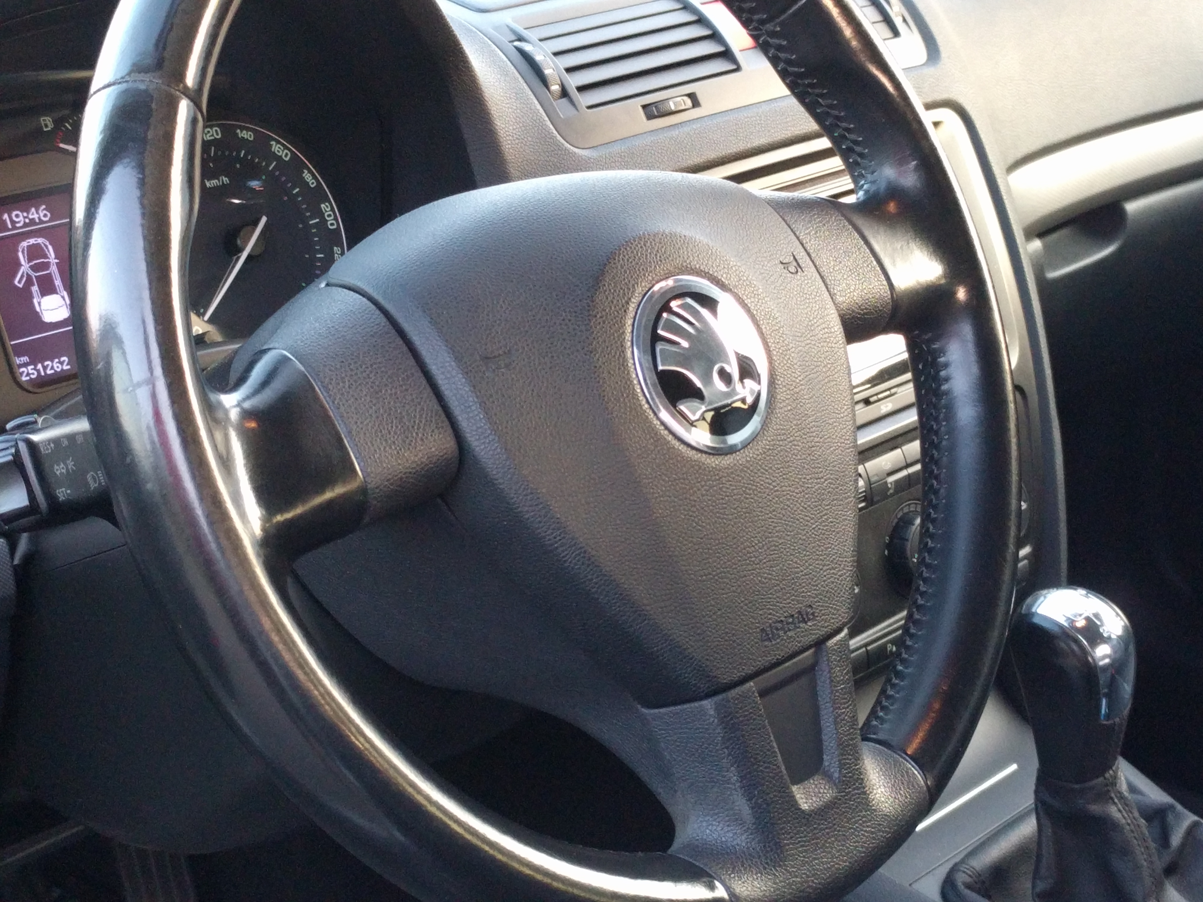

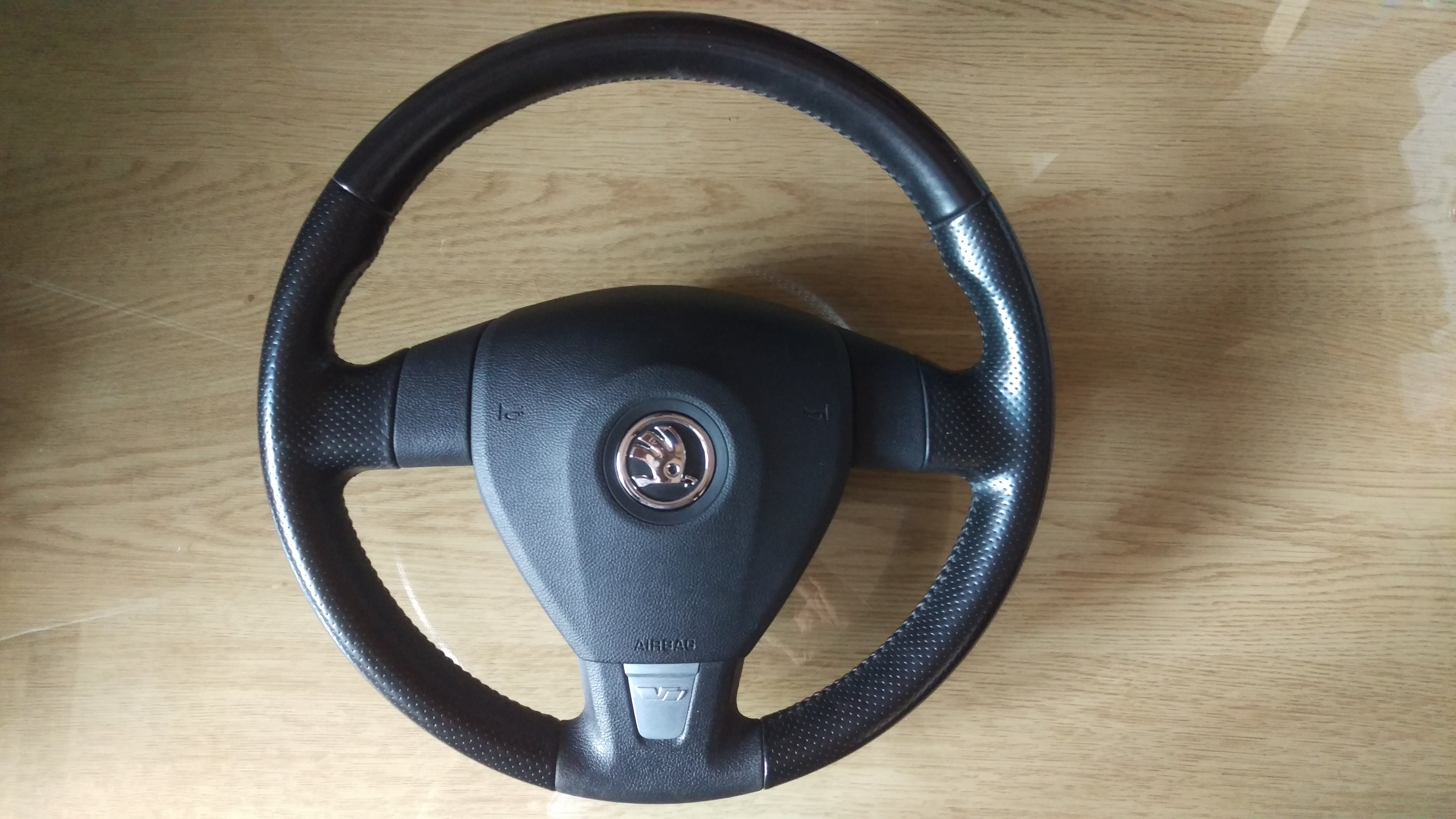

On 28/05/2013 at 06:59, king@rthur said:
Now... had anyone managed to replace the badge on the steering wheel?
 Yes :biggrin:
To those saying DON'T DO IT:  generally sound advice if you don't DO IT PROPERLY.  However, I have done this as properly as possible: strapping, wire tying and gluing from the inside of the airbag cover.  I believe it's as secure as the original badge and personally I think a relatively hard-edged sticker is more likely to form a hazardous projectile towards your face.
Sadly, as this looks really good in my opinion, I have now fitted a mk3 multifunction steering wheel...
That looks awesome, mrhappy!
An alternative to those ****ty flat stickers if people don't want to risk breaking their steering wheel is this concave thick sticker:
Can be found on ebay as a wheel hub cover.
It's of course bigger than the original badge but it fits perfectly over the black edge of the badge.

Part number is in the first post, you want 5J0 853 621 A AUL for the rear :)
Make sure you match the part number as there is a similar version with one A rather than two A's which is a different size.

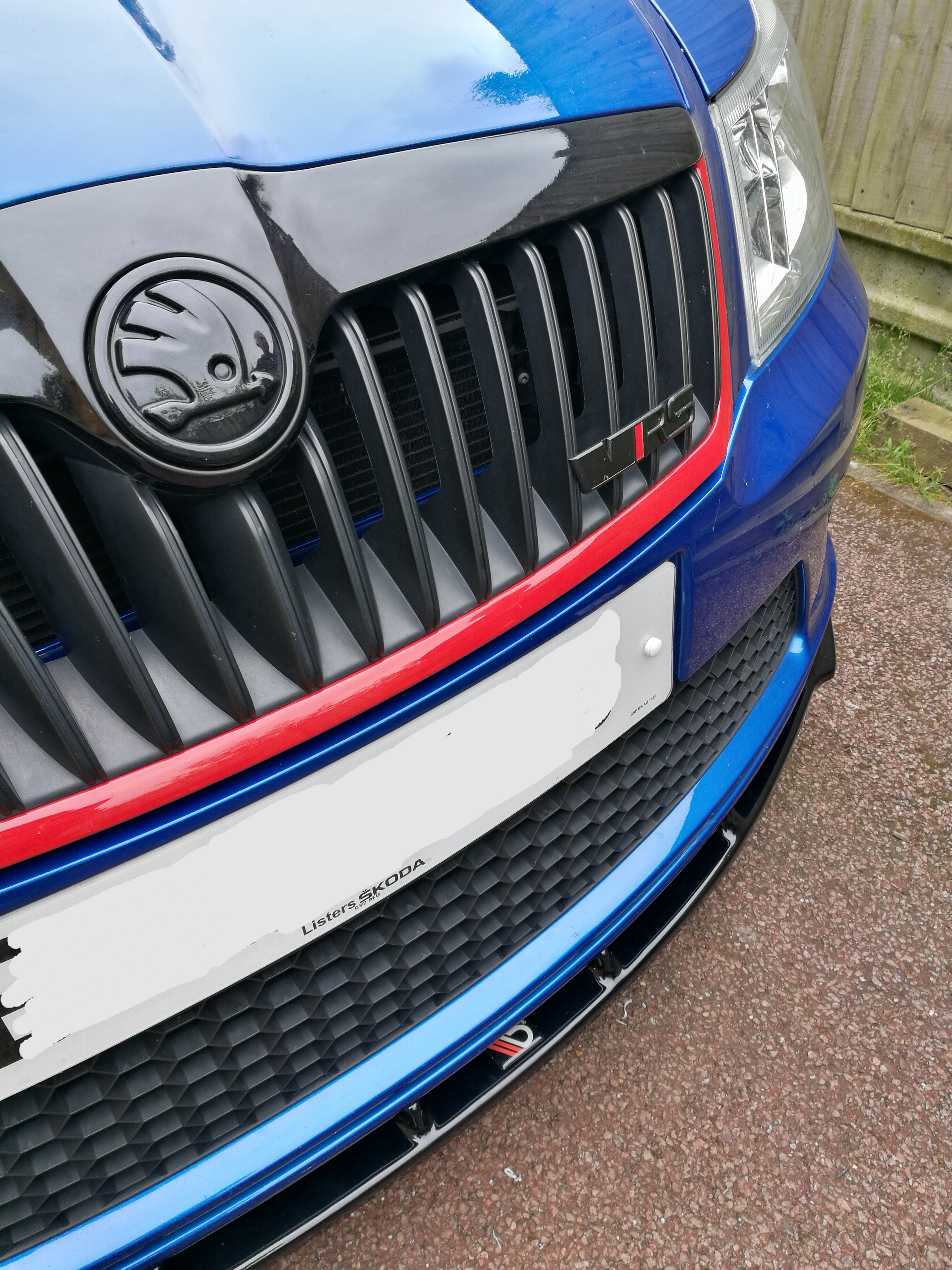

How do you like that guys? :)
Thanks langers2k, it seems the colour coded painted ones I saw on superskoda will not fit then :(
This is what I want for my Octavia 2 FL, front and back.
Before I purchase the all black ones from superskoda and attempt to cover / paint does anyone have any better suggestions or tips?
Did you paint the grill yourself? Very tidy, I've a white fl mk2 and am considering changing the front chrome grill, this does look smart. I'll have to have a butchers on superskoda, did you also get the lower honeycomb part from there? Mine needs replacing at some point.
