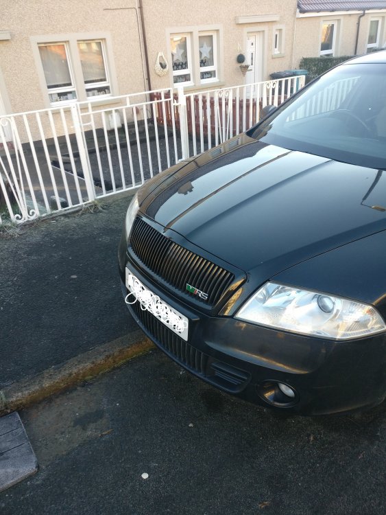

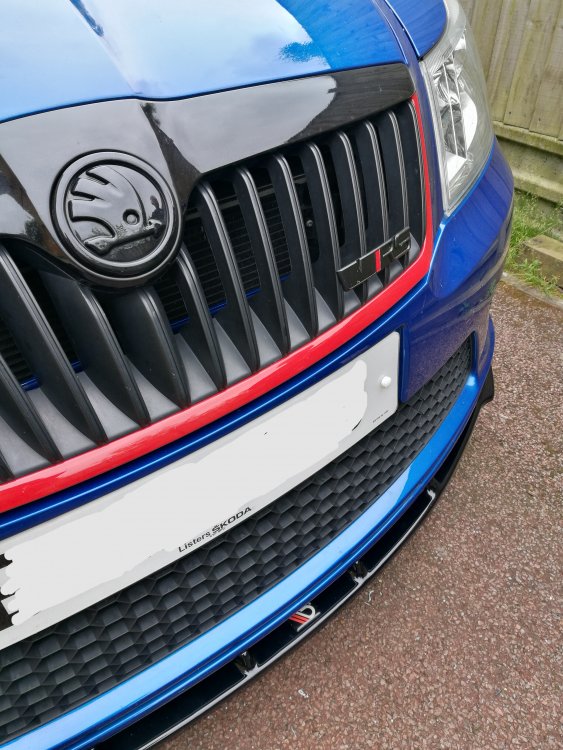

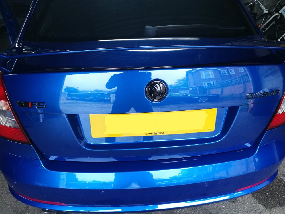

Todays fitments:
1. Colour coded grill and new Skoda and VRS badge.
2. New rear Skoda and VRS badge (dirty)
Used a hairdryer to warm badges then used dental floss to cut behind the badges to bring them off. Then used 'sticky stuff remover' to remove residue. VRS badge left the most crap but gave a light polish and it was all good.
