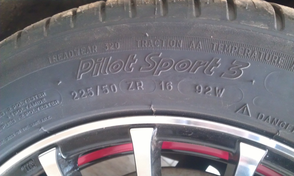

I drive a Skoda octavia diesel 1.9 90hp ALH version. It comes with 15 inch alloys as standard. As I do most of my driving on the highways, I wanted to change to 16 inchers (17 inchers in indian roads is impossible :wall: ) . And the wheel is fitted with 225 50 16 Michelin Pilot Sport 3.
Now, whenever i drive it at a speed of above 120 kmph , car steering starts to vibrate. If i go further to 140-160 kmph, the whole body wobbles like crazy. Then, i got my wheels balanced TWICE in two different tyre stores, but still the problem existed. Then, i read in briskoda that spigot rings can be the reason. So went ahead and asked the tyre dealer who sold the rim&tyre for spigot rings. They fitted 2 rings on the front wheels(as they didnt have 4 and promised to give the next week, and it has been more than 2 weeks).
Now when i drive, vibrations start from 90 kmph compared to 120 kmph before. But when i increase the speed to around 140 kmph, vibration stops(may be the frequency is too high to notice?). But there is no insane body vibration like before.

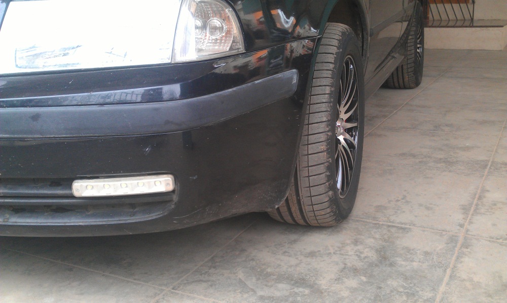

Some pictures of the alloys,

Wheels look like they have the wrong offset and are protruding beyond the bodywork. This can accelerate wear on your wheel bearings and will affect the handling. Tyres might also rub on full lock.

Offset is 35. I was told by someone that offset of 35-38 will be fine for octavia. And going for 16 is to get a lower profile tyres, and to increase the Rim width itself, stock wheel was 6 inch, now this is 7inch, which will allow me to go for wider rubber. To be very honest, the whole drama started because i felt that braking is just OKAY, So thought of going for more grippy tyres. And ended up with... you know.!
