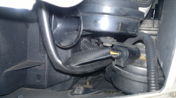

I've now manage to get the fog light grille off and have a look at the horn.
As you will see from the pictures below it looks as though there is currently 2 horns (1 high tone and 1 low tone) that have a single block connector going to each.
Going into each of these block connectors seems to be 2 wires??
How would I go about running wires from those block connectors to the terminals on the new horn??
I guess some 20+amp wire which has some female spade connectors on one end would attach to the terminals on the new horn. But what I'm not sure about is how I attach the new 20+ amp wire to the existing block connectors?
I suppose I will have to take the bumper off to have a proper look at what is what as it's quite cramped in there to see anything!!
Is it hard work to get the bumper off one of these??

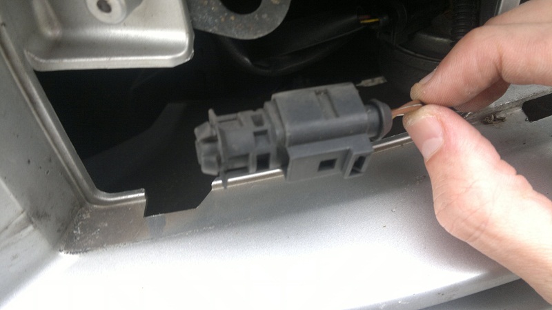

Also... Anyone got any Idea why (in the same hole as the horn) there is some random wires going to a block connector that is attached to nothing?? (See pic below)

The existing wiring for the horn in the Fabia is capable of 20 A and the fuse is already 20 A as standard, plus the circuit supplies no other electronics. You can just hook it straight up without a relay.
You appear to have the better horn in the range fitted. Mine was just a single thing.

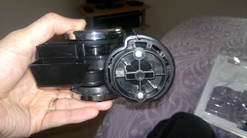

I hooked up my Stebel Nautilus compact with 2 lengths of wire of appropriate gauge for 20 A. A female connector on one end of the wire, and a male connector on the other to fix into the original plug. I believe the brown wire is the negative one on the connector. I wrapped some self-amalgamating tape around the end of the plug and wires to prevent water ingress. If there are two plugs, make sure the other gets fully sealed against water ingress.
I found I needed to space out the horn from the body, and use the original bracket to fix it. Yours came with a little black plastic spacer that fixes to the bolt? Your original horn does not have the same bracket as my original did, so you'll have to get creative here, or possibly make up your own bracket.
I'm not sure what the unknown connector is. So long as there's no faults logged in VCDS I think you'd be ok. It could just be the connector used for cars with a single tone horn?
