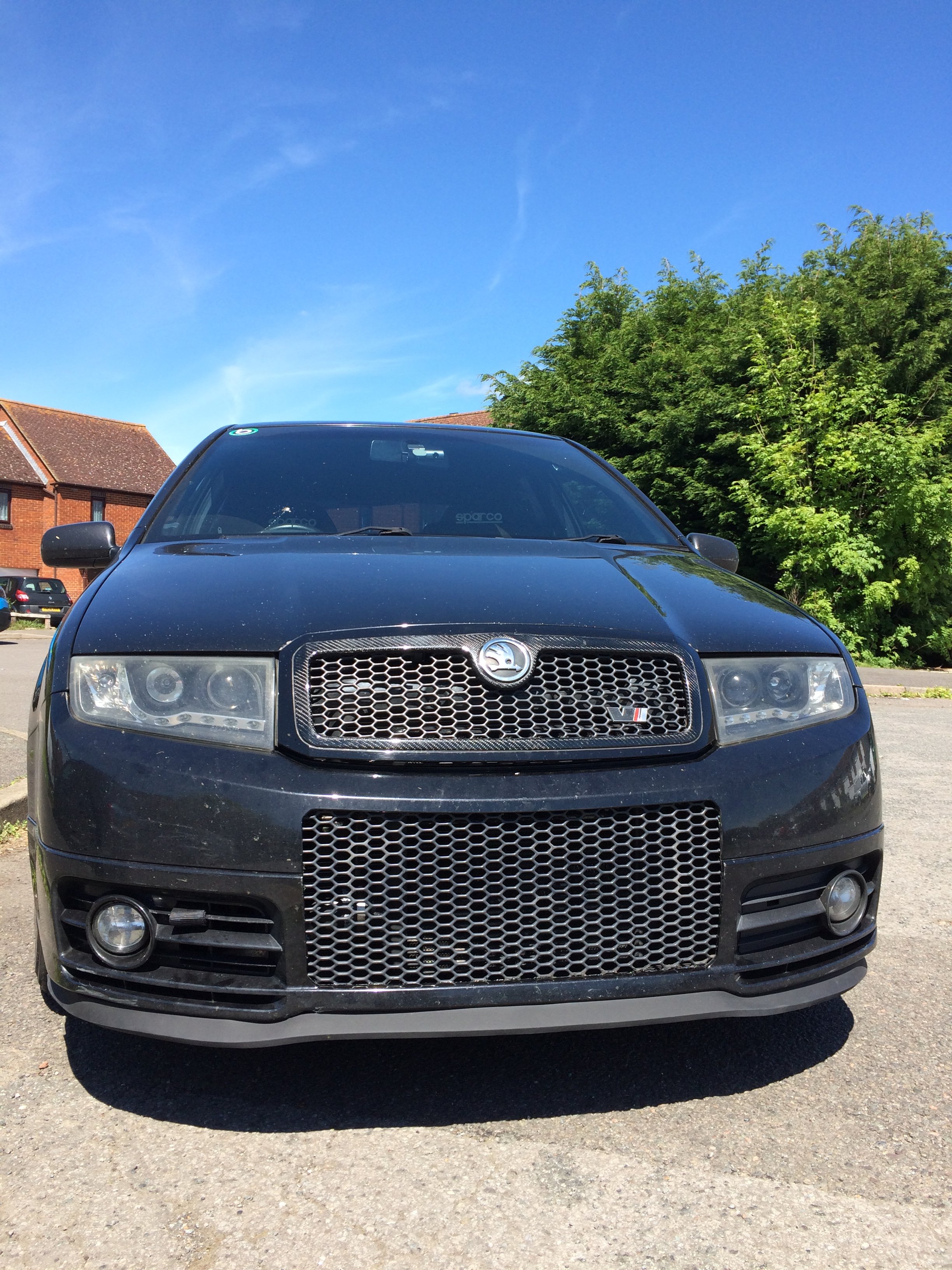

  • The sun was shining again today so gave my car the first polish and wax of the year Phone camera doesn't do it any justice but I'm happy with how it looks
  • To continue the good fortune of today I got my dodgy front fog light sorted and with my brothers help wired in the second fog lamp And I finally got a pic of my Cree led reverse lights They a
  • Gave the interior a clean And a close up of the new front badge

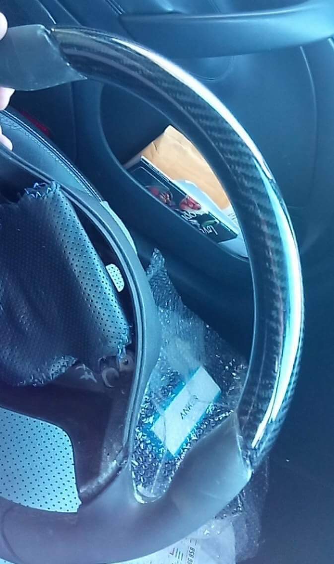

And to top it off the company I sent my steering wheel to for customisation seems to have disappeared off the face of the earth.

Oh no, bad news about the steering wheel!
It can get you down when stuff keeps happening and gets on top of you.
Once you get everything sorted you will love the car even more than before! On a plus side at least you have part numbers now
Yes definitely. PayPal have refunded me for the cost of the customisation I paid for, but need to recover the cost/ recover the wheel itself.

Was yours a standard steering wheel? The seat Leon frwheel I have is rather nice to use.
Shame to hear of your problems mate.
2016 has been exactly the same for me too. And the start of this year might not be much better lol.
Annoyingly no, It was a golf r32 one.
Are we talking about the same guys who did my wheel?
Edited by 32KOFDATA
I don't think so

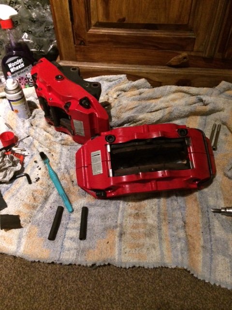

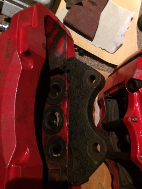

Since the brake disc cracked and split back in November, I thought it was a good time to start to clean up and service the brakes.
the bolts holding the retaining pins were a little stiff on the drivers side, but eventually gave way
the pads didn't want to come out so had to struggle with them, but they eventually worked free.
then it was time to start giving them a clean

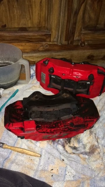

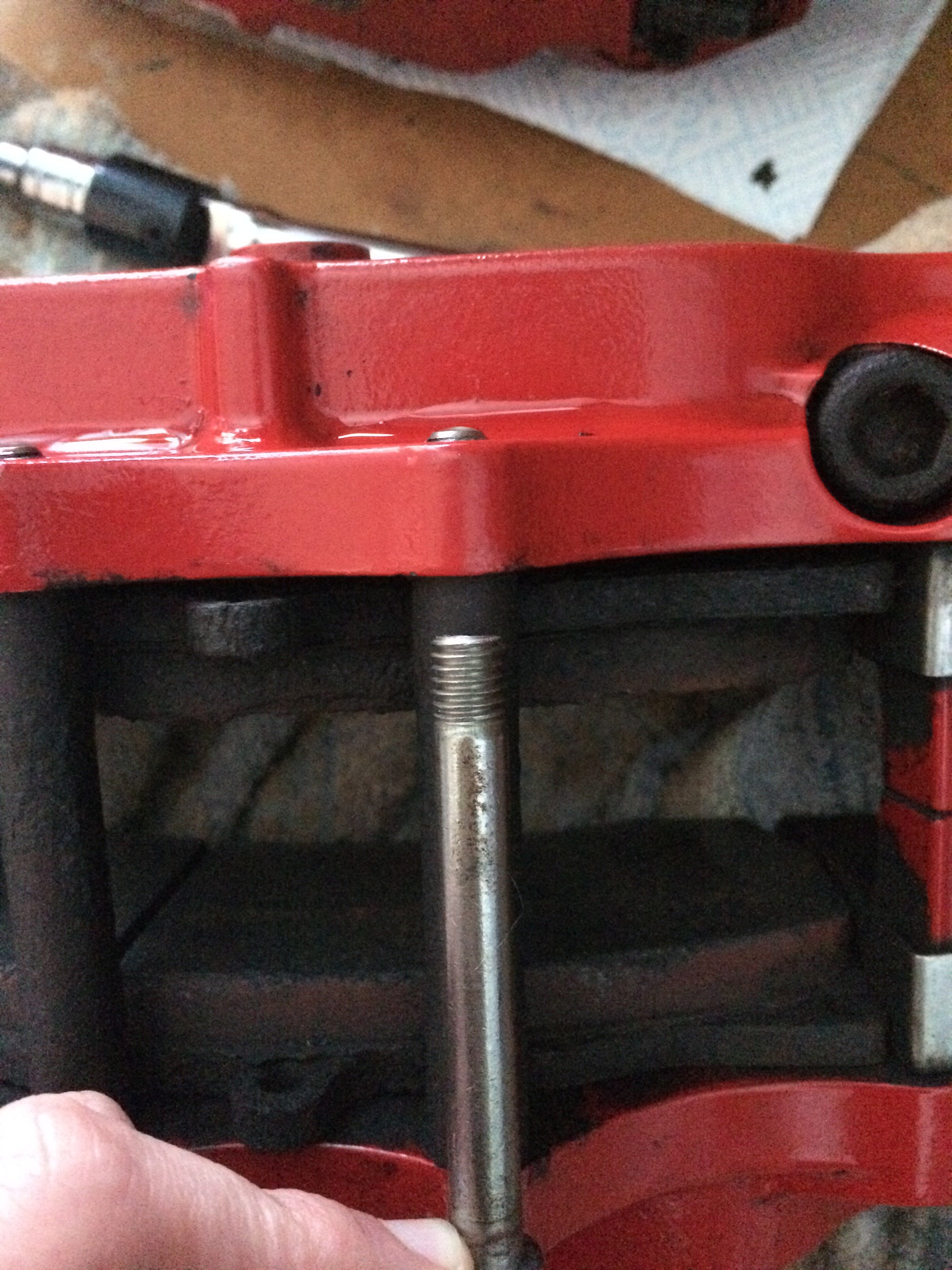

then hit a problem with the passenger side
still got got the other one to try and remove, but lost all motivation.
really doing my head in now
Those brakes look nice - do you know by any chance if they are heavier than the stock 312mm?

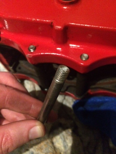

Snapped the pad retaining bolt Charlie? I assume its snapped clean off flush with the caliper body?
Get a tiny steel drill bit down the middle then try and get a hole big enough for an easy out to try and crack it out. Pain in the A$$ though aint it?
Yes, it's the pad retaining bolt. It looks like part of it is still sticking out, so I can't get the retaining pin/ sleeve out either
The calipers are quite light, but it's the discs that weigh more. Approx 8kg each
You should still be able to drill it from outside - in if that makes sense. The heat from drilling it might loosen it as well
Yes, the bolts look like they curve inwards on the tip, so should be able to get the drill in there

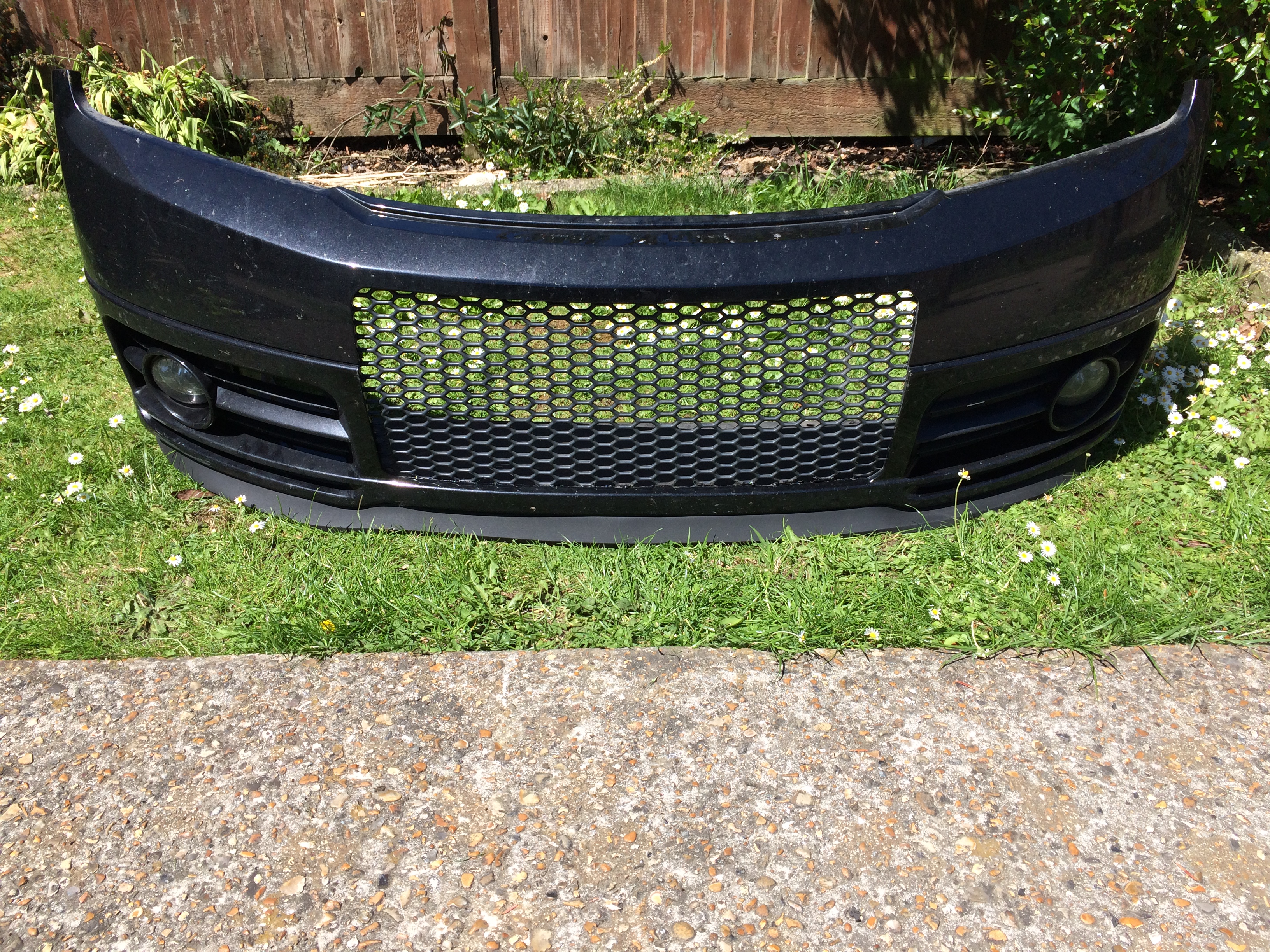

After a couple of years and a few bits of roadkill, my lower grille was coming away in, so had some time to re do it. Whilst the bumper was off I decided to fit a rhino lip splitter. A little trial and error, but looks pretty goodIMG_6138.thumb.JPG.1a3e3501a8aec9c322bb11dffd1b5212.JPG

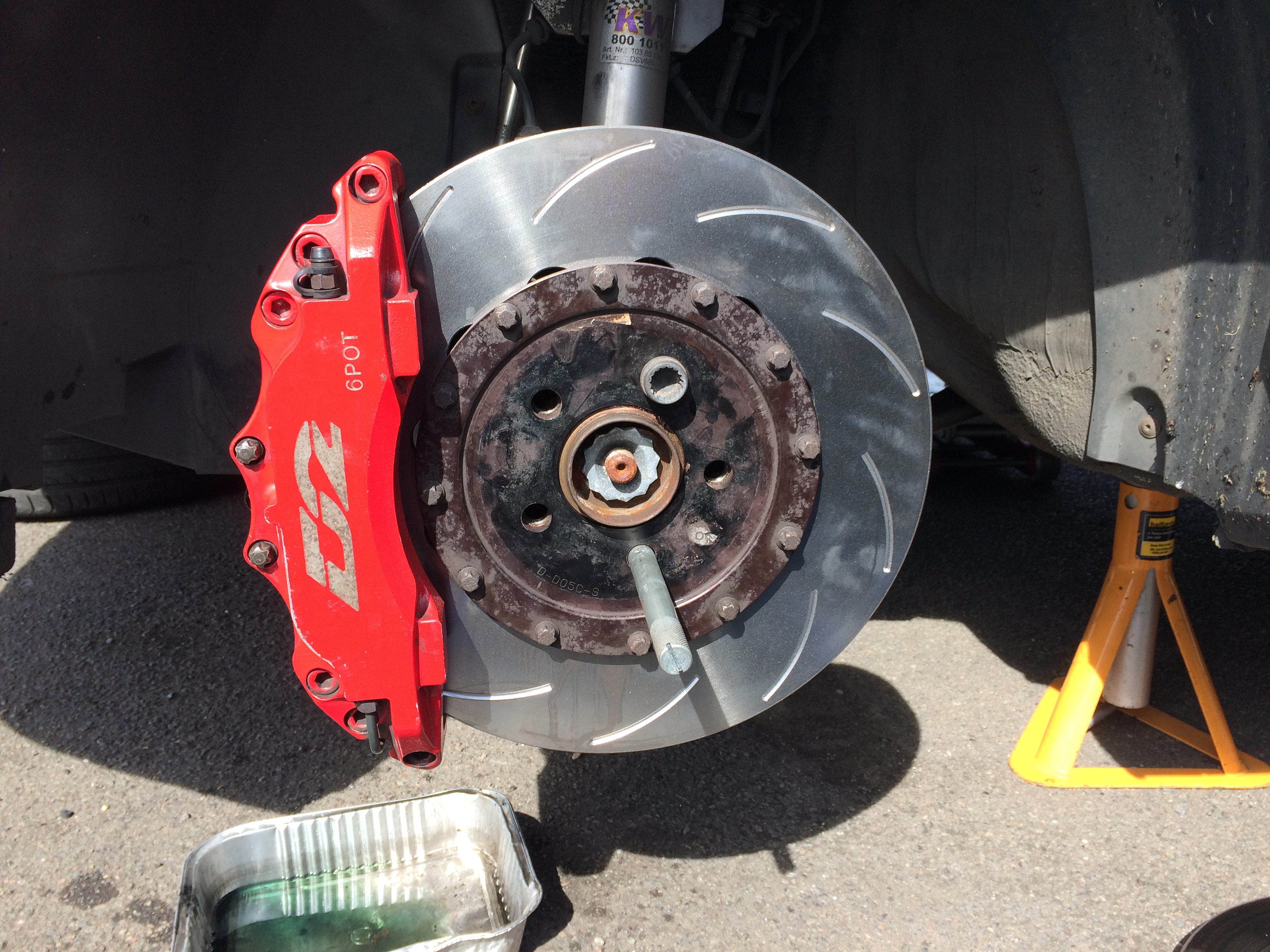

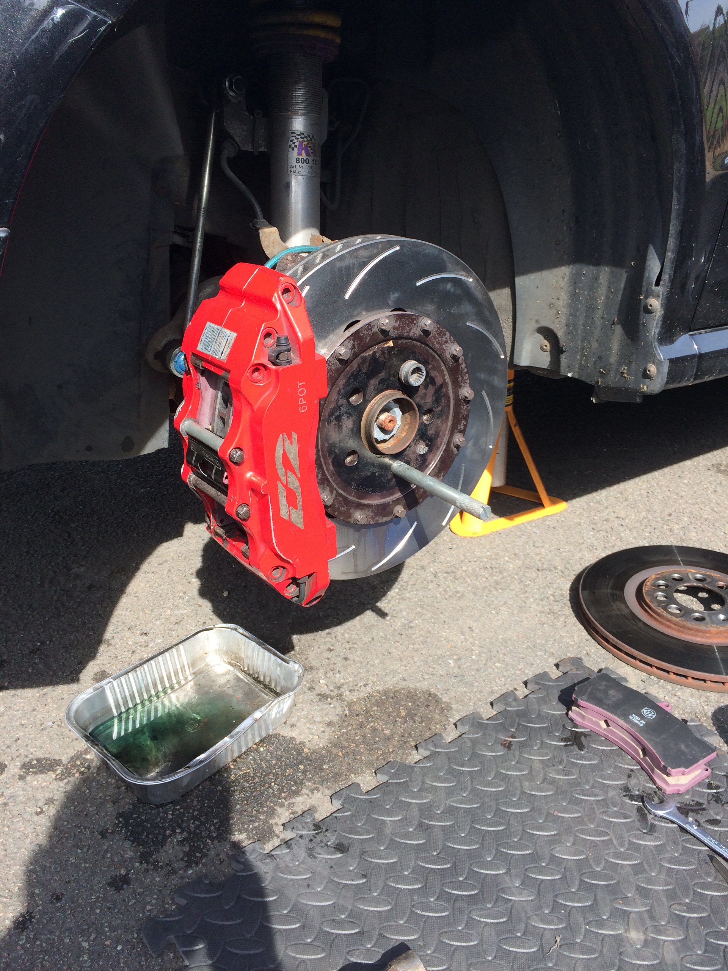

IMG_6184.thumb.JPG.2f65183afa7241380c1c9f212dd65191.JPGIMG_6185.thumb.JPG.9cf0b6c333182427f546bc6cf78c2199.JPG
Now the brakes have been overhauled and new discs and pads have arrived, I have finally got them refitted :)
also replaced the fluid with motul rbf600. Looking forward to getting them bedded in now.
had the battery fail on me as well today which was a pain. Luckily my brother has one which came from his Octavia.
i could do with some new discs and pads for the rear, but not essential at the moment
is that good high temp brake fluid charlie? I'm looking to do mine before the ring trip this year!
Yes, meant to be pretty good. 312 degrees boiling point
