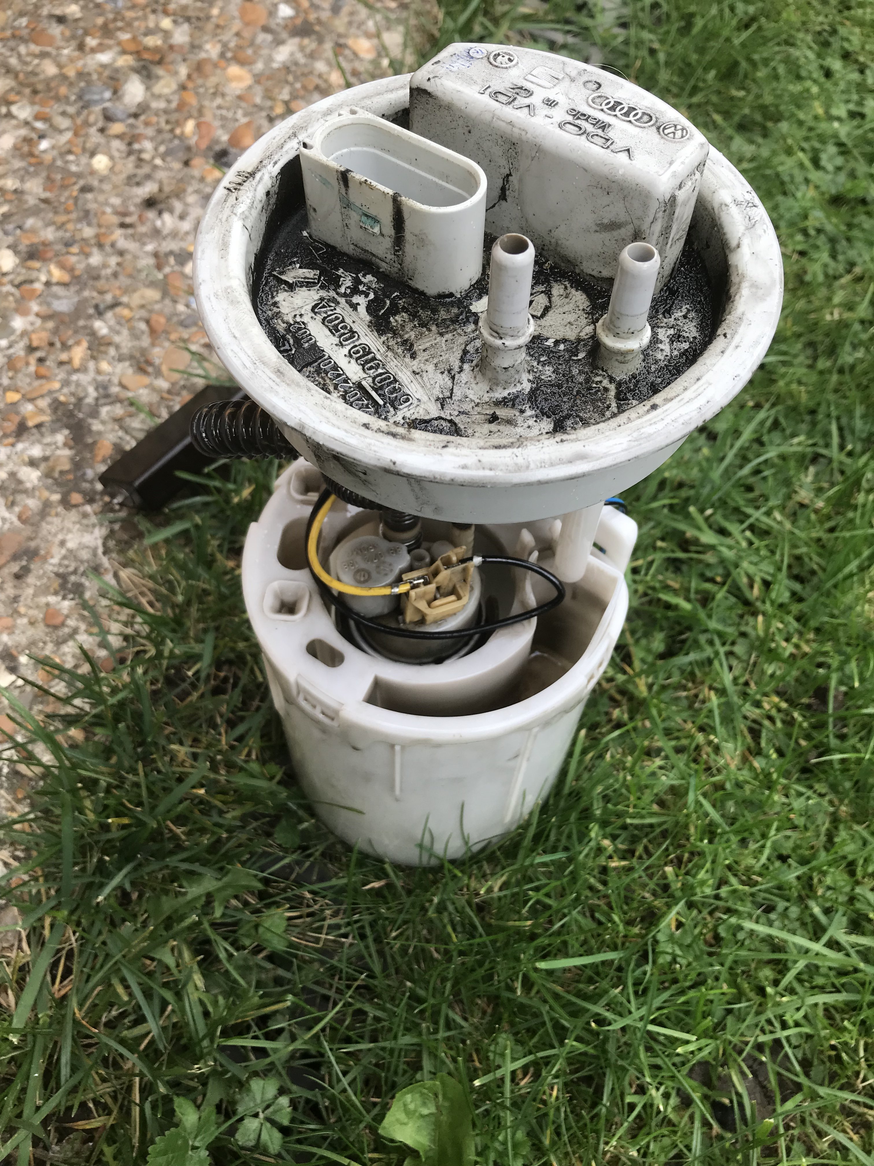

also replaced the in-tank fuel pump. When first turning the key it didn’t sound like it was priming properly
old one looking a little worse for wear
No no pics of the new one, but seems immediately better.

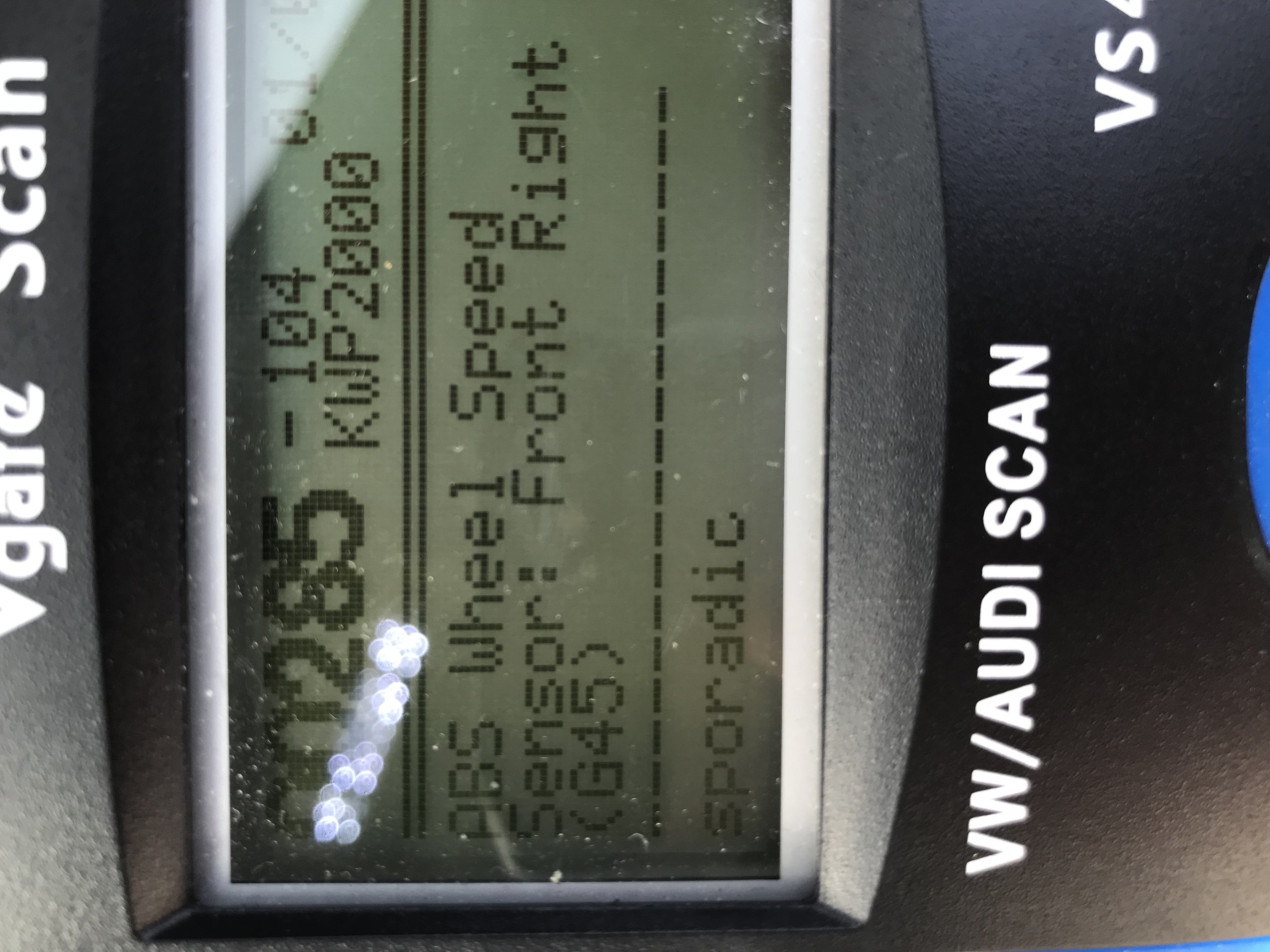

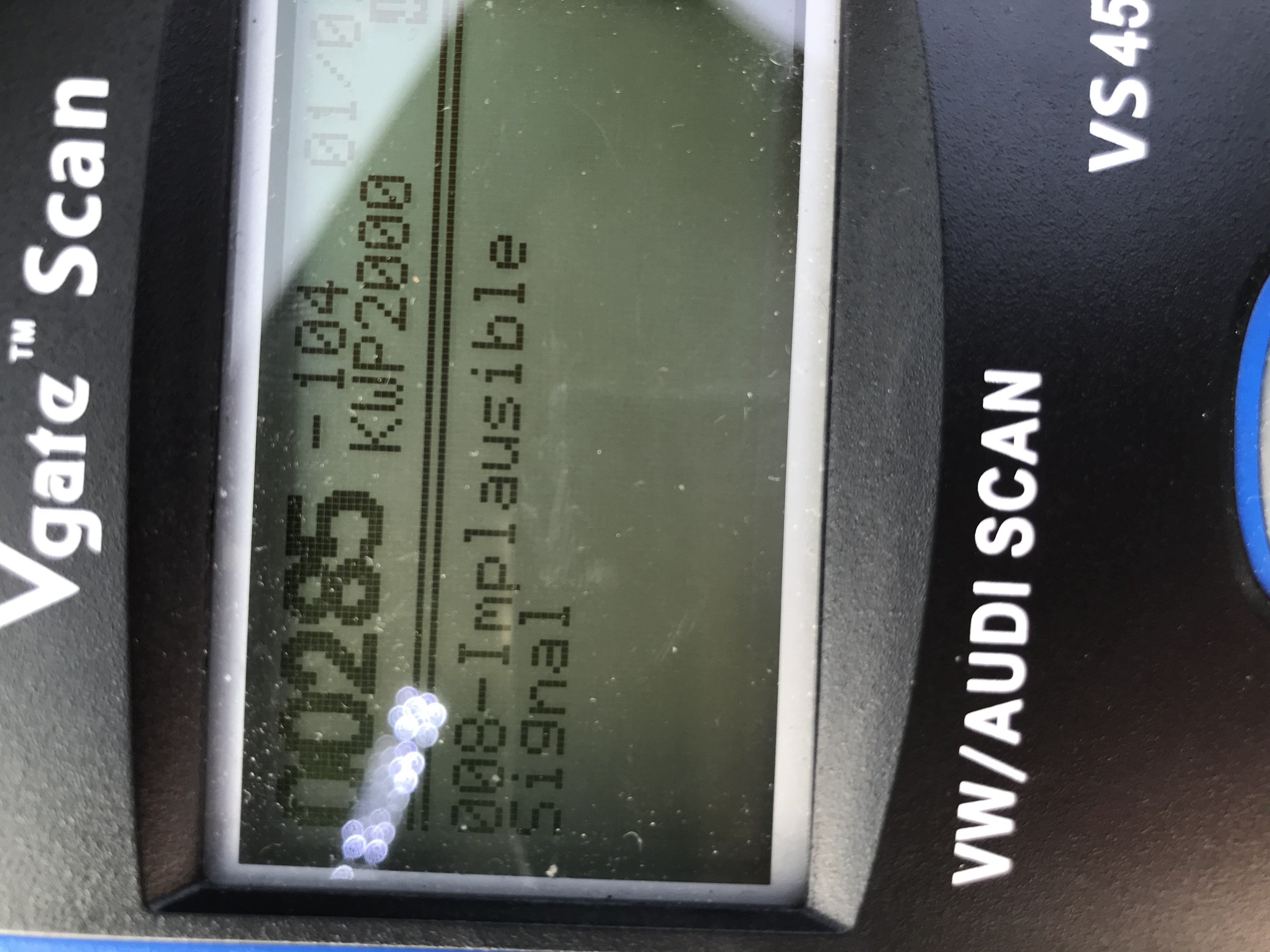

Ho hum, broken again
i have a couple of abs sensors kicking around, so will try to replace it and check the wiring.
interestingly mpg has taken a big hit too.
the trip has been showing 25mpg average and only got 40mpg from this tank of fuel

I had the same and error on my Ibiza, if the sensors don't sort it the wheel bearings might have shifted in the hub and need reseating.
Edited by DriverTom
Thanks, still got the new sensor to fit, so hopefully sorts it. The previous one I bought was the wrong one size and the old one came out in pieces.

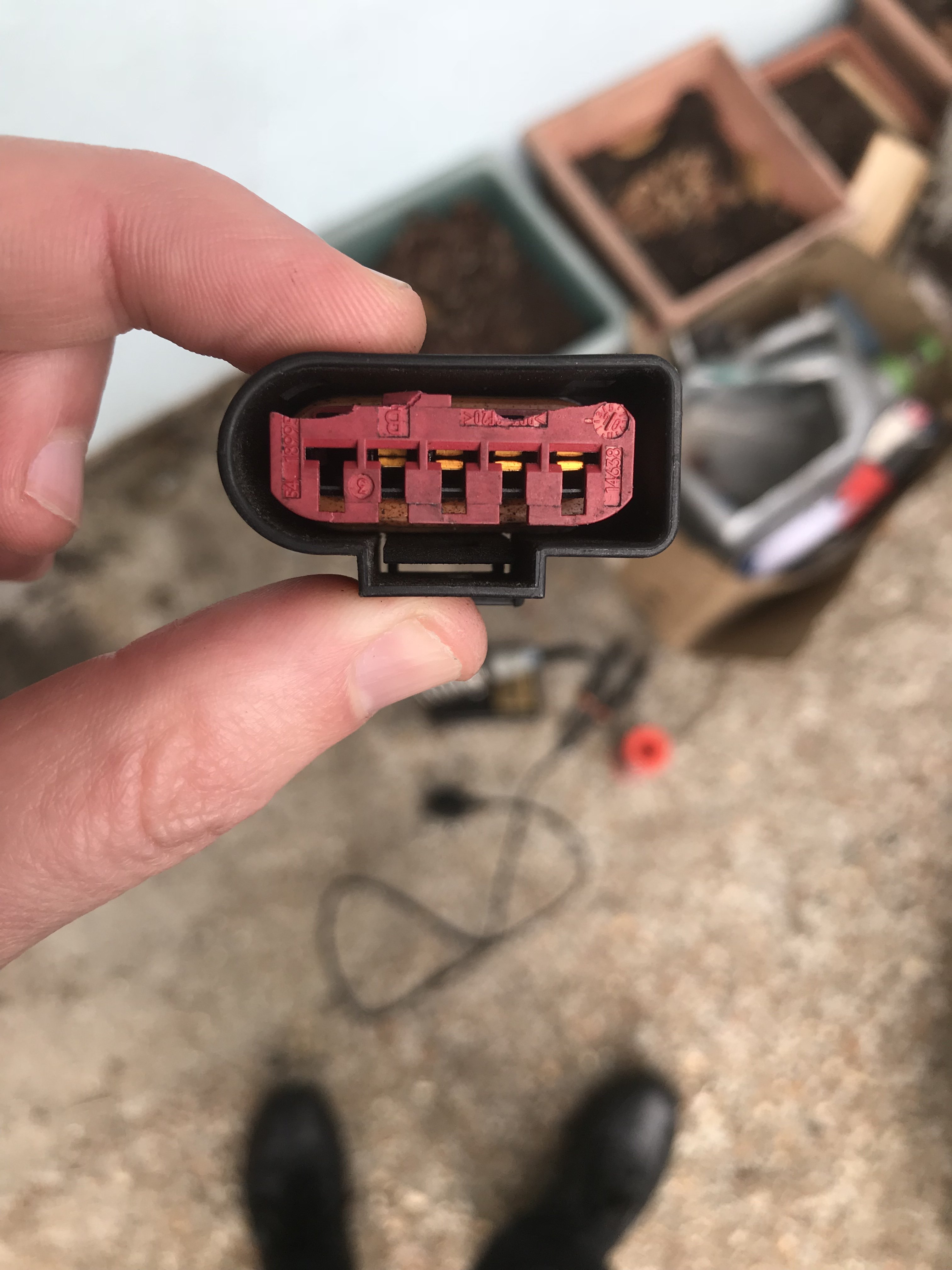

replaced the plug as the plastic housing was broken. Also replaced the plug for the map sensor as one of the wires had snapped inside the connector.

25mpg is terrible for one of these. Any thoughts on what’s caused such a drop?

I shouldn’t really complain as it’s the original cv joint, that’s covered 190k miles.

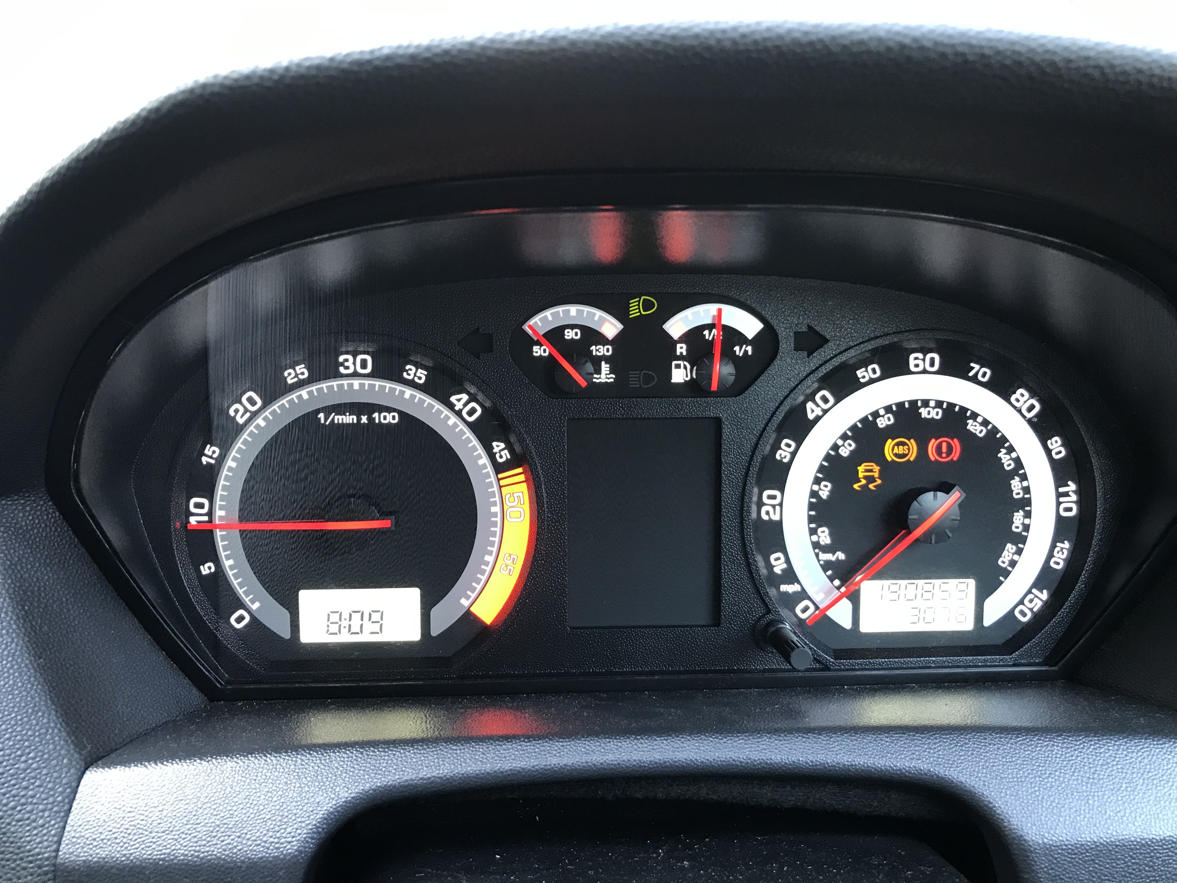

turns out the mpg was related to the dodgy abs/ wheel speed sensor. It was only registering half the distance I was driving.

Interesting about the abs / speed sensor being the issue. Kinda obvious when I think about it (assuming you were still getting the same number of miles out of the tank)

Yeah, only became obvious after filling up and resetting the trip. My 18 mile drive to work only registered as 9
