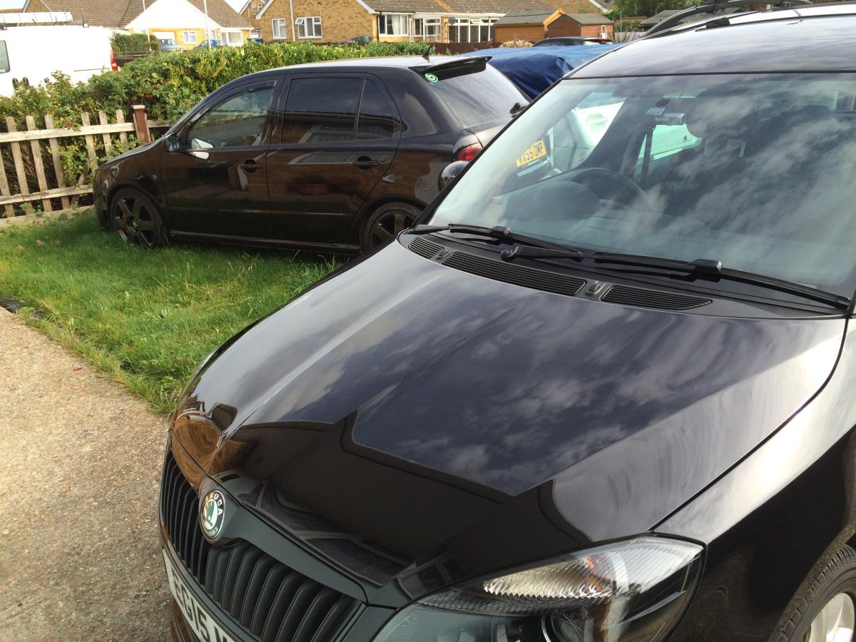

  • The sun was shining again today so gave my car the first polish and wax of the year Phone camera doesn't do it any justice but I'm happy with how it looks
  • To continue the good fortune of today I got my dodgy front fog light sorted and with my brothers help wired in the second fog lamp And I finally got a pic of my Cree led reverse lights They a
  • Gave the interior a clean And a close up of the new front badge

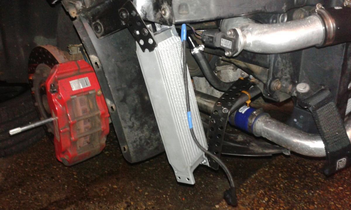

On good news the car is now sporting an after market oil cooler. (Pics to follow)
Also changed the radiator, expansion tank and replaced some of the coolant lines as a few of them weren't sealing properly. Went down to 7mm fabric braided hose

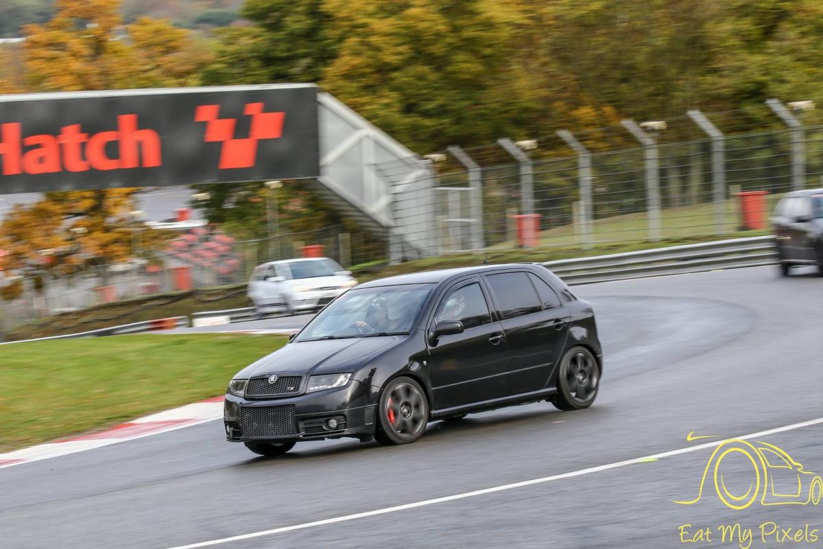

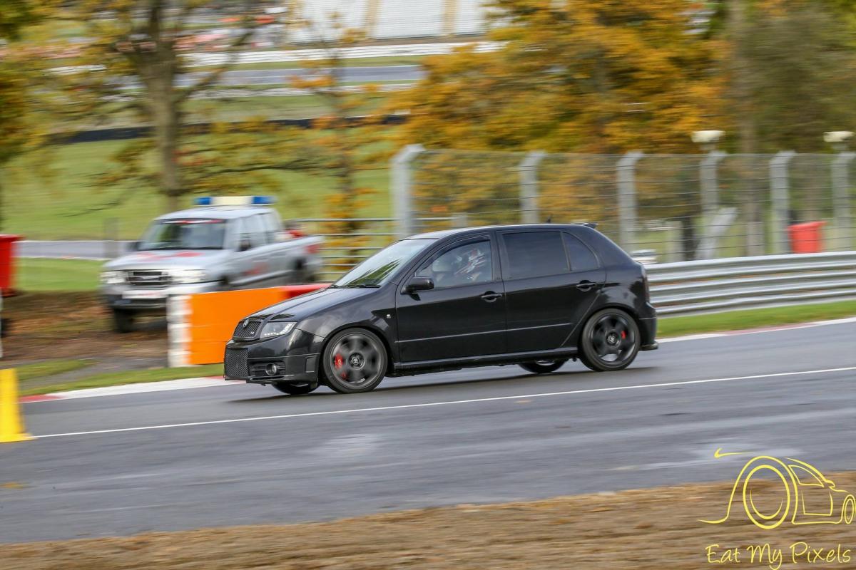

Here's a few snaps from Monday's eventful track day
Didn't get as many laps as I'd have liked as I had a few issues crop up.
First time out I started to get a vibration from the drivers side front, which is possibly to do with the disk, either glazed or slightly warped.
Let it cool down and went out for another run which was much better, no vibration but the session was cut short due a red flag.
I let my brother take my car out and after watching him go round a few times I noticed the car was steaming. Tried to wave him in, but he didn't notice, luckily a marshal spotted it too, so waved him in.
Popped the bonnet and noticed that there was a massive build up of pressure in the coolant tank, which forced the coolant out of the cap.
Suspected culprit is head lift, so will need to replace the head gasket!
Game over for me for the day.
