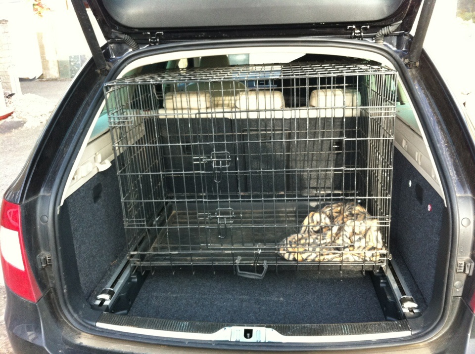

I have popped a dog cage in the boot of my estate and have had to remove the false floor - sadly it's still about 5cm too high as when the boot is down the glass of the boot is resting on the top of the metal dog cage.
Can I remove the sliding rail on the floor ? If so how ?? :)

Photo of the problem

The metal rails are part of the boot floor and cannot be removed without causing permanent damage, much easier to change the box as mentioned already.
Not true. You need a special bit (XZN, I think it was M10, but could also be M8), but then you can easily remove the rails. I had to remove my left rail when I mounted my tow bar. If you have a good look at the rails, the screws are very easily visible.

Yes as previous post. Very easily removed with the right tool. Three fixings per rail. Mine came out to remove the side trim to fit towing electrics too.

As a temprary fix, can you not just turn the basket sideways and push down the rear seat so it slides far enough in ? It might be a bit tricky to get Rover in and out, but it should get you past the problem until you remove the rails

Many thanks all - undone the bolts and removed the rails :) dog cage now fits in
