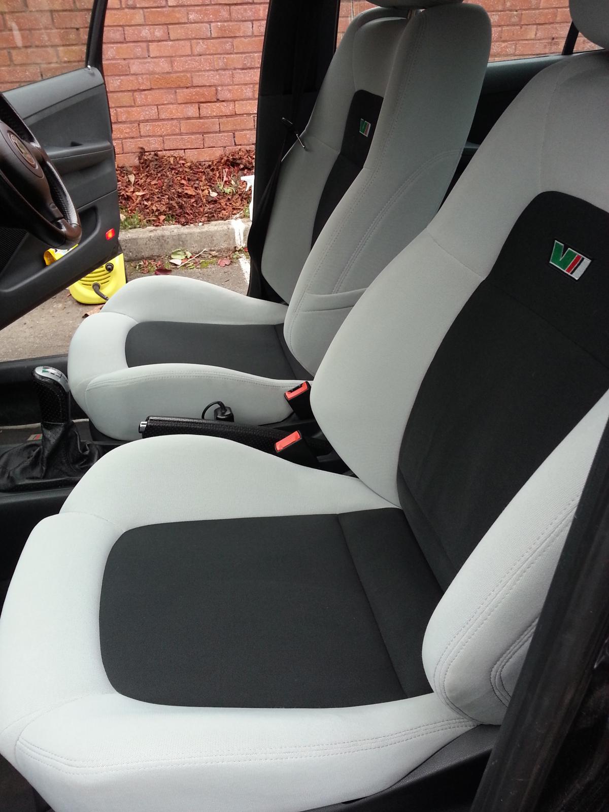

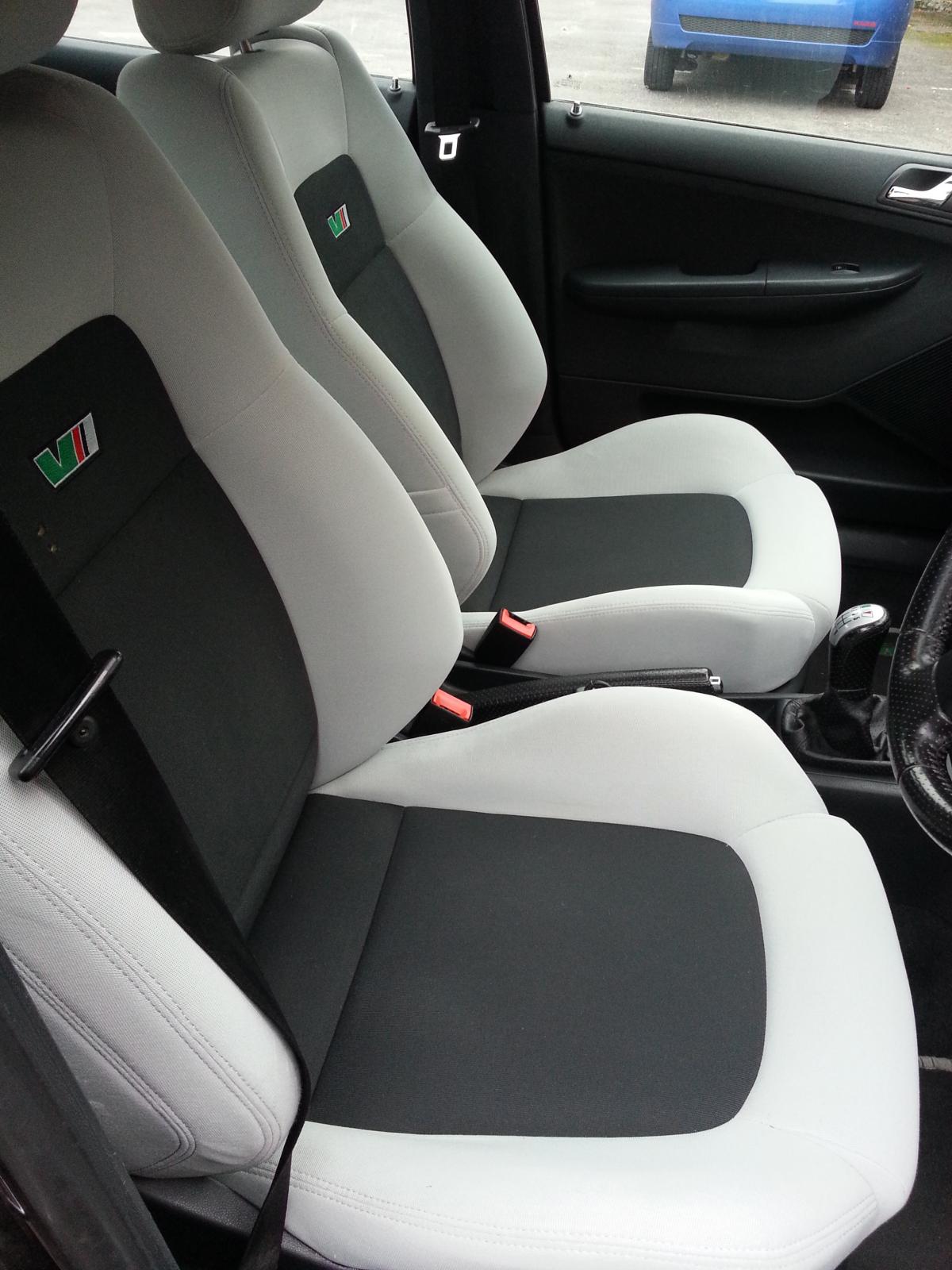

Did my fronts with the vax on saturday.... they've come up lovely. I used vax ultra+ solution. No water tide marks on drying what so ever.

Did you use the water pump on the Vax itself, or bucket and brush and Vax the excess water up?
I've just had a go at mine and a lot of muck has come out but they don't look perfect at all. The Vax seemed to just soak the seats! Did you use a brush to agitate or just the small upholstery head on the vax unit?
I used the upholstery head with the water pump on the vax and vacuum turned on at the same time, no brushes or buckets involved. You can sort of control how much liquid is sprayed using that slide mechanism on the upholstery head. It was not a quick job mind, i spent a good 2hrs plus on them and i must of refilled and emptied the machine 5 or 6 times and worked over each area at a slow pace. after going over each section a couple of times i would stop the water spraying then use just the vacuum to suck out as much of the moisture as possible to try and prevent tide marks.
Ive only done the fronts so far, will need to have a go at the back seat sometime, but that on isn't too dirty as nobody is ever in there.
