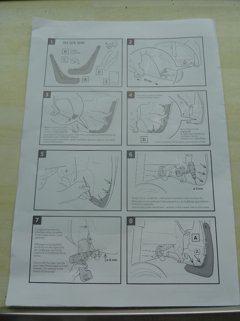

I ordered a set of the genuine skoda front and rear flaps now their out in the wild. Interesting is they differ from the UP! ones in the way they mount. The fronts used only existing mounting point so no drilling, but the rears required 5 holes be drilled in the rear bumper each side. They do come with a template for the holes. I decided to return the rears as Im not happy to drill the bumper.

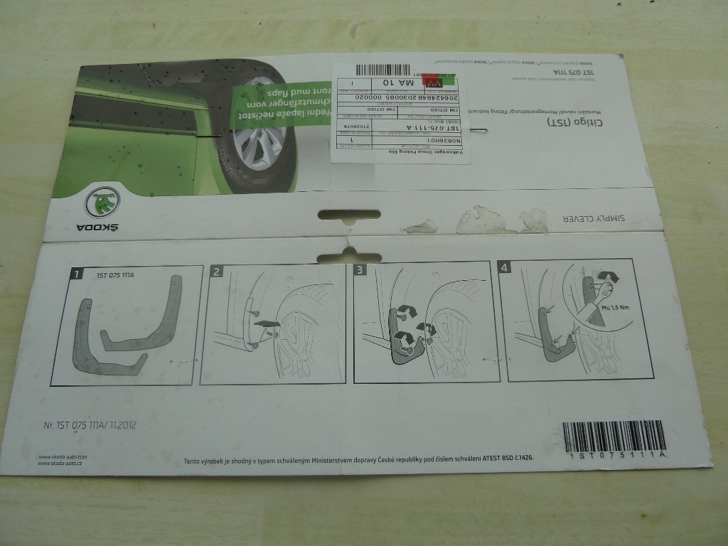

Just to update on this:
Picked up my new Citigo this week & got a set of mudflaps to fit myself.
The Skoda fronts seem to differ slightly from the ones in the original post in that they use the three wheelaerch liner torx screws to fit & need no drilling which is a bonus.   10 minutes & job done.

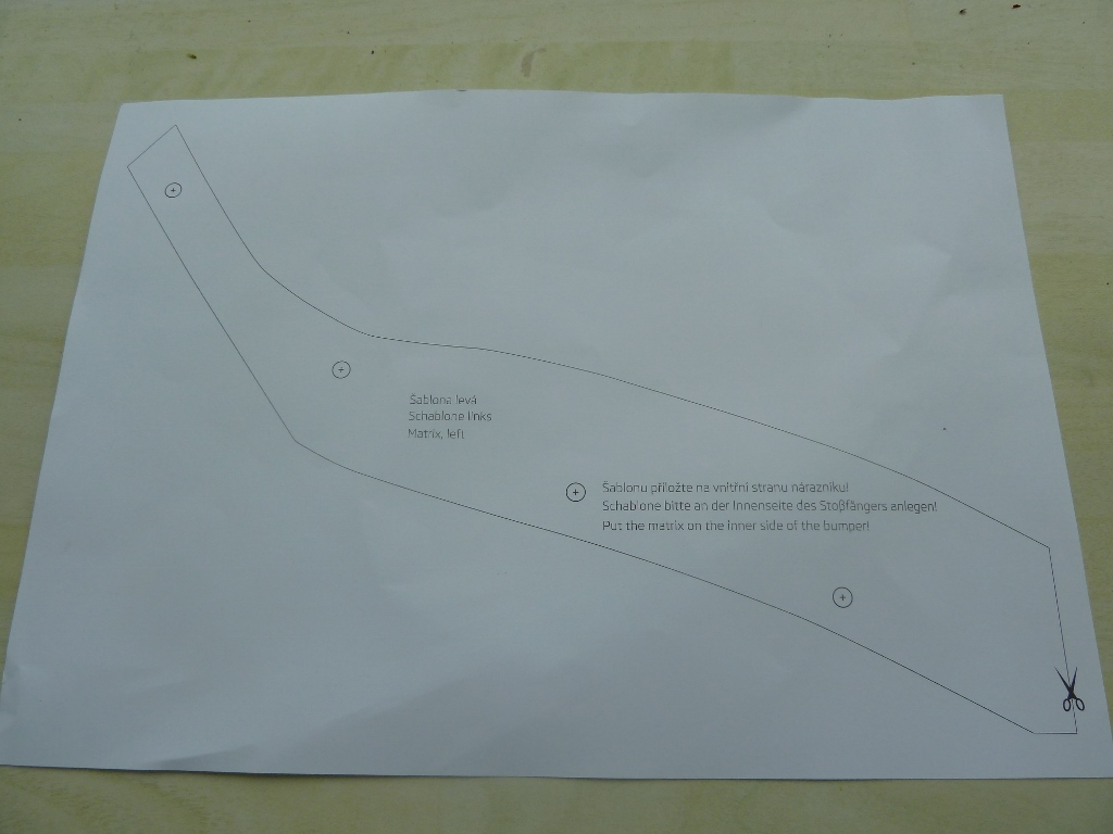

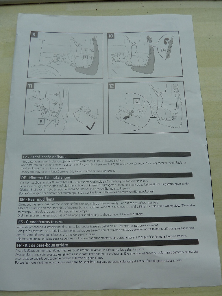

The Skoda rears are completely different & as someone has mentioned, require four holes drilling for each side in the rear bumper as they have four moulded posts & are held on by retaining washers.
They come with a paper template for drilling the holes & fitting instructions
I don't know if this is a design update or whether it's just that Skoda have a different view of how to fit mudflaps but I'm really not keen on drilling 8 holes in my rear bumper just yet.  I think mine will be going back in the bag & changed for the Up! ones.

just fitted fronts 10 minutes 6 torx screws no need to remove wheel just lock it over easy

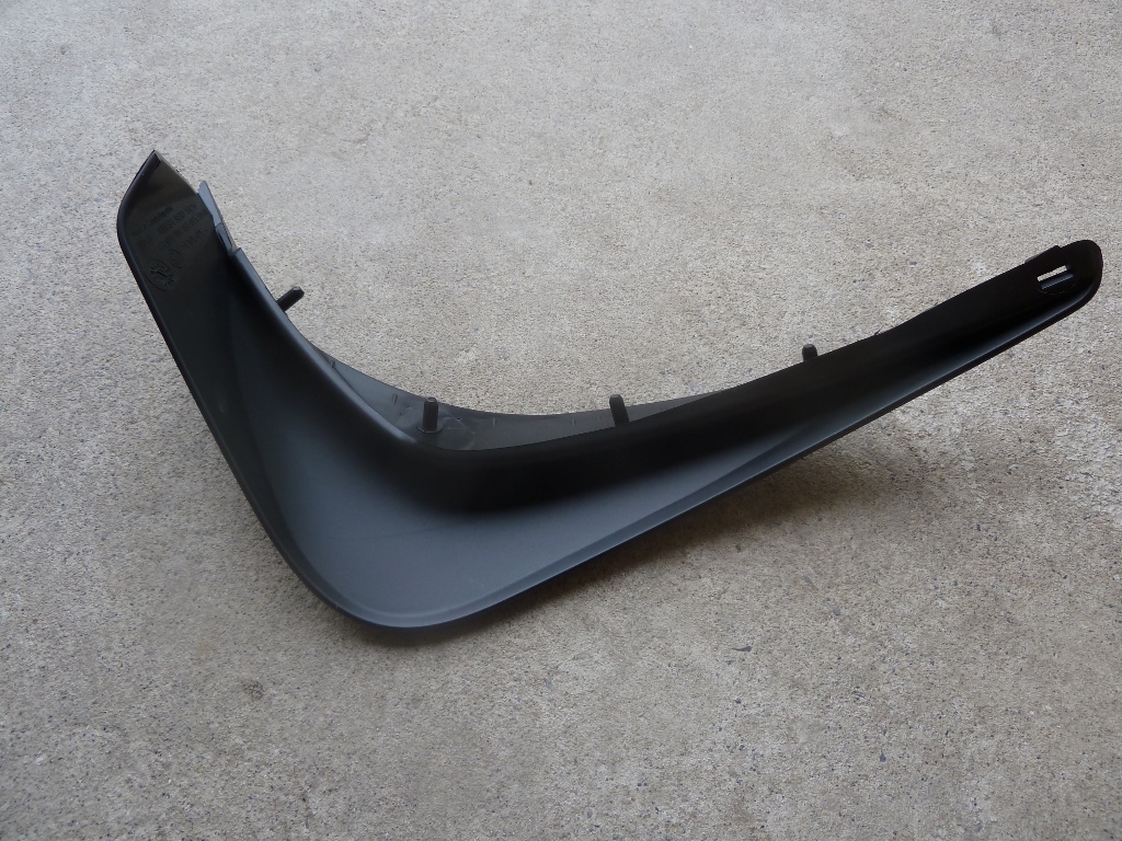

Today I fitted the rear mudflaps. I didn't want to drill holes in the body work so decided to cut the 4 plastic studs off the flap and then fit the flaps using the small clip at the top and the metal clip at the bottom. They went on easy peasy and it took about 2 minutes per side (3 if you include cleaning the area first!). Will they stay on? Don't know, but the metal clips are pretty solid and I took the car for a 9 mile round trip to the curry house at up to 50 mph and they hadn't moved when I got back. I reckon a couple of those paper clips (the ones like miniature bulldog clips without the arms) should do the trick. And if they come off then so be it! Very happy with how they fit, they are square on and line up perfectly with the wheels.
The big test will be when I go through a big puddle at speed and a wall of water hits them. Until then, they're on!
