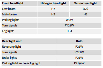

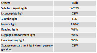

Is there a comprehensive bulb size guide for fabias on briskoda?
Does this help?
Pages 189 & 190 of the Fabia manual if anyone needs to know.

Thanks mate!

Does this help?
That's wrong.
Main beam on a Fabia with xenons is actually H7

That's wrong.
Ahh I just screenshotted the manual.
