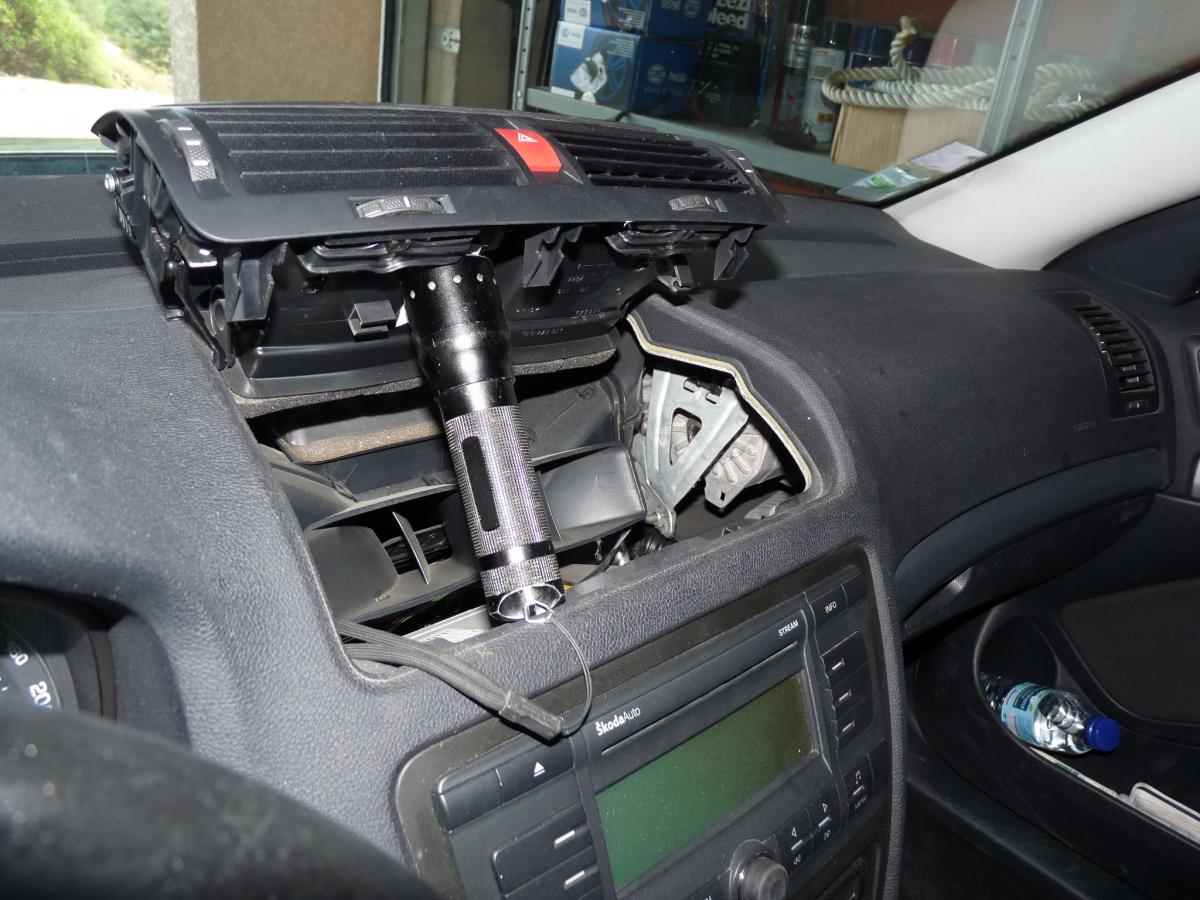

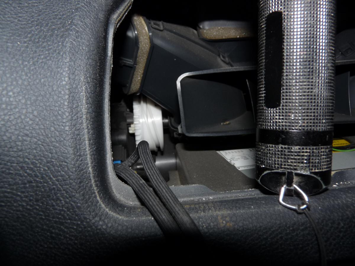

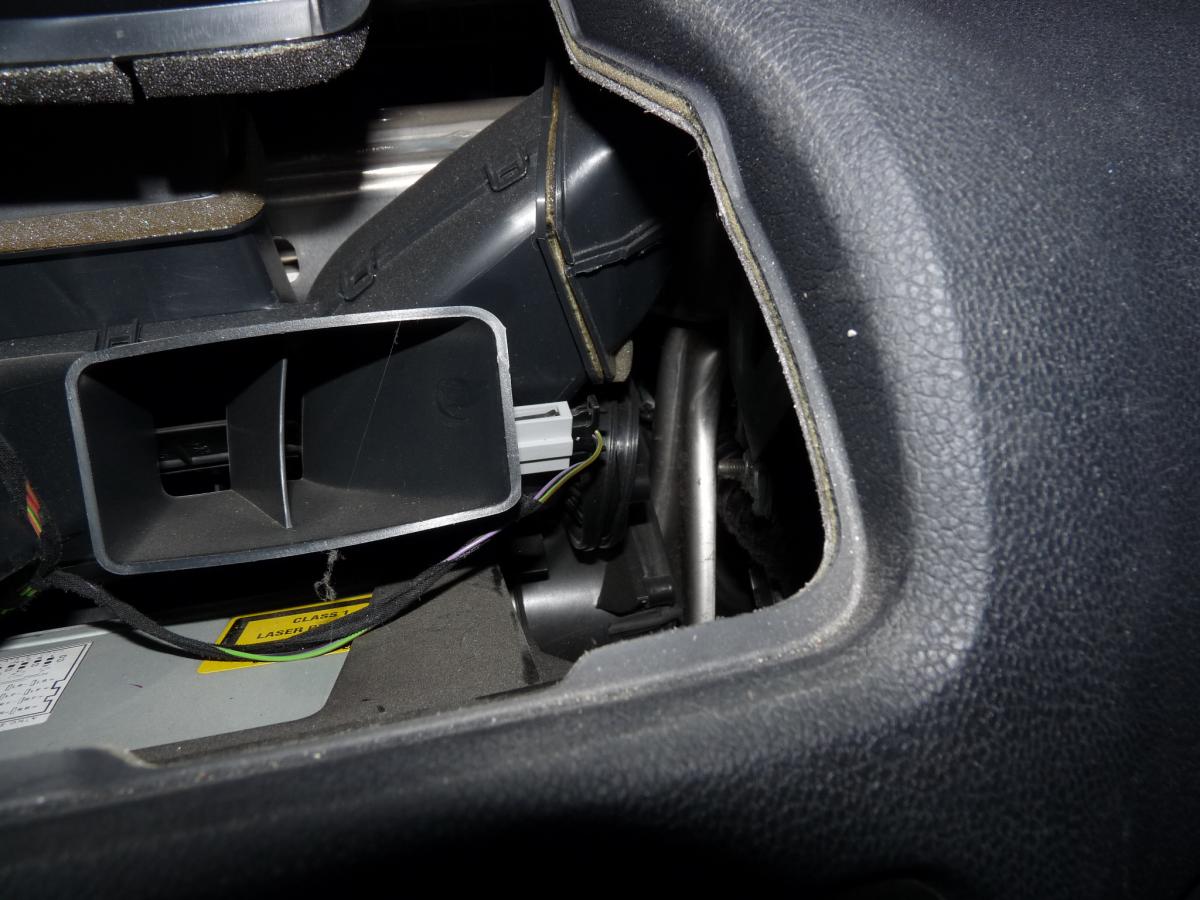

I have prized off the storage box using two flat paint scrapers and using a screwdriver between the two to prise off the box without damaging the plastic. Under the box there are indeed two sensors - but what is their purpose? . It would be best to remove the hazard warning connector to release the box completely - it is not obvious how to release it. The white sensor carrier can be made to revolve easily but I have not yet succeeding in pulling it out. There looks to be a danger of dropping the connector and it might not be easy to recover it or reconnect to a new sensor.
There are 3 pictures. A general one showing the top box propped up with a torch. One white sensor can be see protruding from behind the RH horn. A tiny bit of the other sensor can be seen behind the LH horn beside the white plastic rotor.  I should like advice on how to remove the connectors and the sensors.
I have googled the problem some more and I do not believe that either of the 2 sensors that I described above are the evaporator sensor. They are more likely to be sensing output temperature.  Other google posts suggest that it is indeed difficult to get at the evaporator sensor without removing the dash.
