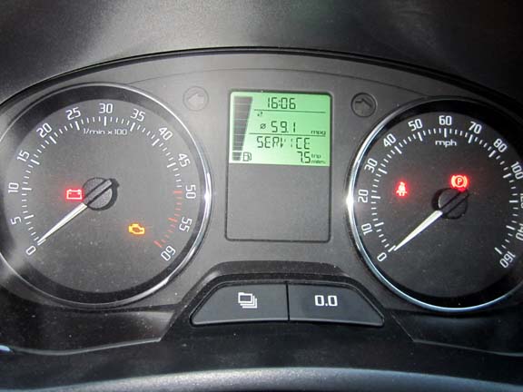

Trouble is, I seem to have a lot different dash layout to the utube clips. Mine is a Fabia 11 Greenline.
I've tried holding the odometer button in then switching on for several seconds then switching off but no joy.
As an aside I don't even have a coolant gauge on mine.
Here's my layout
Here's my layout
Have you tried to push long on the "0.0" button?
It has to do with the reset button 0.0 (right one) at the dash as irfant wrote above. I think you can reset it by pressing the reset button by pressing it for more that one seconds while the message is flashing.
Remember that by pressing the folder button (left one) at your dash you can move from clock setting to remaining time / days / miles / kilometres (in my car) then you can try to press the reset button in order to reset service interval, if I am not wrong this is able when the indicator shows <=1000 Km (in my car) remaining due to service.

Hmmm, you have the facelifted fabia, so the reset button can't be twisted.
Still, have a look in your owner's manual, which should be updated and slightly different to mine. You should be able to find this information in the instrument panel section.
Unless skoda have removed it from the manual to force people to go to garages...
Tried Stratosg' idea with the oo button but still nothing. If I press the left button then the 'total' mileage of the car comes up with no further carousel [other than the clock of course]
Page 17 of my manual recommends going to the dealer to have it done then goes on to say ***Reset the service interval displays by using the reset button 6> page 15 on the trip counter*** which is of course the oo button on the diagram on page 15. It all sounds so very simple but nothing is happening. Am I missing a sequence or what?

I really cannot understand why method one (as you called it) is not working since it's what is described in owner's manual. My question - wonder is why your dash only shows you only clock settings and total mileage by pressing the left button (with folder sign). Mine brings up a spanner sign and the remaining kilometres to service and to answer your question, no I don't think that your reset button is faulty since it resets current mileage.
My last suggestion is to make a call or take your car at your dealer's and ask them to perform the service reset operation without using their vag computer but manually.
