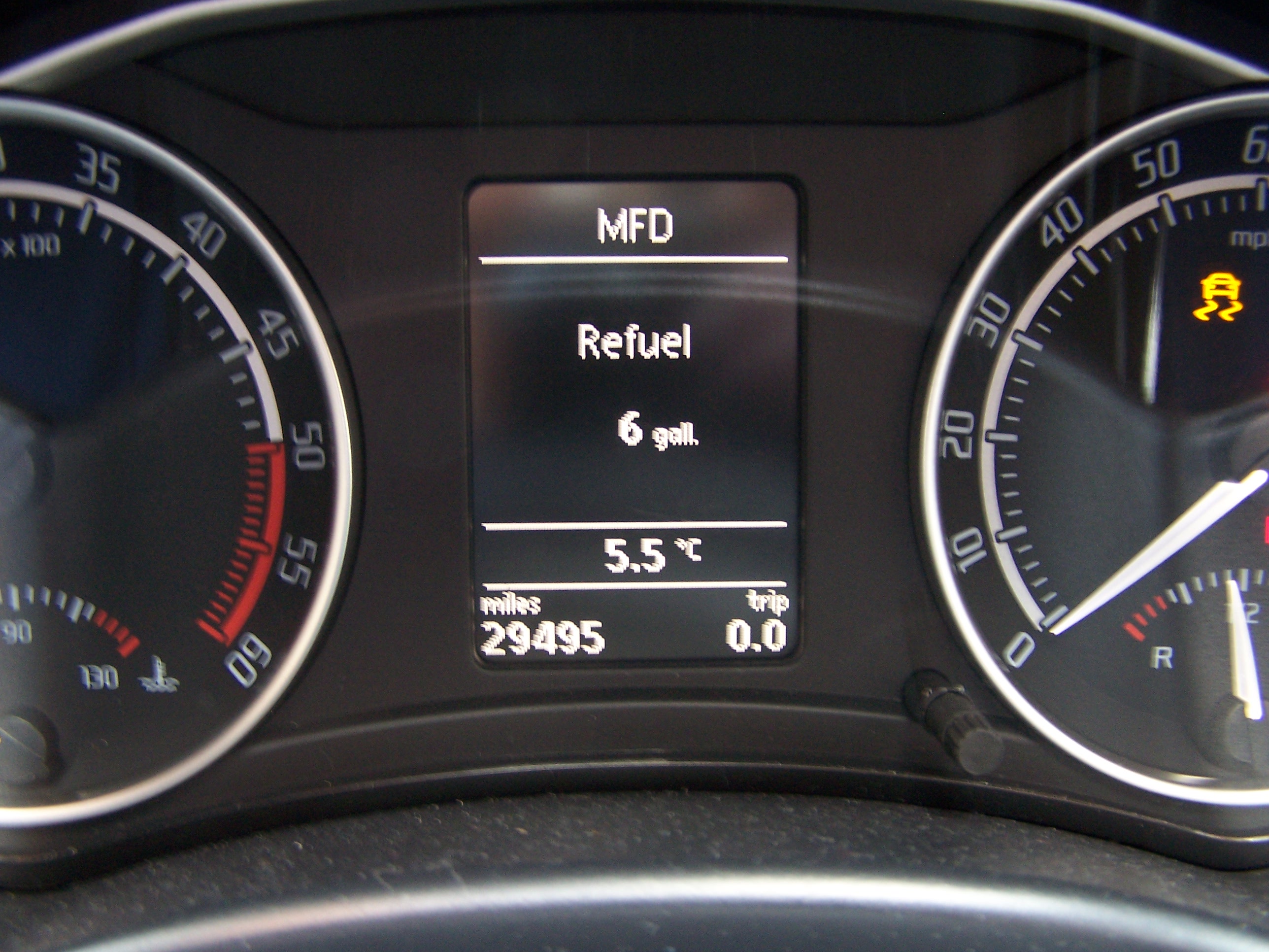

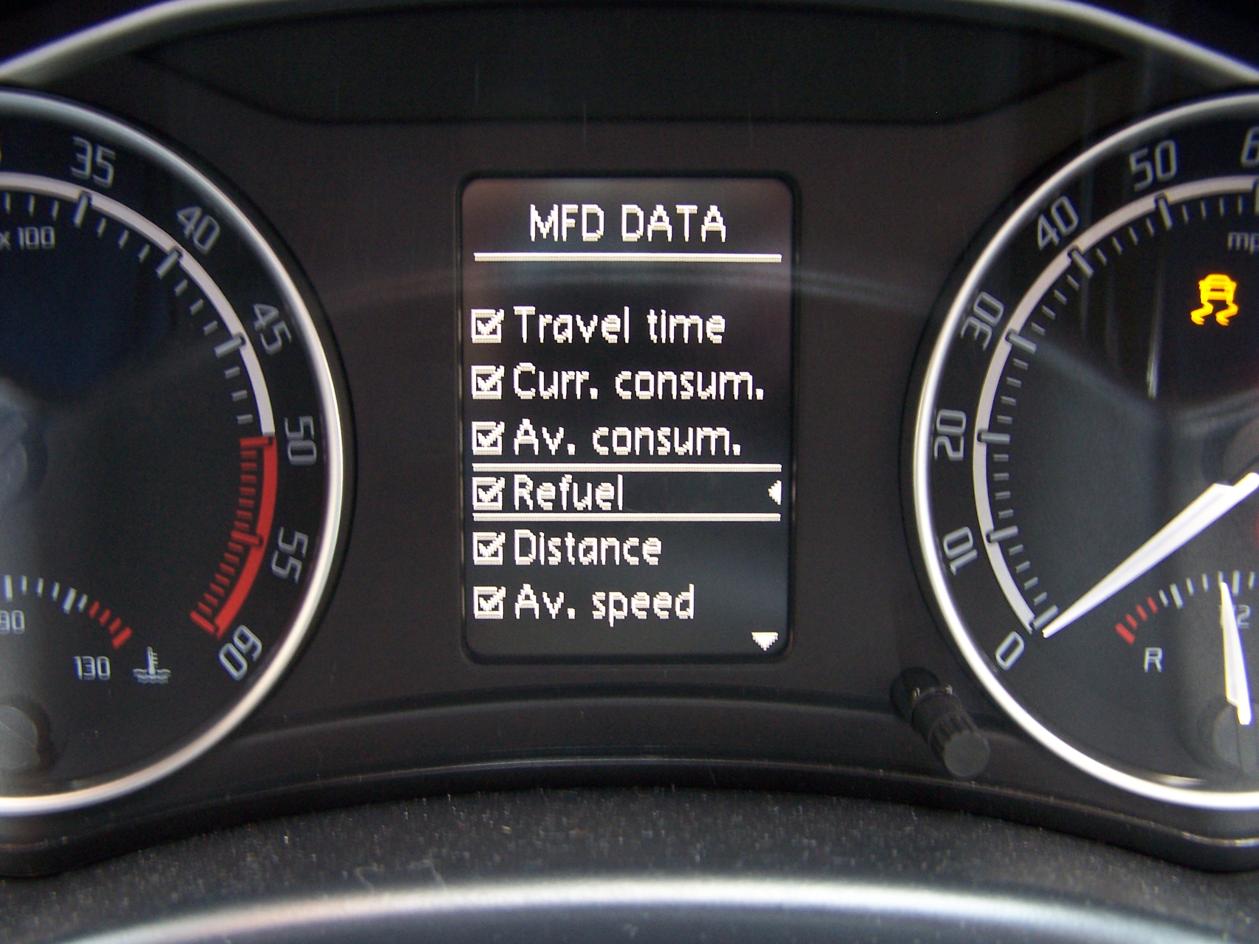

how accurate is the volume to replenish, Eddie?
fairly accurate, if you convert the units to litres it is better
Nice few tweaks there, like it :thumbup:
I have this enabled on my Tiguan, not something I check all the time but good if you need to.

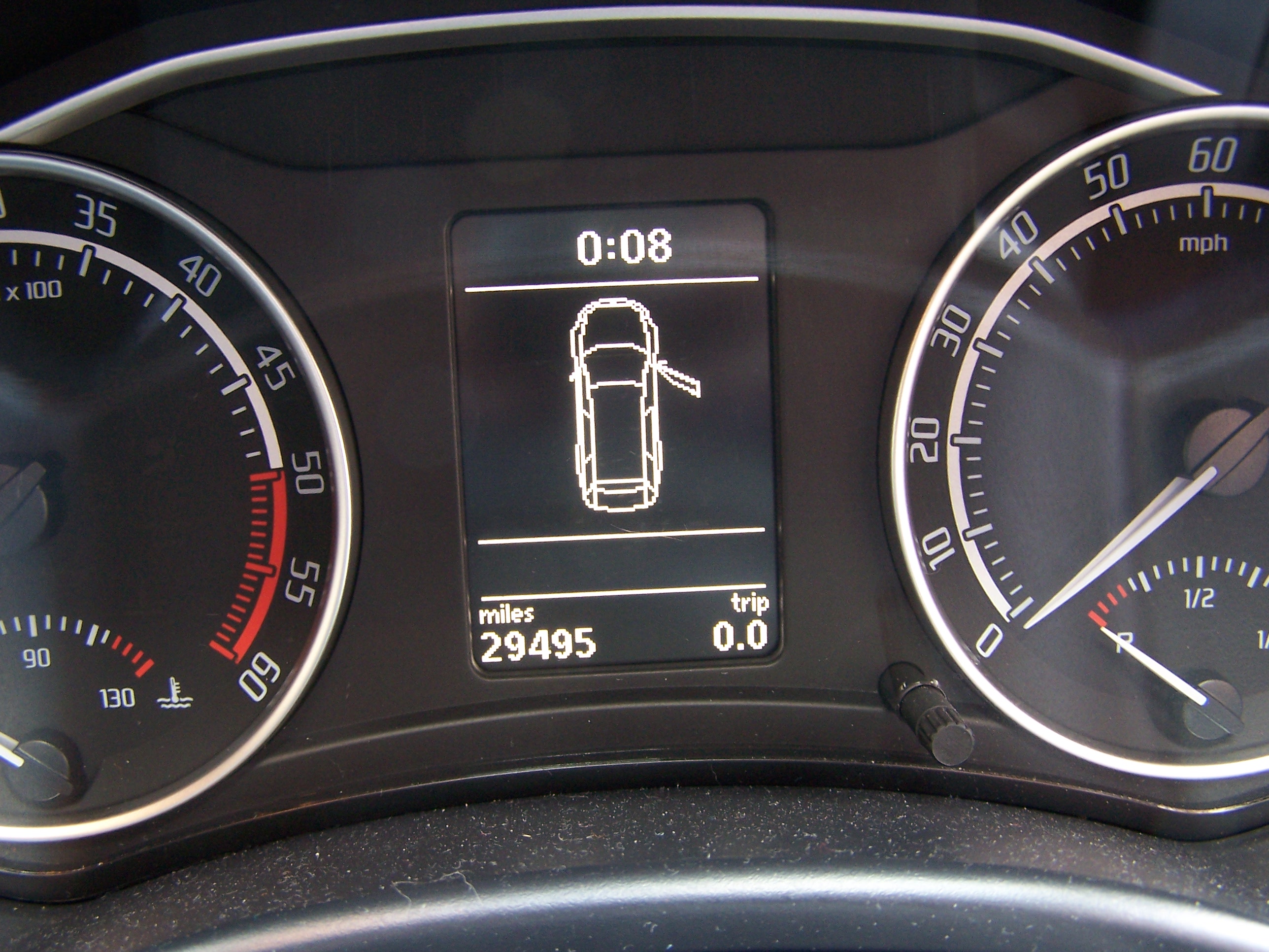

Since I had the car I thought it odd that the cluster display when the door open was displaying a Saloon / hatchback when on other vehicles in the VW range get a proper Kombi / Estate display. I managed to figure out how to change it.
How did you do that? Is it something that's possible with a pre-facelift, as it's such a little thing but really annoys me every time I look at it.
It might be possible, however the hard part is finding out what to change to get it to display what you want.
Even after trying several other variations with mine it didn't change
