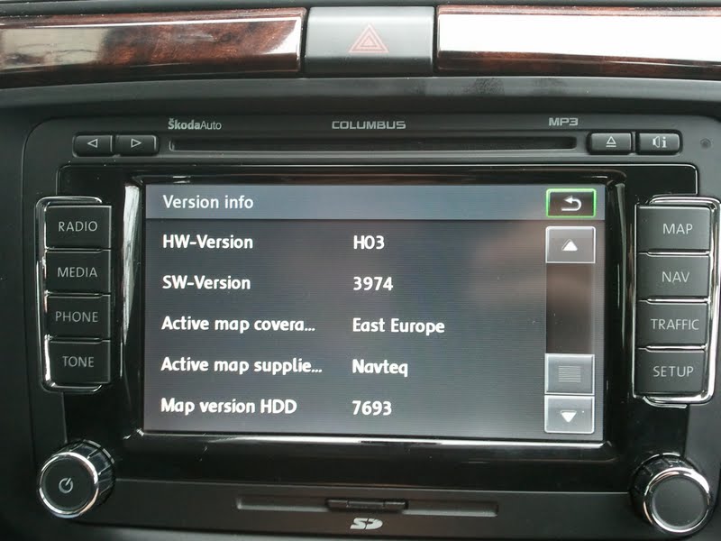

So - i bought the device, and everything so far works fine. Well, i still have to buy GPS antenna, but in sellers car it worked perfectly.
Hopefully it stays this way :)
East europ is - because i live in slovenia ..
