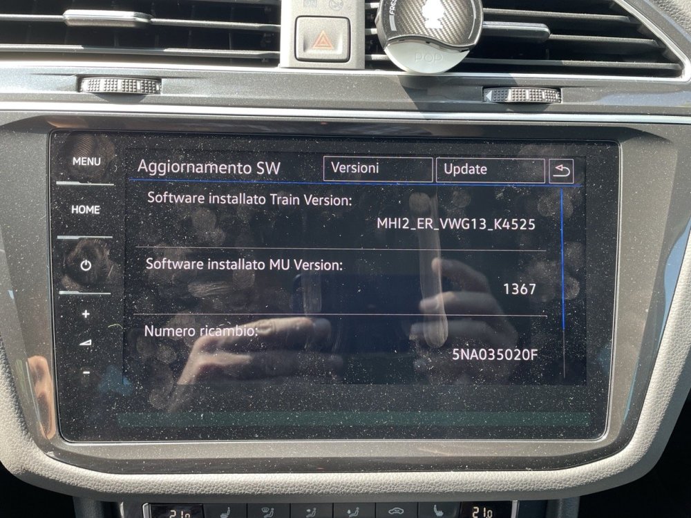

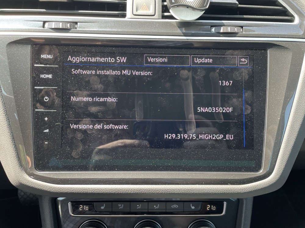

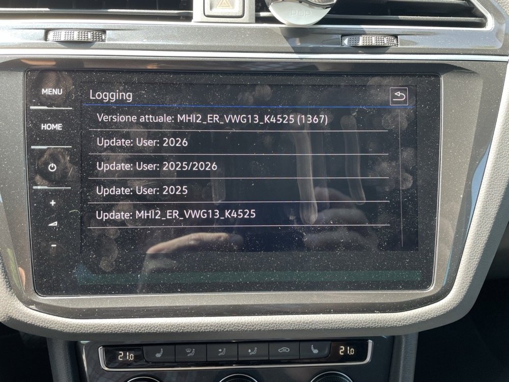

Yes quite sure is a MIB 2 H: no dial cursors but only touch buttons
I never played around with vcds or obdeleven Pro because the maps updates so far just went smooth. Download > copy to SD > Insert and apply the upgrade
Only from this one I'm experiencing this kind of troubles

Well I put your software train as per the picture into mib helper and it says it is indeed a mib2 high. Went on a search of mib2 high and 450 navigation and it gives you the second post on this thread:
https://www.briskoda.net/forums/topic/537850-columbus-map-update-2026-2027-mib2-high/#findComment-5996496
Which says it doesn't work with Seat or VW without a change in navigation FeC. This was the guy that found the file so they know what they are talking about. To get it working on a mib2 high you need to add the Skoda or Audi navigation FeC (either will do) to the end of the addFeC file that it uses.
You first install the mib2 high Mr Bonk toolkit in the green menu of an SD card. You do a back up using the commands. Then you have to look on the SD card for the file it is using with the FeCs on it. Then you add the Skoda life long navigation FeC and do the addFeC command. Reboot the unit. Check installed FeCs and you should see in addition the FeC you added. Running SWDL that F will appear as T and you are good to go. Some people had issues with deleting the back up and generated another one in the github project. You only back up once. That is what one guy was stumbling on so the addFeC menu didn't work. Difficult on posts to work out what people are actually saying but I reckon that was the issue. They tried to backup twice and found they couldn't. Other people have had success first time. The toolbox you only use once then forget about it but I did get help from the people familiar with it at the time since the module had not been written for my release, so they wrote it for me. The documentation will tell you whether your firmware is covered. Another Seat poster update the firmware to All in One (AIO) because theirs was to old, then used the toolbox to do the FeC addition. Now I'm assuming that the VW firmware is like the Seat one and can handle many navigation FeCs. Thus it tries VW navigation FeC and failing that the Skoda one you added. Mine has been working happily like this since February and prior that 5 years before why I was already setup.

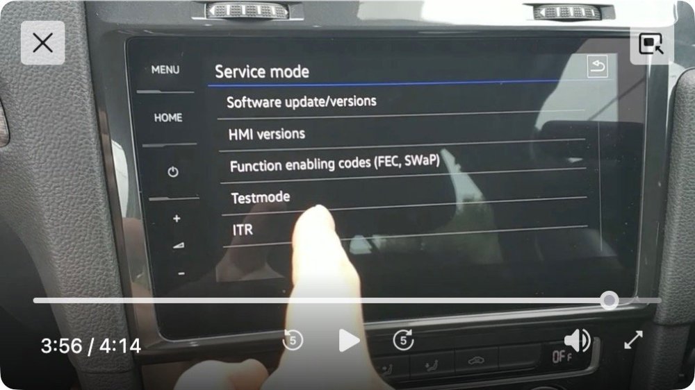

Just one question:
in this video
https://www.youtube.com/user/SEATCupranet
that shows how to install MQB toolbox I saw in the menu there's a Testmode line that I don't have in my unit.
Do you perhaps know how to enable it?

I don't think you need VCDS or Obdeleven Pro for the toolbox. There is a code clearing algorithm in it which does clear the marker for a firmware change although the unit will run happily with that "error" just a marker that the firmware is changed. So I dont bother clearing that now. If the toolbox does say clear errors before installing it ?. It would be a good idea.
I keep out of the esoteric back end screen if I can help it. The green menu where the toolbox gets installed does have some engineering screens so does the developers menu. I have turned off the sat groups in the past to see whether its using the Chinese satellites. Mine doesn't. Russian and US. New mib2 standard do. Sees over 20 mine sees about 11 max. Reasonable number but wondered what the difference was. 2016 mib2 high.
Pass on what test mode is but that's in the developers menu, not the green one where the toolbox goes. The navigation in the green menu up and down does slightly vary by whether its the older mib2 high front screen or newer. There are videos of the use of the green menu and its just slightly different key presses dependent on the layout. Put one person off.
