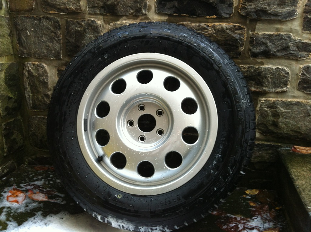

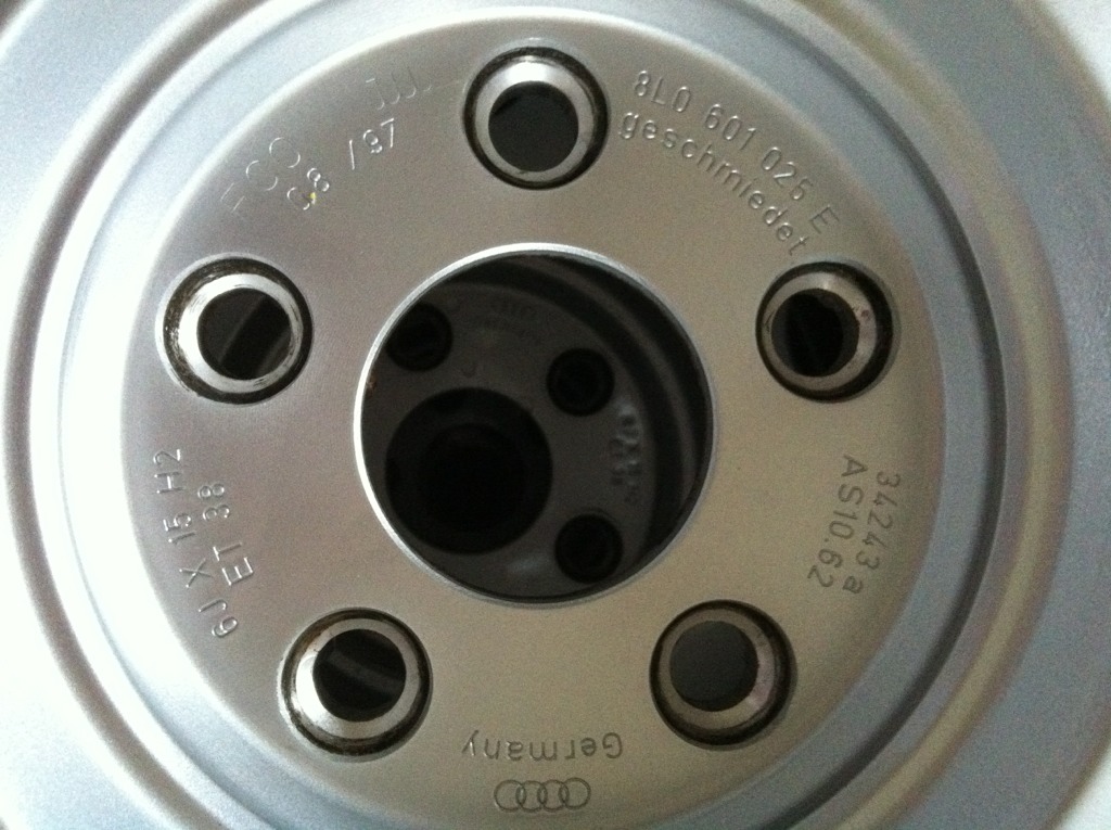

If you want some really light wheels take the 15" 'manhole cover' Audi A3 alloys. They are forged and that's why the material thickness is less then castes ones. One wheel weights only 5kg without tire. post-68575-13590261824919_thumb.jpg
Sent from my iPhone
WOW!!! Only 5kg? Now, that's impressive.
Just out of curiosity, do you know which company makes them for Audi?
Edited by FAB59
Unfortunately I didn't know that, but if you will buy these make sure that they are produced in Germany, because Audi also produced some in Eastern Europe which were about 1kg heavier.

I do use them in winter. Bought them on eBay for a good price. For track use the may be not perfect, but you will never get wheels that light for this price. They were also used on the roc buggys. ;)
