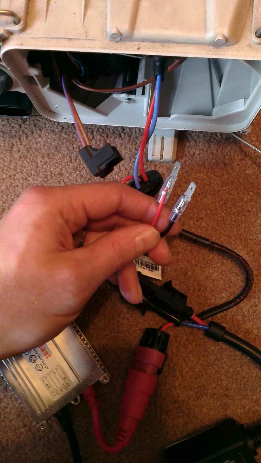

I'm assuming the black and red wires in my hand from the HID kit plug into the original black connector of the light unit? I'm meeting with a fellow Briskodian today to get in coded but need to fit it all first ahh!
