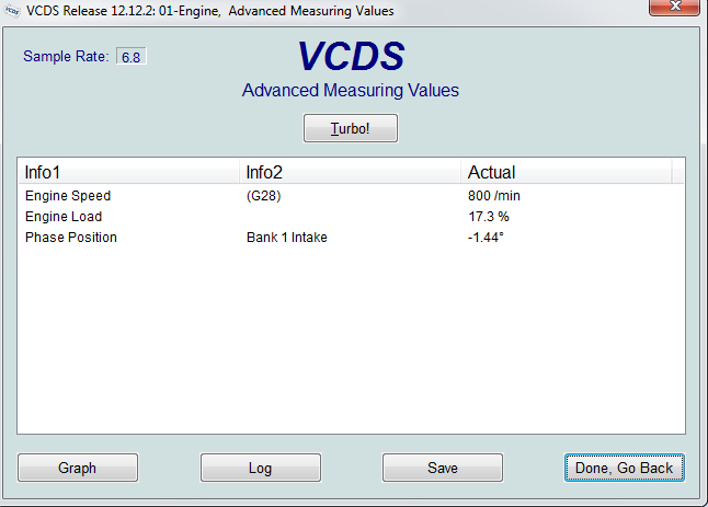

Mine is 2010. octy with CDAA engine and 37k miles on dash. VCDS block 93 is showing -1.53 so I should be fine. Later I will try to check also tensioner marks. But still, muffled taping noise from chain chamber during engine idling  bother me. Anyone else noticed noise from right engine side like chain hitting plastic tensioner guides from time to time ? And what oil do you use 5W-30 or 5W-40?
Out of curiosity I checked my car with VCDS and block 93-3 shows -1.44
All of this might give an idea of how stretched the timing chain is, but I'm not convinced it gives any clue as to whether or not the tensioner is about to fail.
Did you measure when the engine is warm? I measured after a drive and kept the engine running while i measured and it showed -2.60, i have a 35k 1.8tsi...
The correlation is not direct, but the tensioner is supposed to be more at risk of failing after 4 teeth are exposed on its piston, which means the chain has stretched somewhat - how much can be seen with this vcds measurement. So you don't need to take apart the front right wheel arch and look through the hole in the cover (the plug on the hole is to be replaced with a new one once you remove it, supposedly) to see the tensioner directly. If vcds shows 0,00 then the tensioner shouldn't possibly have 4 teeth visible.
From what I have gathered, if you only replace the tensioner, the chain will keep stretching (because it also isnt constructed so well which is why there is a newer revision available) which means that the engine has to compensate (thats what the block 93-3 measures) the difference to run optimally. So with a revised tensioner you make sure the chain will not skip and destroy the engine(which is what this topic is about), but the engine doesnt run as good(citation needed exactly how, and how relevant is this) with values less than lets say -3 and below as it does on 0,00, which is after you replace the tensioner as well as the chain (and guides).
This is my understanding of things from various information, I am not a mechanic so take this with a grain of salt...
It was warm but not red hot. VCDS was showing water temp of around 70 degrees.
