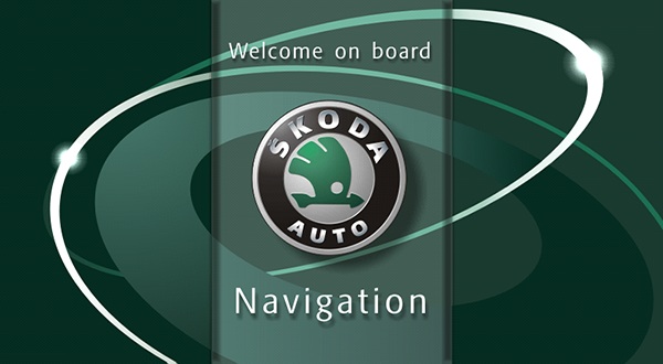

  • A bit like this... PS: If anyone really wants this for their Columbus, you are more than welcome to have it FOC.

    Worked straight off!! Very pretty-pretty.

This one is still OE looking, but different:
