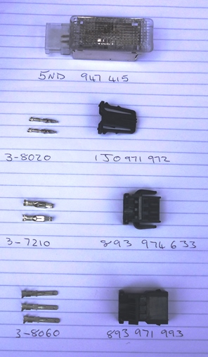

Have a look at the following link for VW/Skoda connectors and terminals. http://www.passatplus.de/umbauteile/stecker/stecker.htm
893 971 633 is the one that fits the interior light pins 3-7211 looks close to the original
893 971 993 is the FM version for above. pins 3-8060 looks close to the original
I don't like buying the terminals with the wires attached and then crimp so I have source some terminals from Vehicle Wiring Products that look the same as the VW own and I can crimp the wiresdirectly onto the terminal of my choice http://www.vehicle-wiring-products.eu/VWP-onlinestore/terminalsnonins/mouldingterms.php

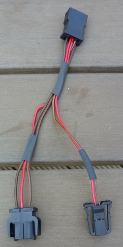

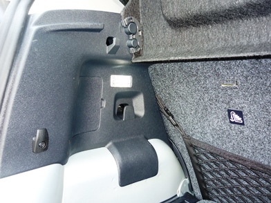

I have just completed the boot lights on my Citigo. I used a couple of Ocky boot lights that I got as a foot well kit for a Golf http://www.ebay.co.uk/itm/OEM-FOOTWELL-LIGHT-FOR-VW-GOLF-JETTA-MK5-MK6-TIGUAN-MAGOTAN-5ND-947-415-/151029585905?pt=UK_CarsParts_Vehicles_CarParts_SM&hash=item232a1097f1 (Still have two lights spare if anyone interested).

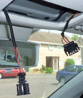

Basically I took a Red/Black and Brown/ Black wire from the front interior light and passed it down the LHS A pillar. Then down behind the bonet release and under th carpet towards the back of the car. Under the trim on the rear seat edge and into the back of the boot. I took another set of wires from the left hand side under the rear seat and up to the RHS of the boot. about 7.5m long each (with a lot of slack). the rear lights were cut into the side mouldings.
Now I hate Scotch clips and insulation tape so I found the following connectors (Skoda) and blades (Vehicle Wiring products) to make up a Y harness so no cutting of the wiring loom was necessary and if it needs to be removed no one is any wiser (apart from the holes where the boot lights would have been).
The only additional connector and blades not on the connector list needed are
Female connector (2 wire) used at the interior light end
Socket 3B0 972 712 (Skoda)
Blade to suite 3-8010 (VWP)
Cost is around £12.80 for the wires and terminals. Skoda Connectors is around £11.00 and the light set was £23.00
I did not use the original 5w bulbs. Instead i used a couple of LED bulbs which are as bright and do not create as much heat.

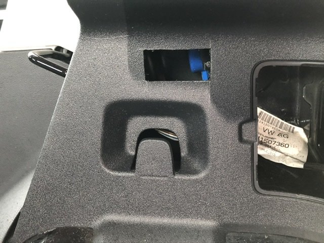

Fitted boot lights to wife’s Citigo at the weekend. Not too much of a problem. Bit of a hassle routing the cable from one side to the other under the rear seat. Really pleased with how they come out. Connected up to interior light so they come on with door opening or boot opening
