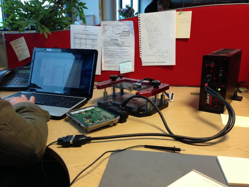

the exploit was quite simple.
the code was stored on one part of the board and then passed to the main chip everytime you switched the car on.
there was a solder point on the board which you could hook up a machine to and it would read the code as it passed to the ECU.......... it was essentially a design flaw.
this design flaw has been removed, so no its not looking good :(
see the pic here, thats the ECU open........ cant be read.
so NOBODY can remap it
Edited by Yeti-RS

Believe me, Shark were working on opened ECUs with the older encryptions on the Octavias/Golfs etc when the Fabia vRS was released we assumed it would work on my Fabia. When i arrived with mine at Shark even opening the ECU didnt allow them to map it and it took a couple months of waiting for their external party to release the latest "bypass method" to allow them to access my ECU encryption and upload a map.
Now the encryptions have changed the tuners will no doubt have to go through the same process again
Shark don't try to read the code...they slow down or stop the code reaching the ECU and load their own code onto the ECU and go from there....(this I beleive was how it was explained to me as simply as possible)
Ive been there and seen how its done personally at Shark, Jabbasport and APR on my Fabia vRS. They use the same solder point to bypass it. Now that solder point is gone, they will no doubt, just like the rest of the tuning companies, have to find a new way in. Lets be fair, if APR, who are probably the biggest VAG tuning company globally with all their money available to them cant get in, the other companies will no doubt be in the same boat temporarily.
