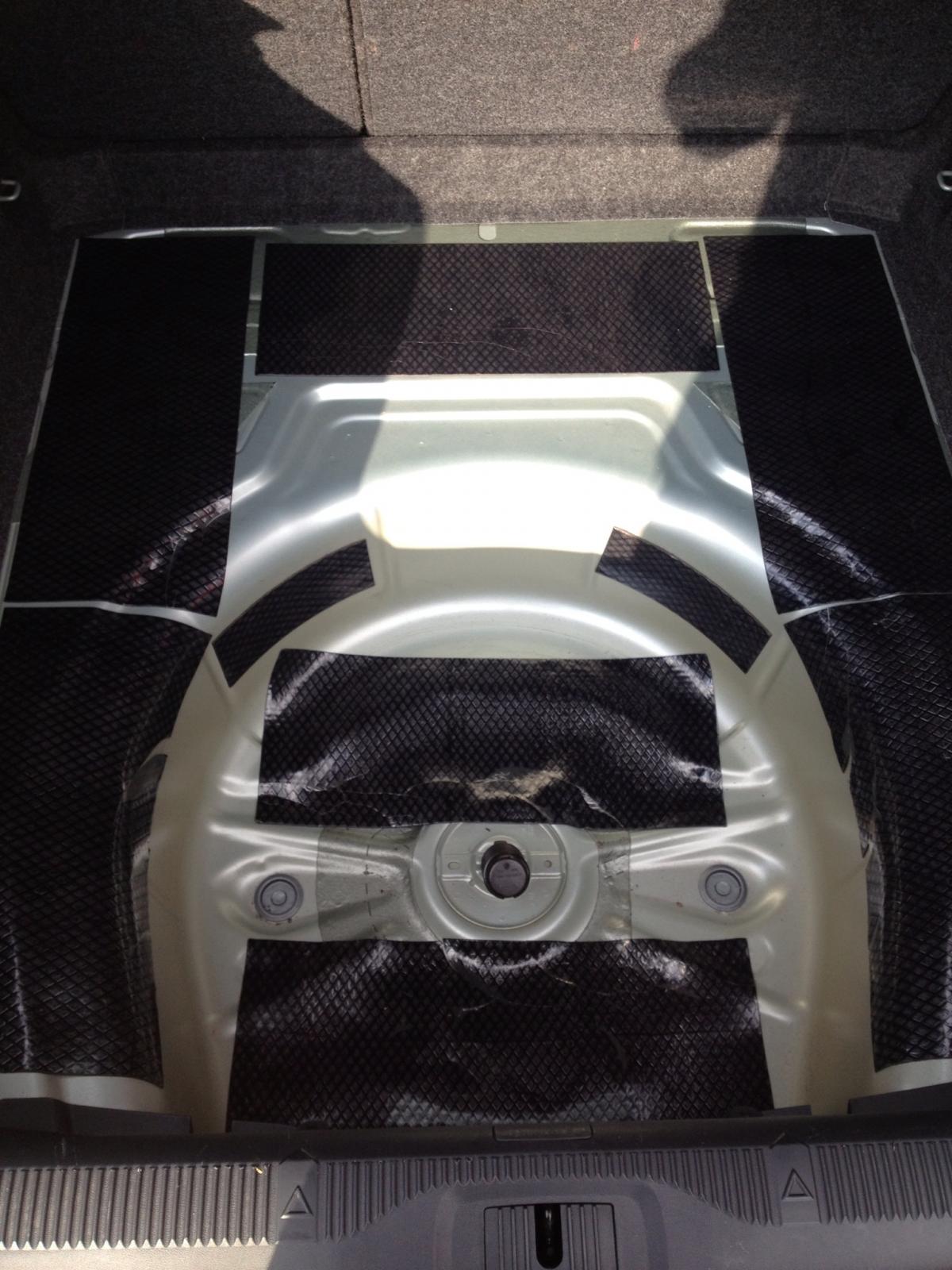

The road roar on certain surfaces was getting to me so I decided to try some sound deadening strips, designed to soak up vibrations. They were self adhesive an a piece of p@&h to fit, took 20 mins.
I stuck on the ones in the pic, plus a couple under the back seats.
The results, well they haven't made the car silent, but to my ears it's more a low rumble now, rather than a roar. At first on the test drive I was surprised at how loud they make the engine sound now, this wasn't apparent before due to the noise in the back, but the engine sounds cool so this isn't a problem.
Another pointer to how they have worked is the radio dosn't need to be up so loud now to drown out the noise.
A pack of 10 cost about £20 including P&P from eBay, not too bad for what I think has made a noticeable difference.

Good luck mate, and hope you notice a difference, I was out earlier this morning and was thinking the 20 quid was well worth the ( if not huge ) reduction in road roar, like I said earlier, its more a low rumble now rather than that annoying roar.
Got them through today. Really surprised at the weight of the package. Can't help but wonder how dense sheets of rubbery stuff can do much but we'll see.
hopefully fit sometime over the weekend.
Did it last night. Pretty much the same way as Sparticus did in his pic, I maybe lined the wheel well a bit more. Stuck a couple under the back seats too.
Very easy to do. The stuff cuts easily and is quite bendy round the lumps and bumps.
Did it work? A bit.
It's definitely taken the edge of the road noise in the car. How much? Hard to tell. I'd say 5-10% but maybe more on high pitched noises. The radio was definitely easier to hear at lower volumes.
I think if you were a bit more aggressive and put much more of the stuff in doors and under carpets it would make quite a big difference.
For £20 it's not bad.

The bigest change comes from mass damping the spare wheel well.
I've done that on the sides and base and placed a bit on the boot floor.
