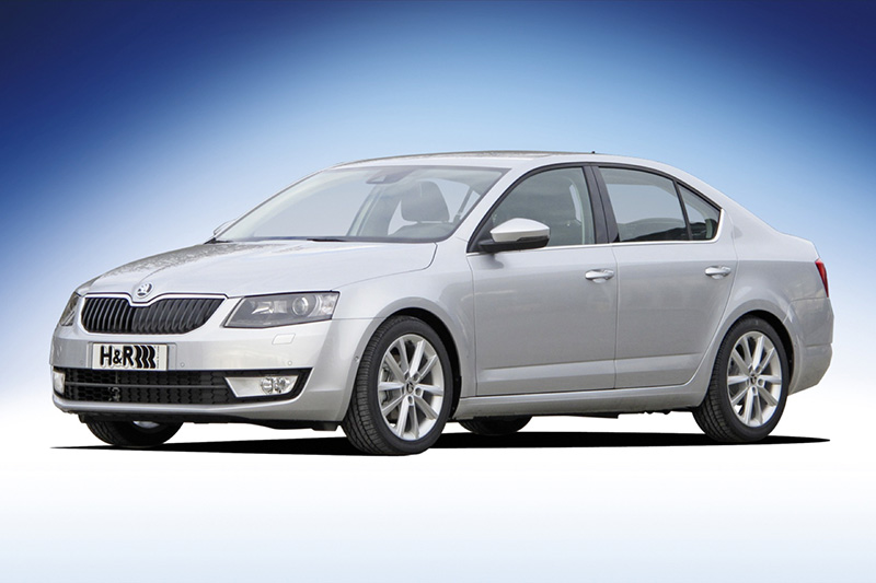

is this octy sitting 15mm's lower or lower than 15mm?:
NO that pic.is computer generated, and not a real foto. i would say that its lowered approx 40mm og that pic.
On this pic. its lowered 40mm
