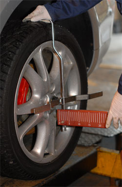

This is what was on the rears...
Then a laser on the fronts. No computer involved, just a spanner with a spanner.

The kit was called Supertracker

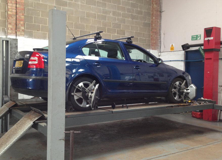

Ok so I took the car to MTMC in Tonbridge this morning (Nev's had a dead van in front of their ramp)
Proper bit of kit this time

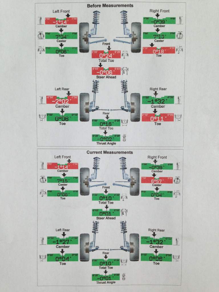

Here's the print out they gave me, they said they couldn't get it any better than this:

the lh camber won't help even though its only 14mins from tolerance its 35 mins away from the other side which will cause it to do what its doing may have a worn top mount or you need a shock
65 quid later the car is a bit better but not 100%.. The steering wheel is still sitting over to the right a bit.
65 quid and another company that doesn't know how to adjust the front camber!
You need to get that front camber evened up side to side, they need to move the subframe and rack to get it even side to side.

What would moving the subframe do? the cambers are both neg. the only way you could get the camber to move enough would be with adjustable top mounts subframes have very limited movement and normally only enough to give the caster a little tweak.
You move the subframe to even up the cambers, they both are negative but one is more negative than the other. It is the bottom arm mountings that need to be moved slightly.
