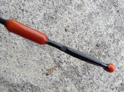

However I think I have an oil issue with mine. Noticed in the first week or two which i did about 600mi, it used 3/4ths of the dipstick. I took it back to the dealer to be checked and they made me do a 300mi test which when done they replaced the breather pipe.
I checked the oil level afterwards when i got home and the level seemed to be over the level? maybe they overfilled it? post-63152-0-64172500-1368985667_thumb.jpg
Anyhow, I have just done another 300mi and it seems to have used 1/4th of a dipstick. Is this right amount of usage for a vRS?
Any advice can someone give me? I always check the oil at 70c and do 5 dips on a flat surface. It's starting to become a right pain with taking it back all the time with time off work etc. Thanks alot!!

The dealer should have put in 3.6 litres.
When the engine is up to heat and stopped, the level should be well up the Crosshatched area, near the top.
On my car, that would be up above the Cross hatched Area when cold.
At the top Orange Marker.
(when hot, that is at the top of the Cross hatch.)
Do not overfill with oil.

George and I have chatted about this recently and I have come to these conclusions.
Dip to the manufacturer's recommendations i.e. 'hot' after stopping a 'few' minutes.
This gives you two variables i.e. what is 'hot' and what is a 'few' minutes.
So you get a reading on the dipstick and remember where it was on the hatched area, hopefully.
Then leave it over night and the next morning it will be cold and most of the oil will have drained into the sump.
Dip it and it will almost certainly read about 2-3mm above the hot reading.
So I recon if you top up the oil from a cold dip you will put less oil in to top up to the top of the hatched area, if you top up hot you will put more oil in to the top of the hatched area, with the possibility of over filling, due to the two variable mentioned above.
So I now check hot and fill from cold and check weekly. Every fill up of petrol is the recommended oil check period and this will be OK I recon.

but if you dip your oil cold, where is it on the Dipstick.?
& Where is it, if you dip it 'At operating temperature',?
which is what VW say due to a different translation in the Polo owners manual, from that of Skoda in the Fabias.
george
"but if you dip your oil cold, where is it on the Dipstick.?"
As I mentioned above; 2-3 mm higher cold than hot, so if you aim for middle to upper hatched area no danger of under or over filling.
This is working for me, as I check hot and fill from cold and check weekly.
