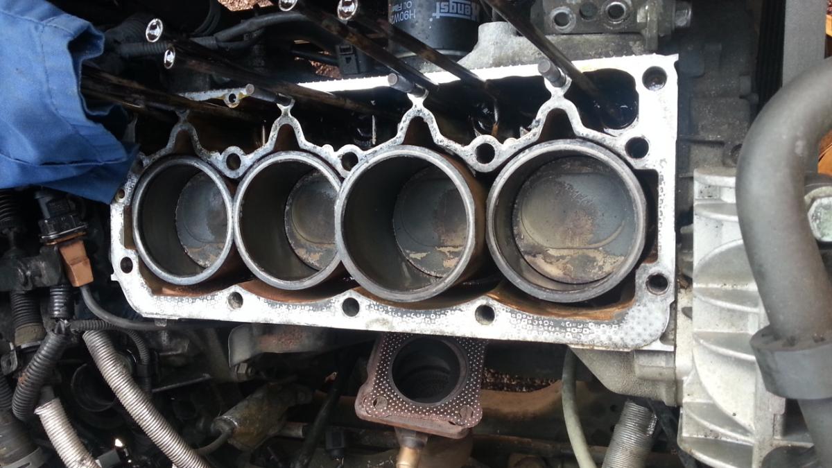

hi guys i put a post on not so long ago about how i was getting water in my oil.
had loads of replys saying it could be the head gaskets again or the condensation in the cambox.
so the engines been all took apart and we were going to send the head off to be skimmed but as my dad and other half were taking it apart they discovered that the piston sleves are moving up with the pistons.
as this happened water p***ed out the sum plug hole.
usually the sleves are ment to stay still,
the haynes manual shows two clamps to hold the liners in which we didnt have so since these have moved is the engine bugg**ed?
are the sleves actually ment to move?
the gaskets were only replaced a year and a half ago and there already being eaten away. including the rocker covere gasket as it was leaking loads?
ill add a pic of the piston sleve moving up to show you what im on about
thanks again guys i appericiate the help

I think we all know what a wet liner is. The big problem here is that your 'mechanics' didn't!
Why would you even move the crank with the head off? The clamps which you didn't use are meant to keep the liners seated and sealed.
You'll be VERY lucky to get the liners reseated and sealing properly now, so yes, the engine may be buggered unless it's stripped and rebuilt properly and there's very little chance of your Dad and partner being up to the job since they've made such a mess of the simple part.

if the liners have moved then they will need removing, block cleaning and then you will need to reseat the liners. if you have a workshop manual giving liner heights then you should be able to sort easily.

Yeah it says in the haynes manual how to reseat them might have to reseal the bottoms tho
Just need to find the feeler gauges now
But really thanks (: appericiate it I was starting to worry it was going to be ddifficult

It sounds like the issue with the loss of water and mixing with oil is indeed the liners. I'm not familiar with the engine but I would guess when the head is on and torqued down properly, this would seat and seal the liners?. Either way I'd get a rebuild priced up against a second hand engine and see what's more cost effective. Finally, it doesn't matter that the crank has been moved as you can still time the engine back up but it might have helped by not moving it and moving the liners as a result. Either way, I hope you get it sorted.

I defently need the head skimmed its pitted to hell /: and the gasket was half eaten away. When you put a straight edge on it you can see the gaps where the water would be escaping. So that will be gone to be skimmed monday properly and ill most likely be back on here in 3 or 4 days looking for help again if anything goes wrong when putting it back together

I found an engine for £600 but I think itll be cheapper to fix
As uncles has a garage if bottom of engine needs to come out
Head skimming and gaskets takes me up to £100 so depends on how much a new pistons, rings and sleve seals cost /:

You can use the old pistons but might aswell replace the rings using a cylinder compressor to get them back in the liners. Make sure you get the liners out and clean the faces where they seal and also the bottom end clean aswell. You need all the crap gone to seal then properly.

to reseat the liners properly is quite a skilled task, you need to measure the projection height with feeler blades and select the correct thickness base seals to compensate, it's ok to re-use your liners and pistons and even the rings so long as they aren't scored or damaged, it's also worth getting a machinist with a internal micrometer or a bore guage to check them for ovality too, the last thing you want is to reasseble it only to find that the gasket blowing has distorted the liner.. it's not an impossible task but everything needs to be absolutely spotlessly clean and you just need big brass shiney balls too :angel:

Quick tip for the OP- ring compression tool - if none, try a drain pipe clip - and if replacing the rings, use an old one( ring) to clean out the piston of crud .
