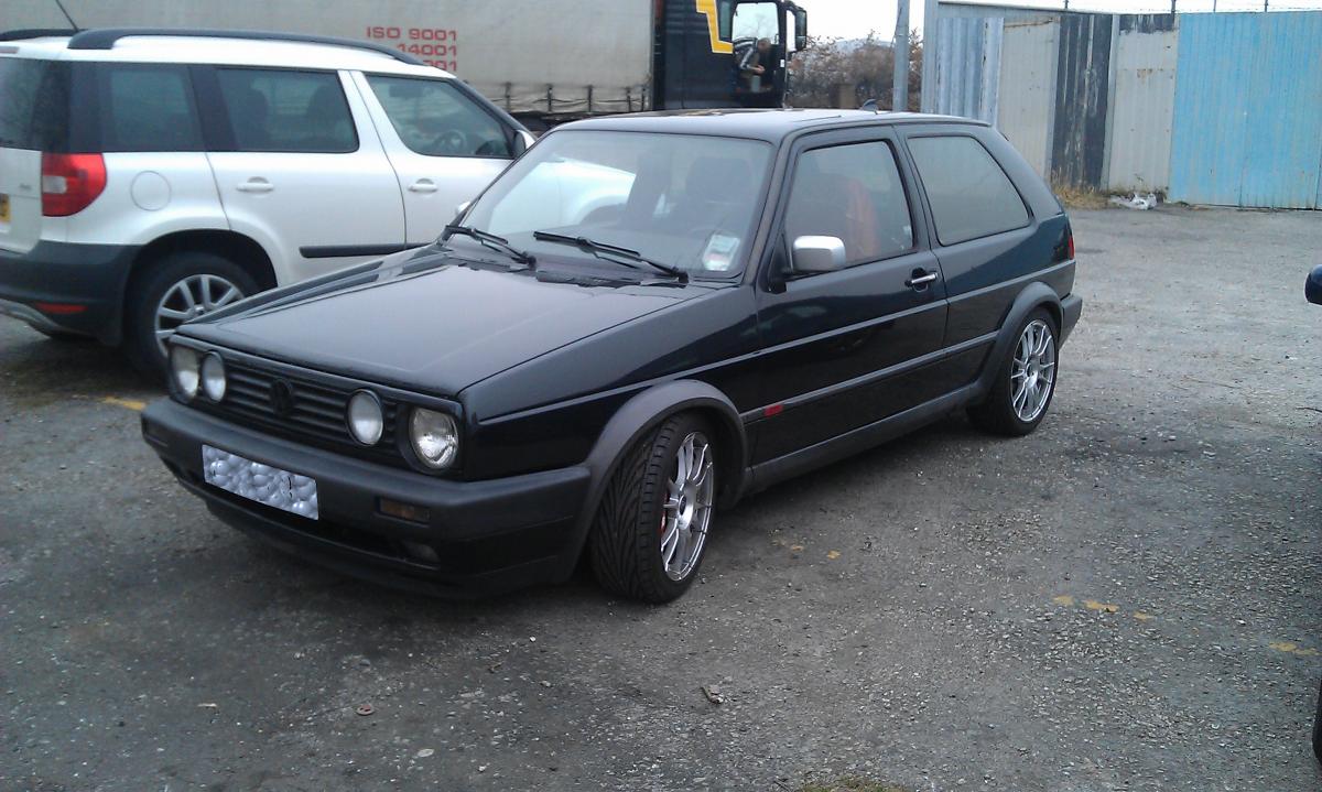

Front wheel drive mate, has a limited slip diff in there too, car looks stock, so the ultimate sleeper.
Oh I see, just my good friend has a 2.8 24v v6 turbo mk2 synchro, o2m 6speed with Haldex 4x4 too, best 1/4 so far is 12.3 seconds.
Anything over 200bhp fwd is not really usable! Hence why we have gone 4motion now, you too ;)
