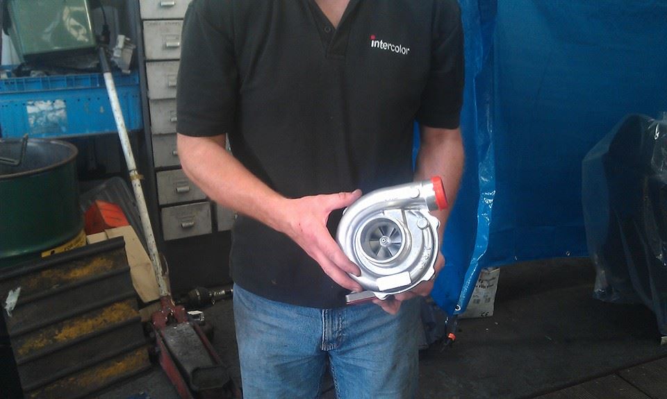

It is a T4 from China, apart from that I don't know, it is huge compared to what I was expecting.  I will pictures soon, not been at the garage yet.
Cool, had a few Chinese turbos before the holsets, they work well
for the money they look very good... as they are cheap it means it will be easy to buy a few of differing characteristics to see what combo gives the best power delivery.  I will end up with a shelf in the garage that will look like a snail colony   :happy:
I ran a t3t4 .63ar exhaust .50 comp housing on mine for a bit, good for around 330-350 bhp, really likes a bigger turbo though, that's when they really come alive!
talking foreign to me now, I think you keep forgetting I am new to this, I will have to read a book on all the numbers of turbos
here is a picture of the turbo as requested, modelled by me  :happy:
Cool, that to me looks like a .50 ar compressor, probably mated to a .63 ar T3 exhaust, same as the one I just took off my 2.0.
