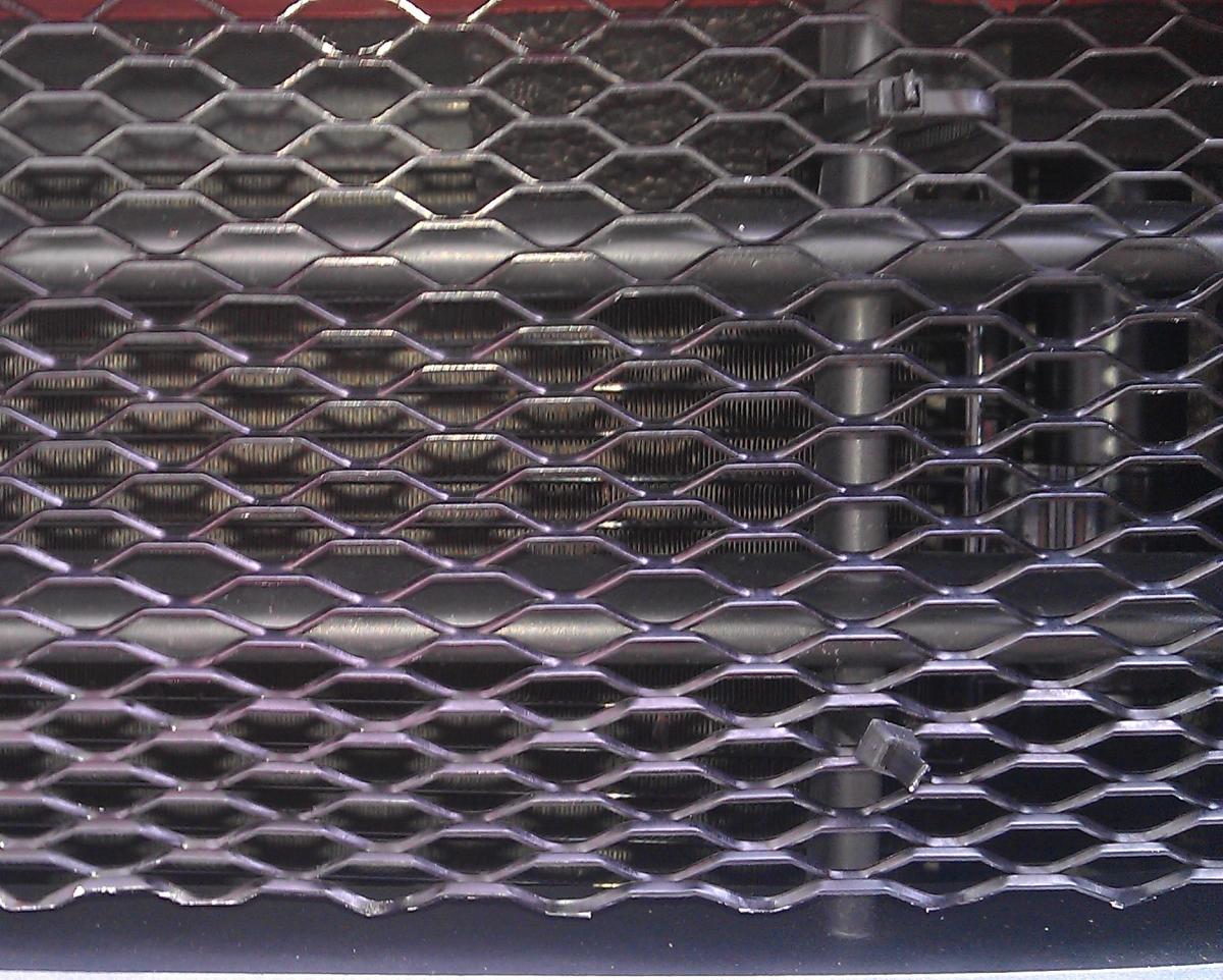

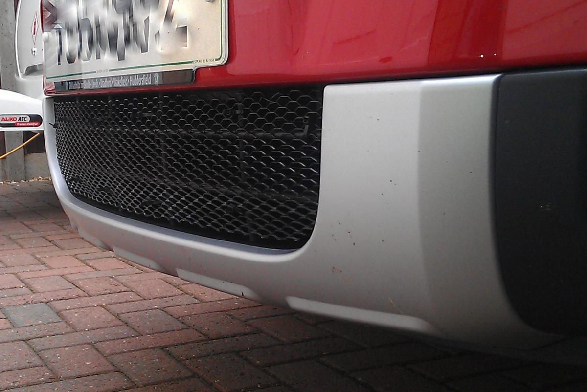

I've now fitted a grill.  Bought a sheet of black expanded anodised aluminium from the local motor spares shop for £20.  It's probably enough to do the job 3 times.  I didn't make a very good job of lining up the cable ties with the holes so I may refix in time.  However I thought I'd see how it works first.  I've left the ties a bit long until I know if it's OK.  Pictures attached.
Looks good apart from the wire ties, perhaps you could add some clips similar to what 33q (Nigel) has done on his. I once had a similar thing happen to my radiator on a Granada back in the 1980's, touch wood the only time it has happened. I think is is purely just bad luck and do not see it as an Achilles heal of the Yeti.  If so I am sure something would have been done about it by now
