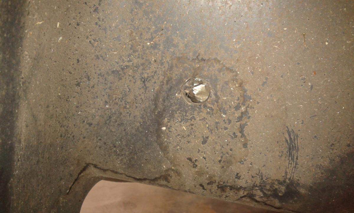

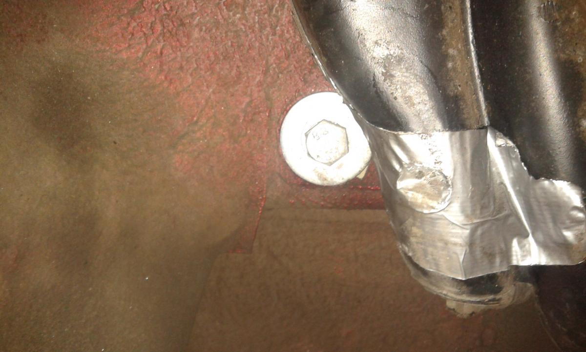

I'm after some advice. I've just had to have a new fuel tank fitted on my 2007 Roomie. I filled it quite full the other day and it started to spill out onto the forecourt! Anyway, under investigation, turns out a hole has been drilled into the fuel tank- a breathable bit? I'm assuming this is like an overflow. I have photos of the damage. My mechanic (a neighbour, who I trust) said it must have been done when the towbar was fitted a year ago, worse still be covered with gaffer tape!

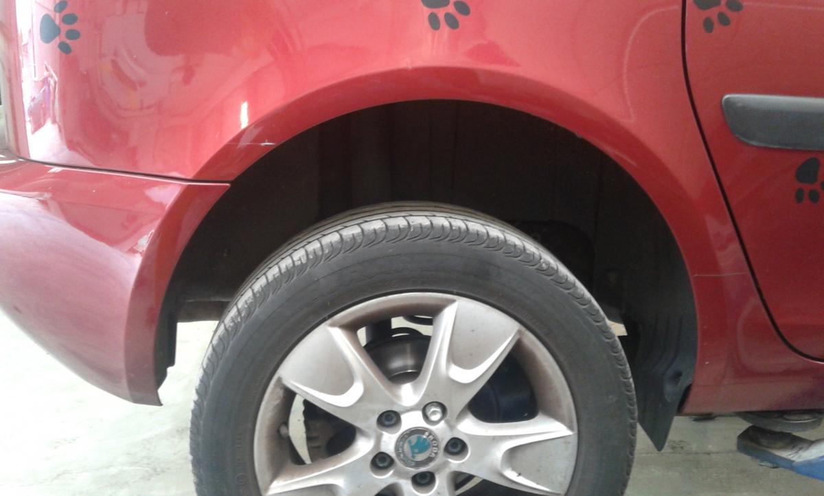

It difficult to comment without being able to work out where the pictures are in relation to the car.
The fist pic in the 2nd post looks has someone drilled through the arch liner, through the body work (red in the pic in the 1st post and 2nd pic in 2nd post) and into the fuel tank?
I'm pretty sure that gaffer tape over a hole means that nothing other than someone with a drill has caused this :D

We did wonder this, but we rarely fill the tank up to full, and the hole is not in the main fuel bit, but the 'breathable' bit- does that make sense? The hole has gone in through the back wheel arch liner and then into the fuel tank- I have a piece of it cut off in the car.

well that actually looks like half a drill bit stuck in that hole.
i would say that has been done a matter of weeks ago rather than a year, the surrounding metal is still clean, after a year there would be build up of surface rust from a drilled hole in a steel body panel where it is exposed to moisture and air, the edges of that are too clean for it to be a year old.. i reckon some scallywag has tried to empty your fuel tank for you
