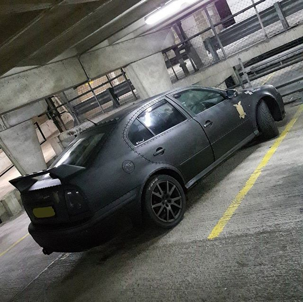

So, to this weekend. I have spent hour upon hour prepping and restoring the car in order to prevent it rotting.
First I started by sanding the whole thing down, using Kurust to remove all the rust from the car. It was really sad seeing how much damage there was, but thankfully I think I've caught it just in time before any major problems occurred:
Having done that, I then cleaned the surface and masked off all the whole car, as well as filling the damage with filler and then priming damaged areas:
Rattle cans would have given the car a smoother finish, but the cost (and hassle) was ridiculous. I've done a lot of reading up on "rollering" vehicles and decided I would give it a go. Even though it's not going to produce a showroom result, the examples I'd seen on the internet were enough to convince me that it would turn out ok and at least provide the car with protection against the elements. Plus, being a former TA soldier, it kind of brought back a few memories of the old Land Rover Defender 90/110 vehicles I used to ride in :devil:
Risky, but I was thinking more about rust prevention than a showroom finish.
After 3 coats and a lot of sanding down, the end result has been pretty good - a few bubbles, patches and streaks, but still a pretty damn good finish considering:
I've still got a few bits to touch up, but after that I'll be putting it back together - once I've done so I'll stick up some more pictures for you to look at. All in all, a pretty successful outcome :)
Well here we have it, all put back together again...
A little rough and patchy in places, but I think it adds to it's charm. A few bits of touching up to do, then onto re-furbing the alloys! :)

Well I've gone with white, simply because The Punisher is purely a black/white thing. I'm literally waiting for the paint to dry and it'll be done.
I need to get my hands on a Punisher skull stencil - might have to get this custom made. I was going to use vinyl but I think it'll look much better painted on.
As for the bodywork paint - the black is now "settling in" and has lost some of its shine (as I was hoping) so the effect is a bit more matte now.
I'm hoping the end result will be something like this:
...though things are always subject to change :bandit:

Well the paint has dried on the other stencil and it came out brilliantly - it's come out readable, but a little rough round the edges, so perfect result.
There's been more rain, sun, rain, sun... so the paintwork is really weathering now - it's maintained a little bit of shine, but has really flattened out so I'm a happy bunny.
