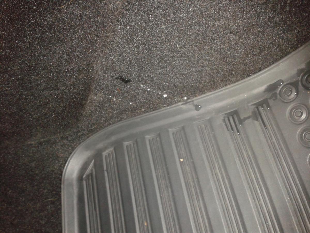

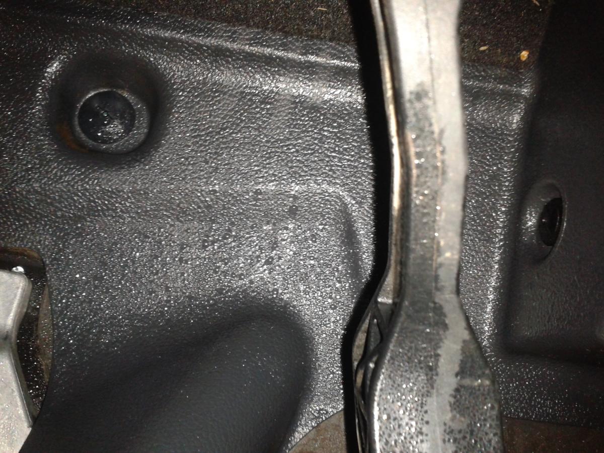

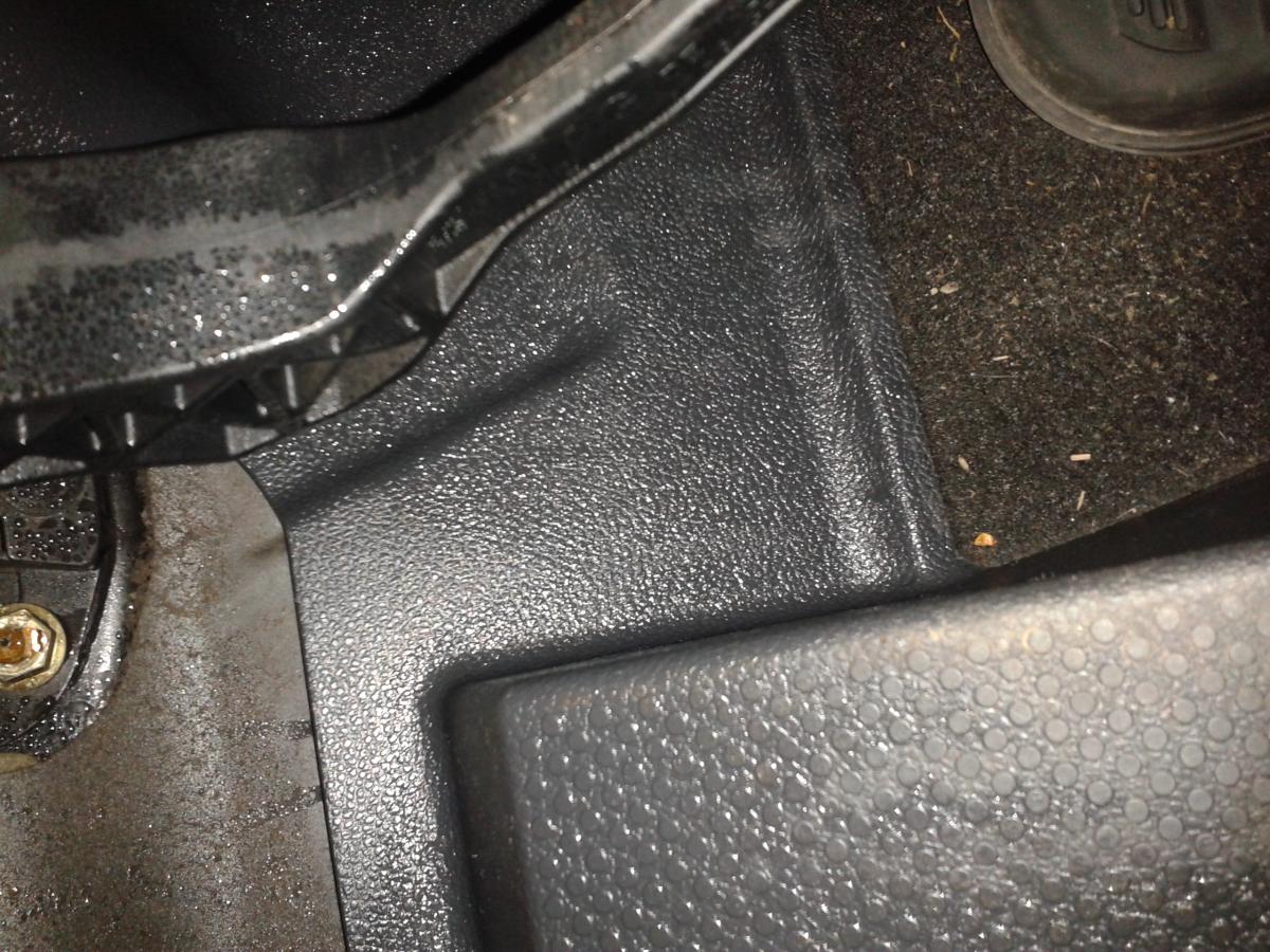

Please help!!! My fathers 2006 skoda octavia has water building up in the front passanger footwell. Sorry I know this topic has been propbably covered, but this has been hell for the last year. With many a visit to the loacl garage. They say they have checked the pollen filer and drain holes.

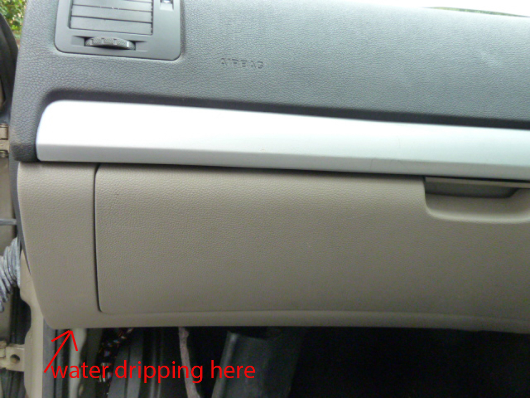

I've noticed water dripping down the side of the glove box.

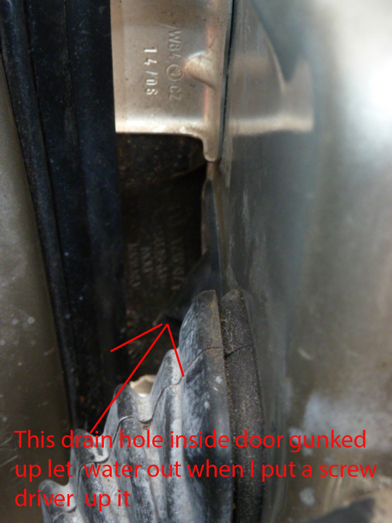

One of the inside door rubber drain bungs seamed a little gunked up and water came out when a screw driver was pushed into it a couple of minutes ago (since coming back from the garage). Please have a look at the photos thanks....

That might be the drain for the sunroof - does it have a sunroof?? - in which case the water could have been overflowing the sunroof and travelling down the 'A' pillar before appearing where you see it near the glovebox.  If the car has a sunroof park it on the level, open the sunroof and pour some water in - you should see it appear on both sides of the car.
I've noticed water dripping down the side of the glove box (see picture).
One rubber drain bungs inbetween the hinges on front pqassanger footwell seamed a little gunked up and water came out when a screw driver was pushed into it a couple of minutes ago. Please have a look at the photo.
