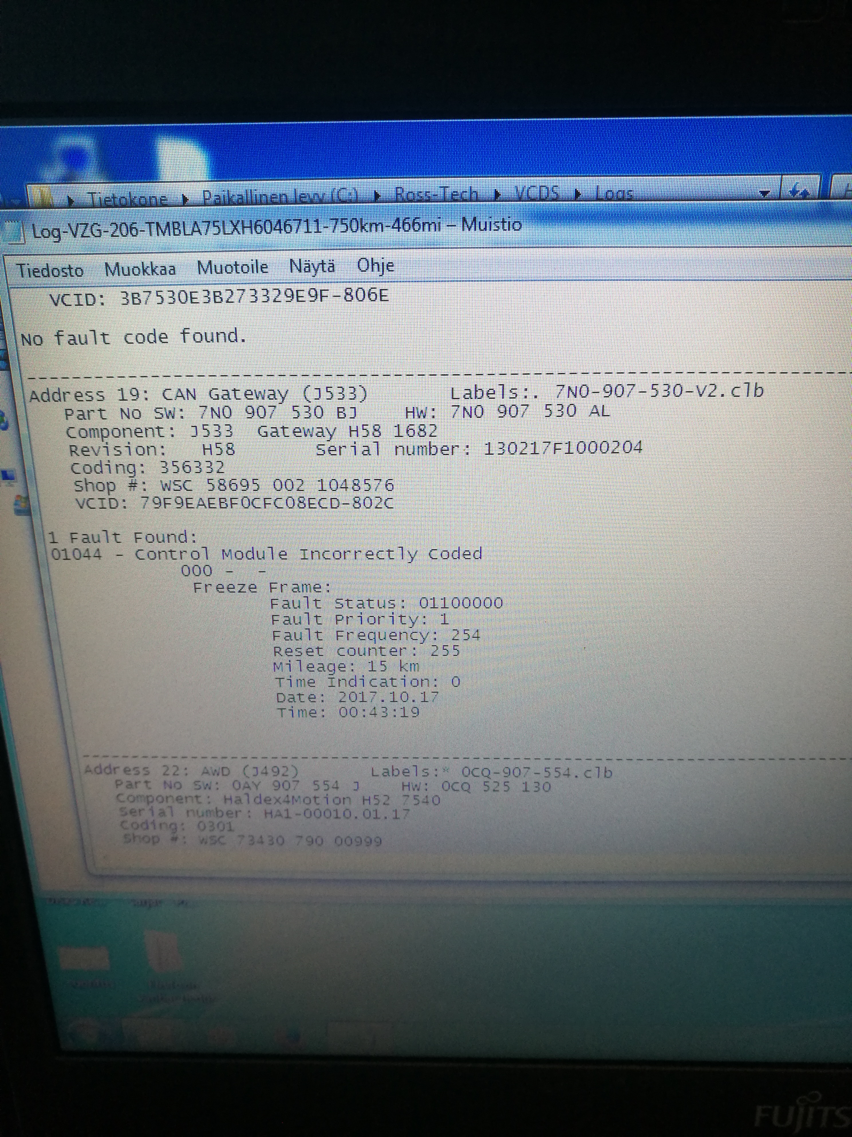

I checked the car today with VCDS. It had this fault code about wrong coding, so I didn't do any tests or changes.
I think we will have to check it at service, before I try to do anything. Car had changed automatic door locking settings back on (ticks on mfd) by itself and drove it's windows down once when sitting into the car. So maybe this wrong coding from service could do this...
Edited by Mkin
Primature sending first :)
@Mkin - post a full autoscan?
As a text file not a picture...
