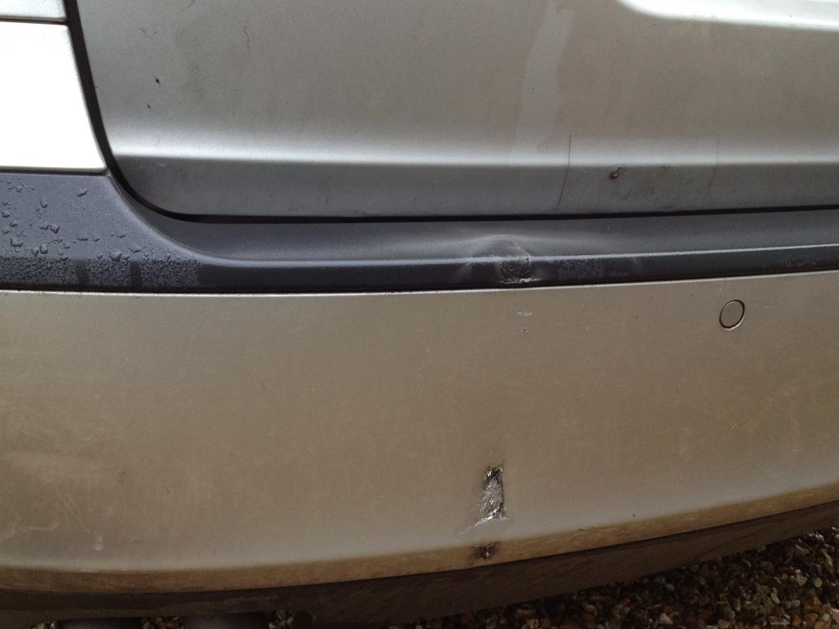

What a tit, managed to reverse into a bollard yesterday evening, I suspect it requires a new bumper skin?

You'll probably find that it could be decreased using a heat gun and then skimmed with filler

From my previous experience if it does not  look that bad then leave it alone
Unless you can do a factory job, then a simple repair it may alert buyers that something much worse happened?
I had this problem with my Audi TT... a small scuff to the front bumper, local garage did not do a good job
When I tried to sell all buyers thought it been involved in a serious crash!!
Just an idea?
+1. Try using flat edge (metal ruler) from behind bumper cover in the crease line when heating to help push out damaged area. Don't have heat gun too close though or you may damage the paint - just enough heat to give some elasticity to the plastic should be enough to remove the majority of the indentation.
Thanks. I'm not going to try this myself, rather someone else do it so has done it before, but at least I might not have to cough up £100s to hide it.

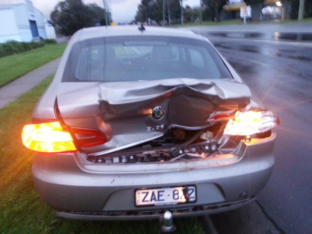

Wow. Something's done some damage there!
