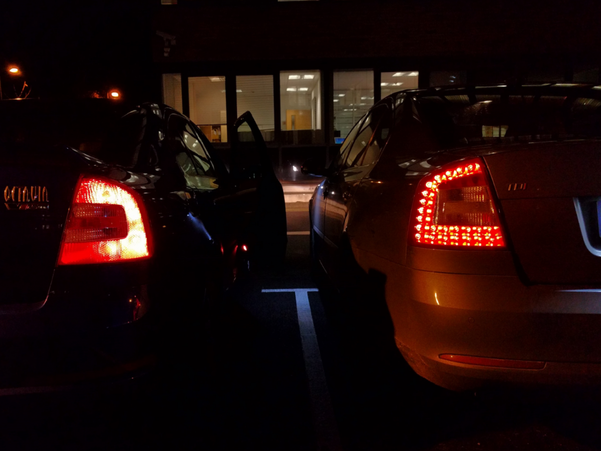

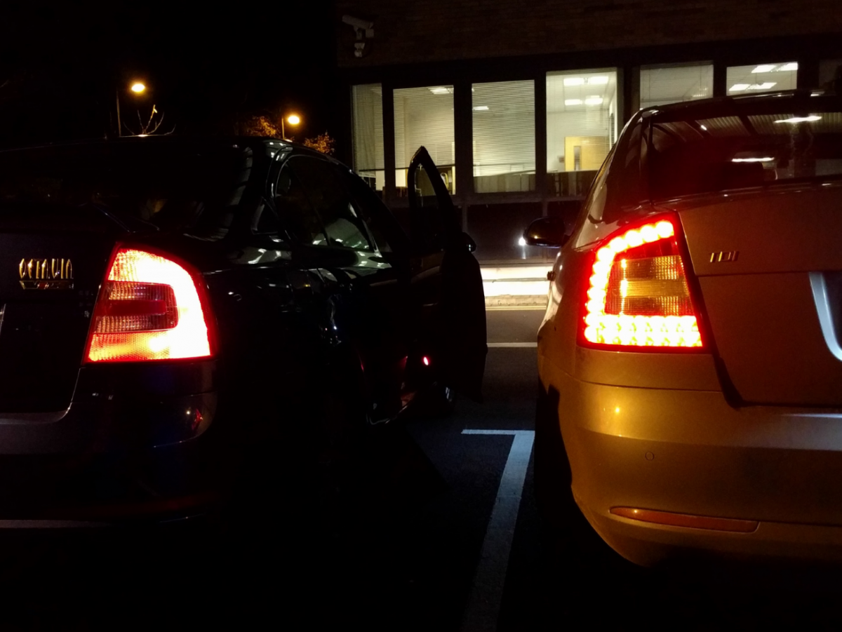

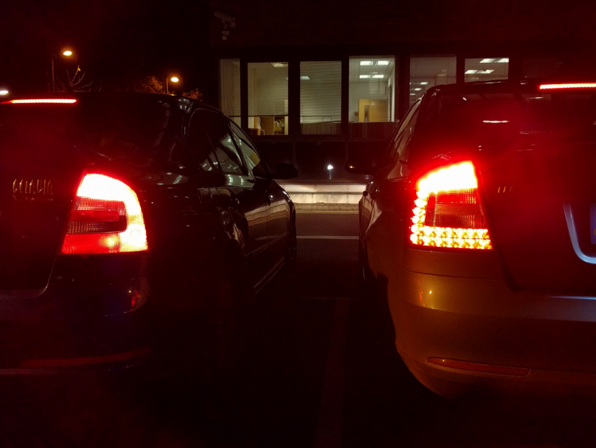

Had a chance to take a couple of quick shots at the side of a pre-FL vRS tonight. Turns out I'm rubbish at taking pictures of lights using a smart phone, still it gives you an idea.
Two of the tail lights only and the one of the brakes/tail lights. Tails are still at ~35% where as without the coding they would have been 100% in xpowers case.
They look brill Rob, as they should have left the factory.
