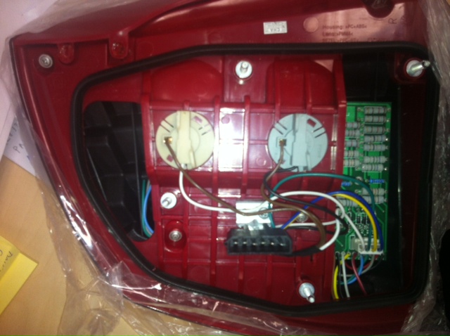

Thank you Xpower for sharing, I purchased the same LED tail light for my octaviaII and I've received them today, I've noticed that the turn signal and the reverse lights are normal not LED also I've noticed a lot of small resistors color coded already installed from factory, do I still need to install the resistors can you please post a photo for the back of the tail light showing the wiring connection as I am not sure where to terminate the wires.
The diagram as requested:
You will need to attach the wire marked 'X' to either the empty slot via a repair wire, or just connect it to the wire on the LED tail light which lines up with the missing empty slot on the cars harness. This is to get the side LED's working.
This is for the L/H light, there is 1 different colour on the R/H light but the positioning is the same.
Good luck

So, having been followed by a friend he said he could barely see the difference between the tail light brightness and the brake light brightness. I have always thought this but didn't realise it was that bad, so I have since made a little modification to my LED lights.
I have now disabled the top row of the LED's in 'side light' mode but still allowed them to operate in 'brake light' mode. This means there is now a separate light for the brake lights and they are now clearly visible (he has followed me since and said they are absolutely fine now)
Here is the picture and vids of them in operation with the mod - both day and night.

Not really, although the issue isn't the brake light brightness being bright enough, it's the tail lights being to bright.
The issue is caused by either:
1. As my CCM isn't coded for LED rears it isn't PWM'ing the voltage enough to dim the side light brightness
2. The LED's on the board don't have quite the right resistors to reduce the voltage.
either way this nice little mod is easy to do and sorts the "issue" out :-)
